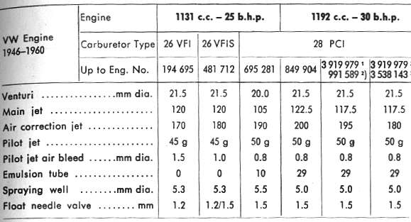

I was curious if anyone knows where to find a manual and specs for a 28 PCI carb? It is the manual choke version of the 28 PICT.

The letter "T" in PICT is for Thermo-electric Choke.
Beyond that, The 28PCI is a much different carburetor than the 28PICT. It was designed around having a manually operated choke cable going the dashboard. It also mated up with the distributor vacuum advance differently physically and functionally and was not used on the 40HP engine, just the 36HP (30bhp) engine.

Here you go:
http://oacdp.org/pdfs/solex.pdf
Samba link:
https://www.thesamba.com/vw/archives/manuals/solex_carb/Solex_Carburetors.pdf
Also:
https://www.thesamba.com/vw/archives/manuals/carburetors.php
