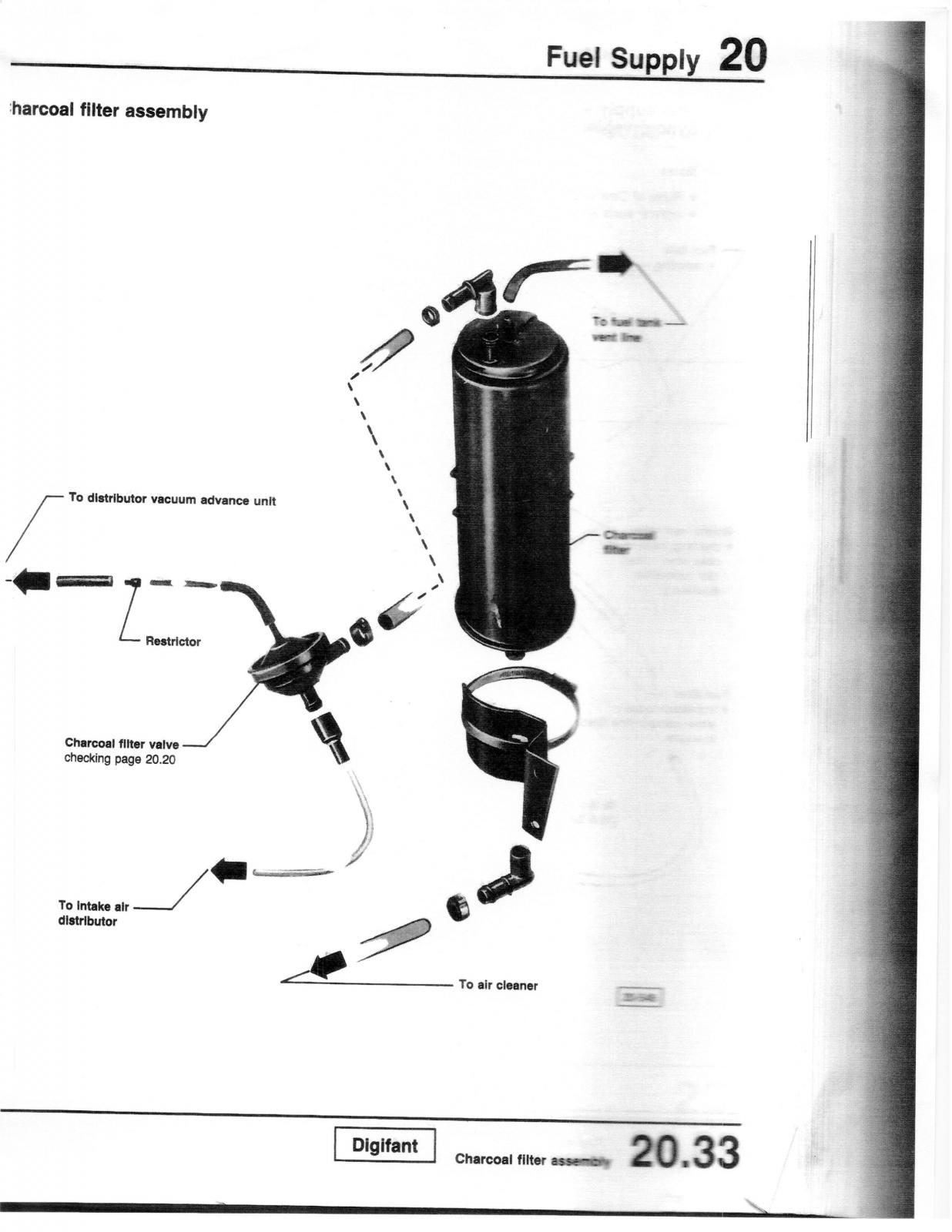

If you have a charcoal canister, that hose routing looks like this:
The hose coming out of the bottom of the canister is just tucked into the vehicle frame rail (even though it is labeled "to air cleaner") . A properly vented Syncro fuel system should not have any pressure in the fuel system, the bottom of the canister should be open to the atmosphere. You could work your way back through the system to try and find any "blockage".
