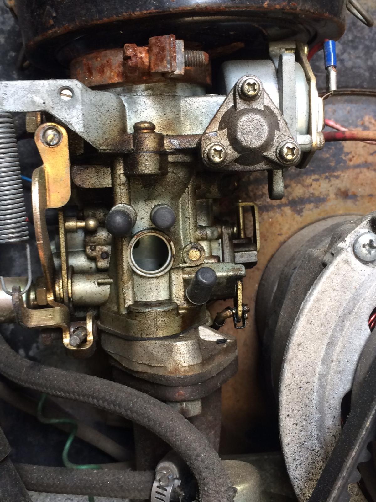

Is the throttle sticking open at start up along w/the choke being engaged? Is the accelerator pump cam scraping the alternator housing, possibly causing the throttle to stay open if you're pumping the gas at start up? How about a picture
or video of the carb at start up during one of these high-rev episodes?
You might keep it all together in a single thread too, I see 3 threads from you on your carb/start-up issues.
