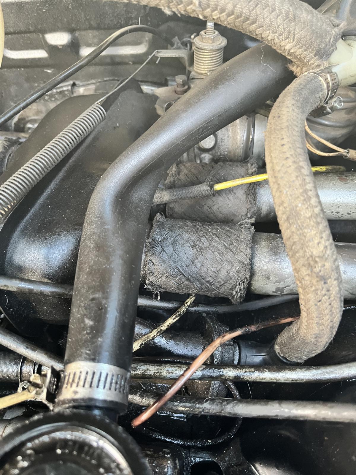

How about a few pictures of your engine compartment showing the vacuum hoses clearly.

PostPosted: Tue Nov 28, 2023 5:23 pm    Post subject: Re: Non-stop oil leak Reply with quote
quote="Wildthings"]How about a few pictures of your engine compartment showing the vacuum hoses clearly.[/quote]

I had the very same issue with an incorrect dipstick tube, bought used when ours had a crack, and the vendor was a good guy and probably just didn’t know. Are the 1.9 and 2.1 tubes and sticks, and/or air-cooled tubes and sticks different, who knows…
That tube was somehow too long, so when reading full it was at least a half-notch above full, clogging a crankcase vent and blowing out huge, blue clouds when throttling after long downhills off-throttle — meaning, with high vacuum — through I suspect that blowby was a likely factor, too, in having a long time to vacuum up minimal oil that became maximal after ten minutes of vacuum.
We did have a small leak before changing the crankcase vent, and the leak completely stopped after the swap. On our current van, we had a much larger, bewildering leak last month that has (mostly or completely) stopped after removing the new-style vent and cleaning and swapping back to an original vent, and even removing the tattered diaphragm I aided in its destruction (wrong solvent).
I know you said your vent is clean but whether it’s working correctly or not is a topic I’ve yet to find resolution on. What I can say is to seal the bottom of the removed tower — I just used the palm of a hand — then suck and blow on the outlet. You should hear the valve opening and closing. In our recent case, the new-style tower went silent whereas in the old one the valve was working.
90 psi *is* low, and on #3 probably the most common, but in this case a leakdown test would be more telling. On our second van, we had a cylinder at 35% leakdown from purchase that went happily along for about 35,000 miles, before, I believe, an unrelated failure forced an engine swap.
So far as the hose from vent to intake sucking in, that may be a big clue but little idea why, beyond excess vacuum outside of my personal experiences — or it was a crappy or used-up hose to begin with. We have the silicone-wrapped style and it’d take a lot to collapse it.
There’s little doubt in my mind that too much oil adds to crankcase pressure, as does a clogged or dysfunctional vent. The new, non-original vents have no vent hole at all, which begs the question of exactly, precisely why it doesn’t and why the originals did — beyond equalizing atmospheric pressure for the diaphragm. I drilled a same-sized hole in the new vents matching the stock one anyway.
There’s a massive thread on this tower that for me answered nothing. A former engine builder wasn’t even quite sure how the heck it worked.
If in a position to easily change the ring, or them all, you might want to. But I’m not convinced you might not have another stupid-simple issue that’ll still cause leaks.
Sorry to run long, just trying to address details and hope they help.
This seems like what I’m dealing with. This leak has been an issue for a decade and has gradually gotten worse. Do you know what the proper dipstick measures at?
