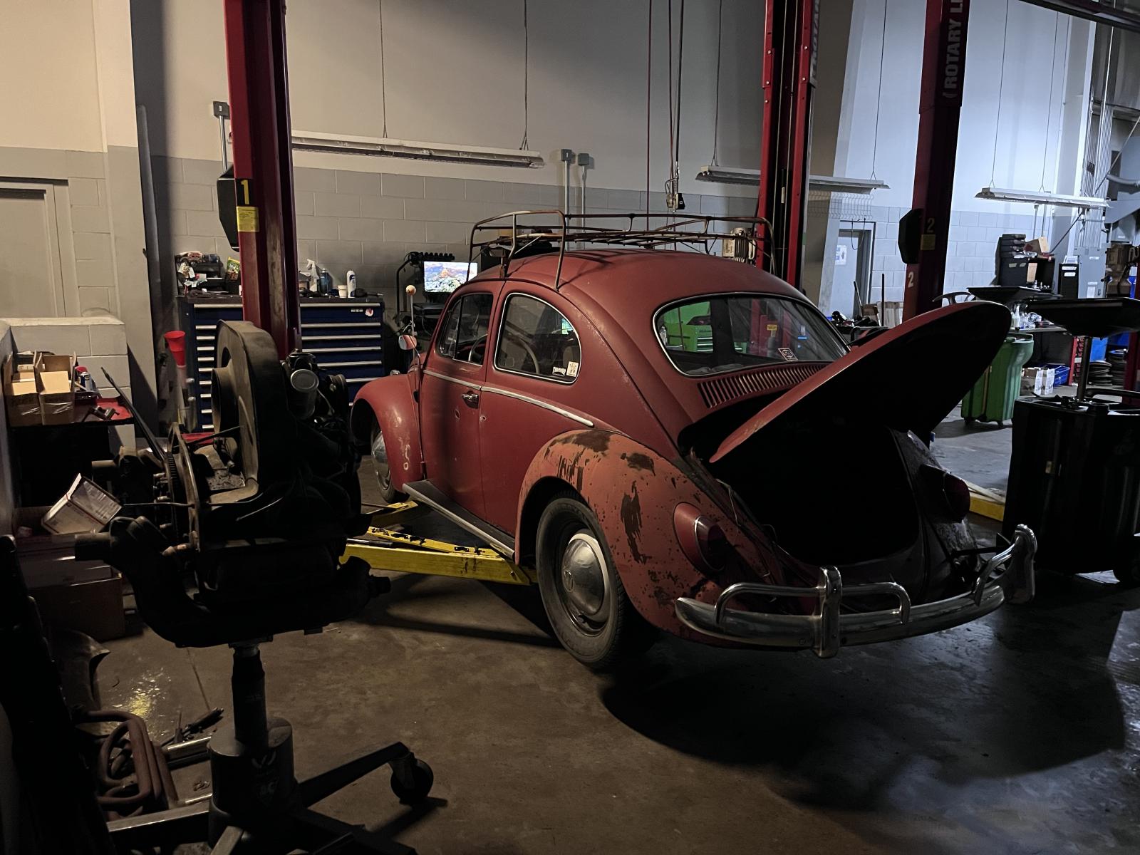

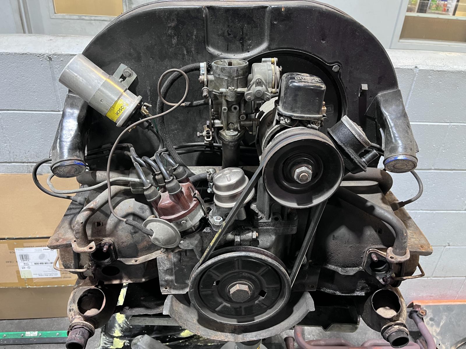

I've never had a thread on old red so I might as well make this one the old red thread.
This is old red, it's a rusty 62 I bought from a friend in about 2016. I fixed a whole bunch of crap on it, drove it around for a while then sold it to a friend in FL after buying my 912. After I got my 912 back on the road and a year or so later my single cab sorted I wanted old red back so I bought it back. It
sat for a while so needed all the usual stuff, brakes, brake lines, fuel tank, carb cleaned etc. When I got it I put a used shockless 6 in narrowed beam and basically set it as low as I could stand to drive it but since buying it back I raised the front and re-indexed the rear and added some poly bump stops. It now clears most things laying in the road and actually rides pretty nice. Yeah I know it's not for everyone.
Here is old red when I removed the 40hp for the generator and doghouse swap
Here is old reds engine prior to the work that apparently messed up the fine balance of grease, filth and who knows how old random parts that made it run so well, I guess.
This is old red at work, taking us to the beach and back. Right after I took the second photo I drove through a flooded section downtown and salt water came in through the holes in the floor pans but promptly drained back out of the same holes. I've counted 7 pieces of pan sections that comprise old reds current floor pans.
