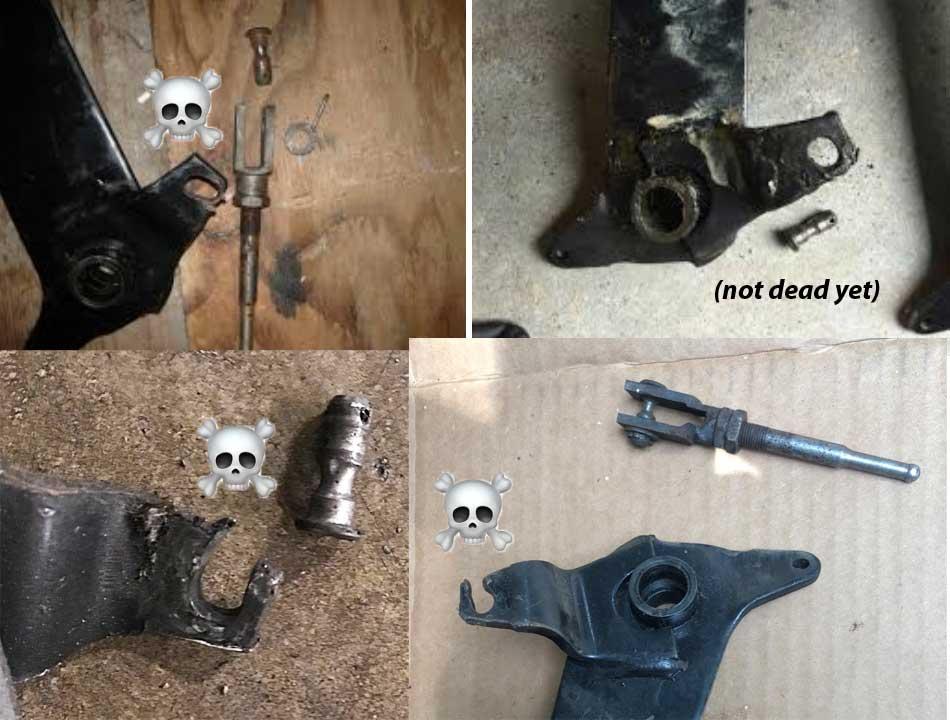

I just went thru a pedal cluster for a member here
basically, 100 year old grease could be the issue.
but the pin everyone says should "slide right out" didn't
what was wild was in the bronze bushings was basically 'metal dust' and it needed to get cleaned out and lubed up...you can see the blackish grey smudges in the bushing
this was 1/2 way thru cleaning it out. you can see it's turning 'gold' again
any of what I posed may or may not be your issue. is your return spring broken?
Either way, not a bad idea to just take it out and service it

This! (not my photo)

Wonderful info Skills, Thanks for posting it!
(and for the confirming post above)
I’d wondered about that after posting but have never worked with the parts you’ve detailed.
Now it makes sense and I realize that pedal “spring-back” has nothing to do with the hydraulics. Embarassed
I try to not speculate here, but this time, I did. Apologies to the OP.

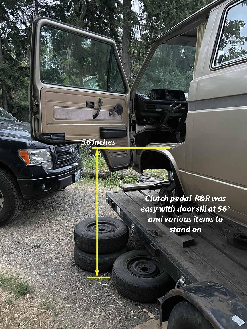

So skills ..... I will speculate that "just" seems valid if the whole dash has been removed for other reasons.
Pedal cluster just hangin' out in front of God & everyone. Shocked
Some members say the dash can be removed in a few minutes.
Maybe a partial dash removal is valid?
If you have to remove the pedal from below the steering column.... this task can be daunting.
It's not so bad the 2nd or 3rd time you do it.
But the first time...... daunting.
My first time was a knock-down-drag-out-fight.
The gravel-scuffle looks like Captain Kirk had a giant alien monster in his signature choke-hold. (for you old farts).
The 2nd time it took something like 1/2 hour, but I had the van much higher and I knew a few things about the job.
The main problem is visibility. You can't see what you're doing.
See this thread - it's 10 pages and has lots of success & horror stories.Clutch pedal replacement in 1/2 hour! (Pics)
Some highlights are
1) raise the front of the van so its easier to work under the steering column
2) Alaskadan chamfered the pedal bore - its easier to "feel the condition" where the pin is ready to slide into the bore.
3) cut off the un-used arm for easier re-assembly (looks like a leftover from a cable-pull pedal)
Some stuff near this post on page 6 https://www.thesamba.com/vw/forum/viewtopic.php?p=9895096#9895096
I have talked to other pro mechanics who say they remove the speedometer, disconnect all the brake and clutch hydraulics, unbolt the pedal cluster and pull the whole pedal cluster out thru the speedo area.
Sounds pretty straightforward, but lots of work that way too.
