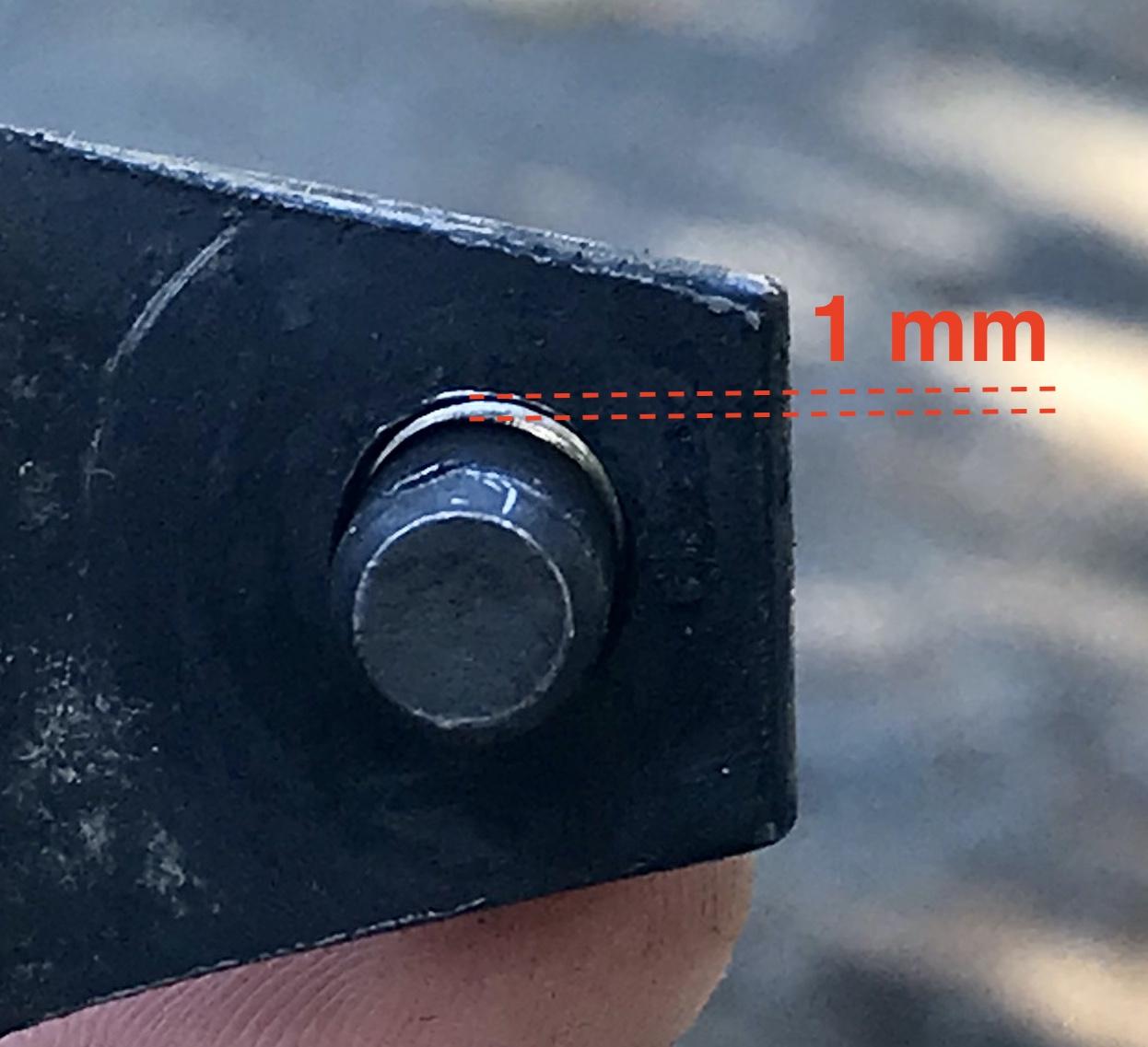

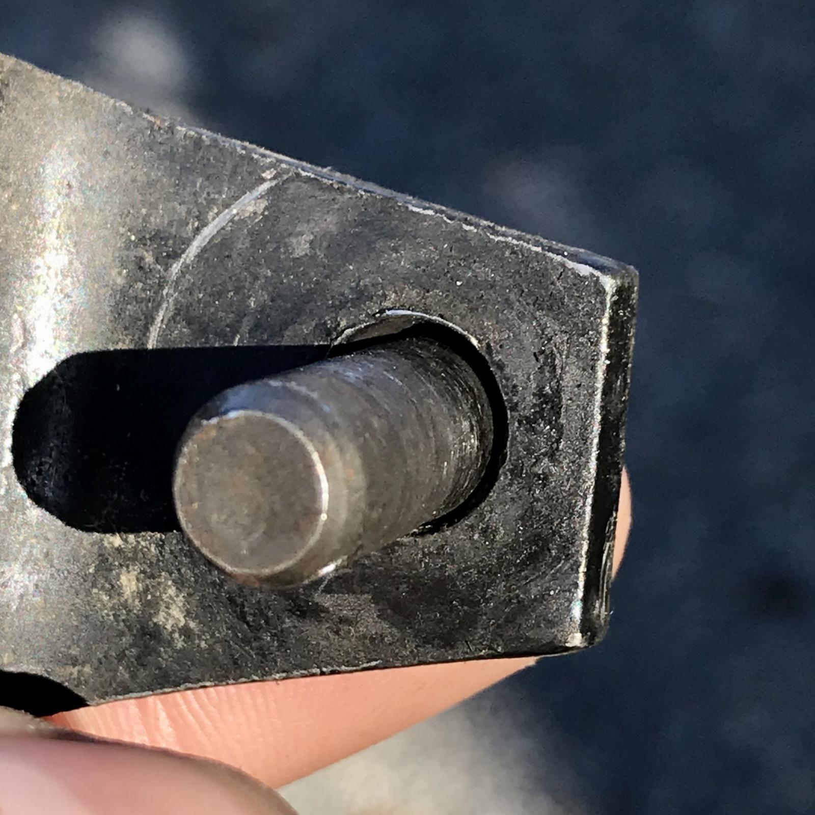

Dang I wish I had read through this entire thread before getting my hands all bloodied! Once I saw the first post saying "you can remove the clutch pedal without taking the dash out," I found the first instructions and ran with it. If it serves anyone tackling this, make sure you browse through this thread to find the info that people have gathered, don't use JUST the first instructions you find.
Anyhow, there was some play in our pedal (feels like about 1/2" to 3/4" at the pad) and a mechanic told us that it could contribute to some grinding in our newly rebuilt syncro transaxle (which has happened a couple times, especially in second gear). He mentioned that our clutch might not disengage fully, creating potential issues.
I got the pedal out and can still count to 10 (the sheet metal in there is not always forgiving when your prybar/screwdriver slips and your thumb drags along the rough edges... gloves darn it!). The hole doesn't seem that bad actually, neither does the pin though the hole is definitely slightly oval and the pin is also a wee bit grooved. I have replacement parts on order from Van Cafe. I bought the bushing solution.
I wonder if I even need to weld the hole shut, or if I could just drill the whole bigger to fit the bushing, any suggestion?
I'm pretty sure that if I just drill this bigger for the bushing, the hole will be centered in the oval shape and not the original location. Given the geometry, I imagine it means that the clutch pedal pad might sit about 1/2" higher than stock, meaning I could have a 1/2" more of travel. Our clutch pedal has always stopped on the van's floor, I wouldn't want to be able to push the clutch in so far that I slowly damage the master cylinder.
One thing I did notice, is that the piece that pushes into the clutch master cylinder was bent. I have no clue how that happened (I certainly didn't force anything to the point that the pin would bend). I'll have to straighten that.
On the plus part, I finally found why our horn hasn't been working. It had nothing to do with the horn itself nor the contact ring after all. It looks like the ground wire terminal at the bottom of the steering column had just disintegrated and was flopping around. Silver-lining to contorting yourself and having your face smashed into the pedals I guess!

You did not show a pic of the pin, was it worn?
You don't have to do anything to that clutch pedal hole, it's perfect.
Bend that rod back to straight, grease the clevis and re-assemble.
Should be good for another 30 years....
The pin is slightly worn. I measured it at about 7.6mm in diameter. The hole is 8.6mm on the longest side so there's about 1mm of play. It's not nearly as bad as the other photos shared here, but might as well fix it right while it's out.
I'll definitely grease everything per your recommendations!

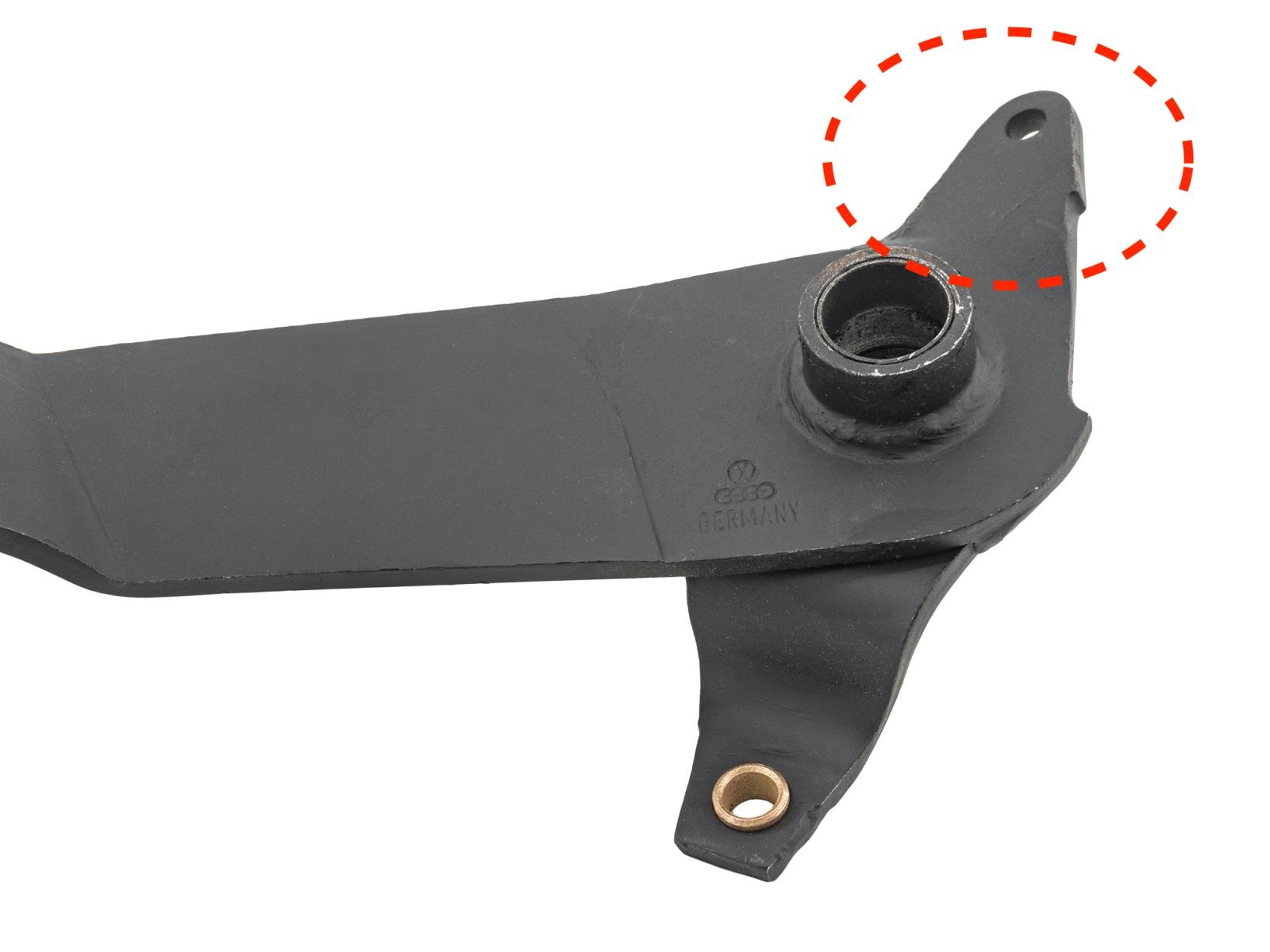

Cut that un-used tab off the other side and it will be easier to reassemble.
I wonder what that tab is for?
Are you talking about this tab? Opposite of where the pin slides?
I guess it definitely isn't connected to anything, maybe that pedal just fits in different vehicles.

I see you have an adapter plate, so some of this pic doesn't apply to your van
But the pic shows cutting off that un-used appendage that makes it much more difficult to reassemble.
This pic is from a thread about removing the pedal to modify the leverage ratio to match a Golf slave cylinder that's used in the Smallcar bellhousing.
So you will be ready for "van season 2020"?
I'm working hard too.
I won't get any of the aesthetics done, but I've been under the van for a week now. Wink
Tomorrow it comes down off the ramps and I get up on the roof for #vanlife poses (working on 'solar' next).
I'm not sure which adapter plate you're talking about. That photo showing the tab is just a stock GoWesty clutch pedal photo.

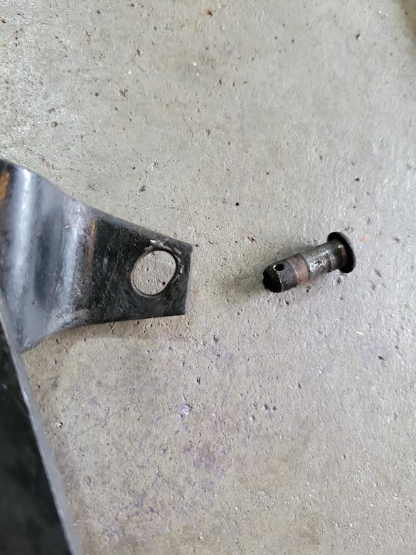

If you can get some help from someone who understands this pic, and has small hands....its more likely.
I tested this finger-packing pivot lube method ”on the bench” with an extracted clutch/brake pedal cluster. Packing the clevis with grease then wiggling it appeared to suck the grease into the clevis joint. I took a video but YouTube hates me so can’t post it easily. Anyway it seems possible to get grease in there without removing the clutch pedal.

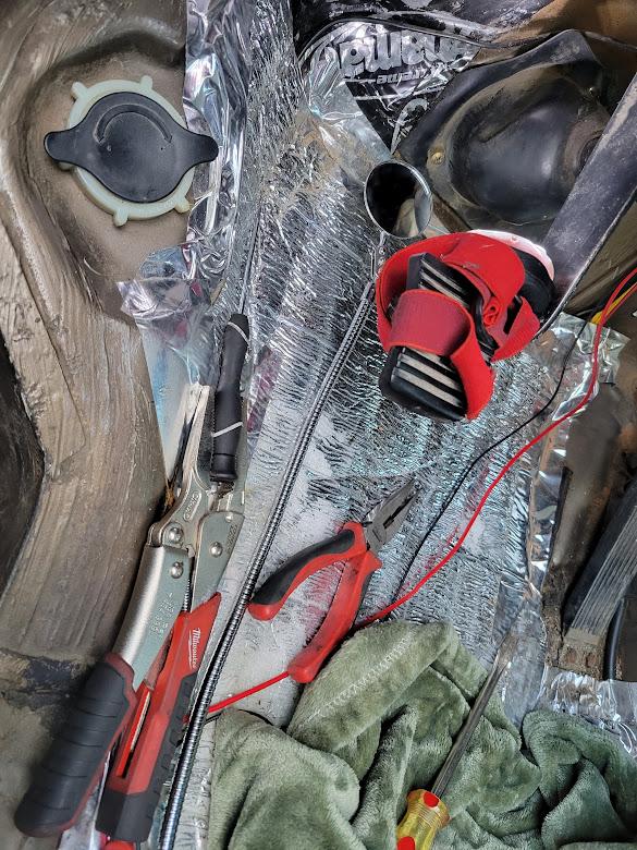

My clutch pedal has started making an awful buzzing, vibrating noise from time to time. I reached up in there and could feel the looseness of the pin. Looks like I'm doing this procedure soon.
Figured I'd bring it back to the top for any recent updates to the process.

Pull up/down on your clutch pedal and measure.
How much slop?
Would be useful to have "a GO / NOGO clutch pedal slop measurement" for Vanagon science.
I'm pretty sure one inch is "fix it NOW".

PostPosted: Thu Aug 25, 2022 6:26 pm    Post subject: Re: Clutch pedal replacement in 1/2 hour! (Pics) Reply with quote
Wow, that's a crazy job. I put it off for a year but the constant rattle/vibration was driving me nuts.
Buslab has rebuilt clutch pedals in stock; I bit the bullet last week. The core charge is steep but for convenience sake, I'll take it.
https://www.buslab.com/product-p/251721315ax.htm
(Also, their shipping is lightning fast. And, I was having trouble on their site, sent a message, and they called me to see how they could help. Shocked GREAT vendor.)
After a bad day at work yesterday, I thought I'd make the day worse and get into this project. I got all set up, removed the seat, and laid down an old floor mat.
...which was then covered with a luxurious green velvet blanket, usually reserved for saving seats at Red Rocks. I discovered that the hippie foot smell never truly leaves velvet.
Removed the clutch spring, stared up in there, grabbed a pile of tools, tried a mirror, then convinced myself that it was impossible.
After another awful day at work today, I was back at it. Misery loves misery.
But I quickly realized that my problem last night was an unwillingness to sacrifice the body. You really have to get in there and get twisted up, with reckless abandon.
Is it weird that I'm disappointed that it wasn't worse? It sure felt worse.

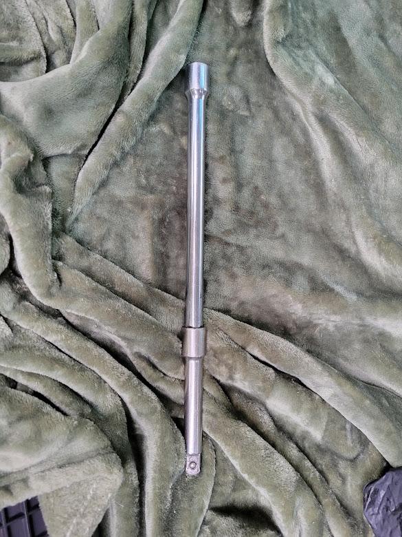

I wrestled some with getting the big pin back through the clutch pedal. This big ratchet extension...I got it up there and aligned on the brake end, pushed it once, and it all slid into place.
I tried the powerful magnet/screwdriver trick for the ring, but I kept hitting the metal of the van and screwing it up. Tape ended up working fine.
All buttoned up in just under two hours. Unbelievable! And what a difference in clutch action.
Thanks to the trailblazers in this thread. And thanks to my dainty, slender hands.
Joe T.
'02 Baja-ish Beetle "Bubbles"

PostPosted: Fri Aug 26, 2022 1:53 pm    Post subject: Re: Clutch pedal replacement in 1/2 hour! (Pics) Reply with quote
Joetiger, curious you mentioned what a difference it makes....My van has a fresh transmission, clutch, clutch slave, shifter bushings basically everything has been rebuilt. I've adjusted the shift rod multiple times but the van is still vague and spongy. If I tap on my clutch pedal with one finger it will dance up and down has a lot of play. Did you have similar clutch pedal travel and did it improve shifting feel? Mine engages on floor too, I'm guessing I need to bite the bullet and just do this job.
joetiger Premium Member
Joined: January 27, 2005
Posts: 5257
Location: denver
joetiger is offline
PostPosted: Fri Aug 26, 2022 2:15 pm    Post subject: Re: Clutch pedal replacement in 1/2 hour! (Pics) Reply with quote
remraf wrote:
Mine engaged at the floor and I had about an inch of play at the top. I also had a buzzing noise at idle most of the time which sounded like a loose screw vibrating on sheet metal, and squeaking noises always.
I didn't think the damage to the pedal hole was very bad, but when combined with a worn pin it seems to translate exponentially to clutch feel. The difference is very noticeable.
Driving it now, it has about 1/8th inch of play at the top, engages higher up, and gear selection is smoother. It's definitely worth doing it.
Joe T.
