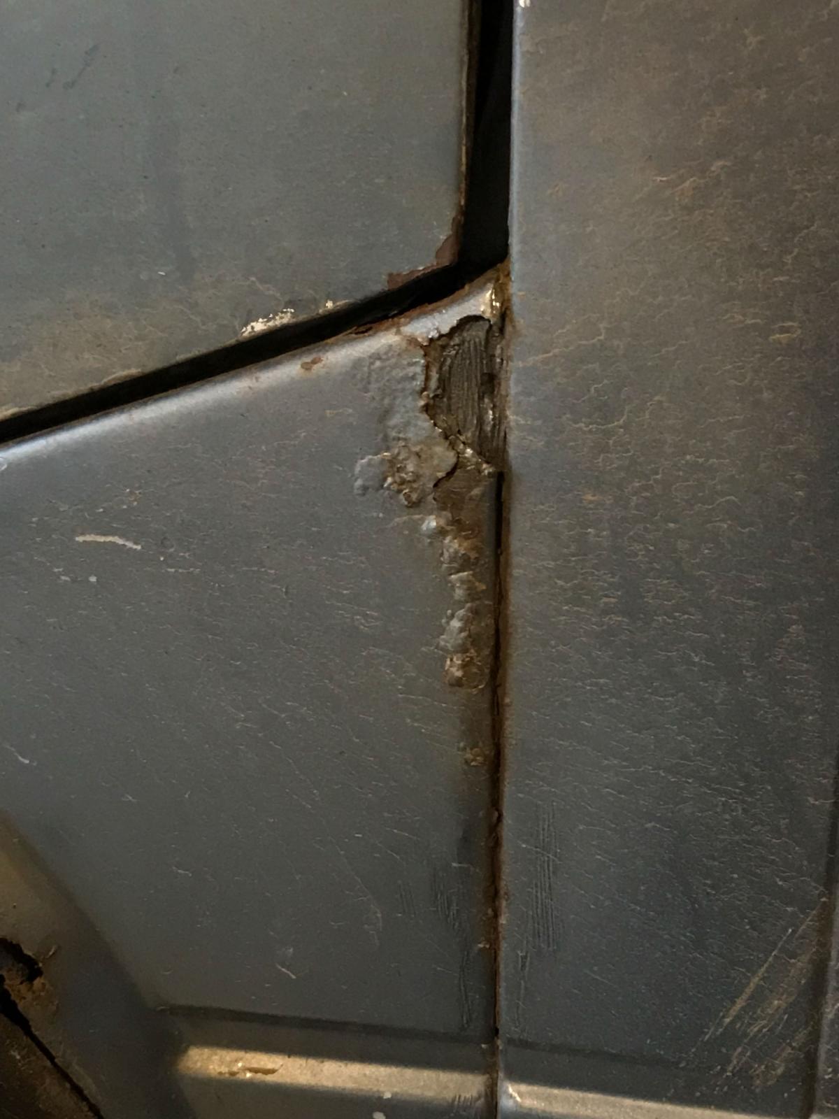

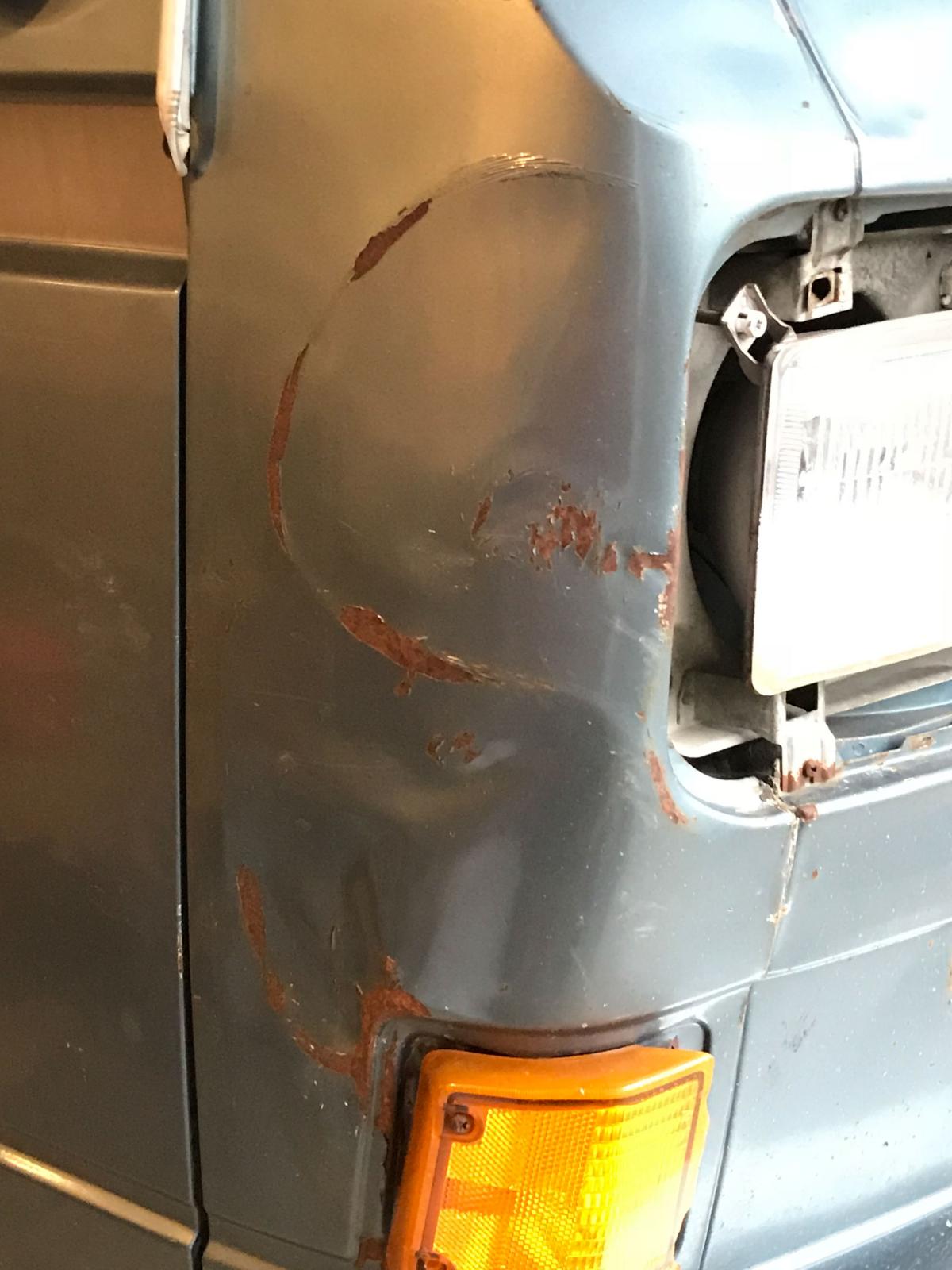

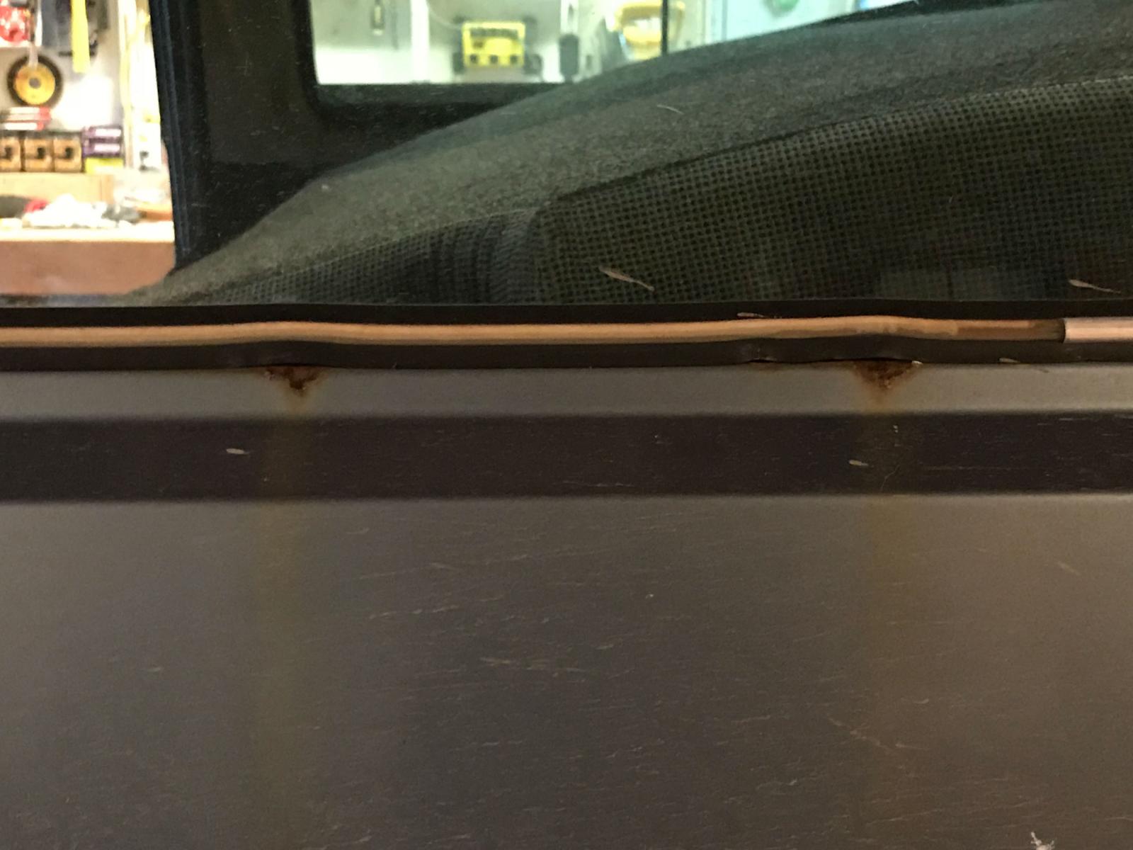

We purchased a 1987 Vanagon Syncro with almost 300,000 miles on it. The previous owner added a tent-top to it and it already had a running 2.2 conversion in it that needed TLC, and there definitely was some rust. The interior only has the standard folding bench, nothing else. We want to make it into a camper.
Our goal was to rebuild the engine, strip the van down completely and rebuild the interior with our own design. This is to be our forever-van so before we start rebuilding the inside, we'd want to make sure it's both mechanically sound and mostly rust free!
We've been pretty excited about it all and just swapped our failing 2.2 with a different rebuilt 2.2. So far so good.
The bodywork though seems to be a little more involved than we originally hoped for (see attached photos, the footwell is the worst by far, but there are little signs of rust everywhere). I thought I'd be able to learn how to do some of the work but am realizing that I might've bitten too much. I just got off the phone with a shop to chat about what it takes to restore rust on a van. From my description, they suggested that it'd be simpler and cheaper to find a Vanagon body out there that wouldn't have rust damage and do a body swap, instead of sandblasting the thing and trying to fix it.
We're feeling a little discouraged. I realize it's a far stretch to ask for pricing but I was hoping I could get the van stripped, blasted and repainted while keeping the cost under $10,000. I'd be willing to strip the darn thing down myself and trailer it to a shop for them to fix.
Is that realistic?
What are your success stories?
Any tips or opinion on how best to deal with rust?
Should we do a full body swap? Should I attempt to fix these things myself? I have no experience and tools to do so, though I am a tinkerer.

I see nothing there warranting a death sentence. Fix it or rock it as is. There is worse out there living the dream daily. Enjoy it!

yeah it'll be fine..
attend to that slider glide and rock it for a couple years..
too
far too many projects die from the initial over enthusiasm of taking it all apart and wanting nothing but the VERY BEST for all the $$ and time and sacrifice..
that far tooo often ends in a "we never planned to sell it but" sacrifice..
rock it for ~2years.. get the mechanicals in rock solid order.. that'll set you back enough thousands..
travel well and enjoy..
the view is the same from the sliding door and windshield regardless of what you PNW's call rust

A lot of work but it doesn’t look that bad. Checkout my rust repair.

A body swap will end up costing you as much or more than repairing some rust and the new body may have rust also unless you're real lucky to find a gem.
Really need to see many more photos to give a good idea if that body is toast.
Take the van to as many different body shops as possible. Make sure they know that there are many new panels available for Vanagons and get some estimates.
Letting a shop see the van in person will give them a better idea.
Stripping the van down yourself will always save you money. Make sure you take plenty of pictures and bag/tag everything. In fact if can strip it first before taking it for estimates will give the body shops an even better idea of the work.
Repairing it yourself is always an option, can you weld?
I'm all for saving our vans and understand the desire to have a nice looking rig, what's even more important is knowing that it's not rotting away!

Fix it - Absolutely. No question.

"Body swap" is going to be harder and more expensive than fixing what you have.
There are things you can do to mitigate the rust issues you have now (greatly slow its spreading) without spending a lot of time or $$$ immediately. Then you can focus on the mechanicals and enjoying it in the near term.
Then you can shop around for the body work in a leisurely way, or research/learn more to do some of it yourself.

Yeah I had all of that and then some when I started. Pretty much the bottom 7 inches is from a donor. To me a nice thing about a van that's been cut up a bit is I know its never going to be that unmolested survivor that you might be apprehensive of thrashing a little now and then. You should fix it.. Oh and and a couple more places to look for rust, the front frame rails, right above the rearward front cradle mount. It's a total dirt/moisture trap and you have to look on both sides of each rail. There may be a bulge or a hole or if not guaranteed its full of crud. The cross member that the front of the trans bolts to will be full too. Have fun. Smile

If your Syncro is "original" there are plenty of good reasons to get that rust fixed. There are tons of available metal repairs for everything your pix show.
One thing you got to get straight right away: Vanagons rust from the inside out (mostly) at the seams. If your chosen shop doesn't know how to deal with that, you'll have rust back in the seams in no time flat. Plenty of threads here on what it takes, search for seam rust.
Next up... A Miller MIG welder on CL would hold its resale value pretty well, and learning to weld is nearly as easy as the youtube makes it seem. Invest in yourself! Go to a scrap yard and buy a dented car door or such like $5, learn how to cut and fit bits back together, learn how to use a grinder, and which kinds of grinders do what. A few decent tools, and a little time is worth it. Does it have to be "done well" by someone else, or maybe you did it yourself and its not perfect, but you are proud and its fun. I have seen plenty of okay'ish body-hammer/dolly sets for super super low $'s, and that same car door you got to learn cutting and welding will help you learn a little dent and ding repair. Forever is a long time, but even a shop you'd pay $10 K wouldn't keep it from starting again eventually. So, you'll be able to use your skills again eventually Smile Before you know it, you'll have confidence enough to just tear into whatever you need to do on your van. The first cut is the hardest.
BTW, just a paint job alone can be $10K
More fun can be had with a roller and a bucket of outdoor metal paint. When another little spot pops up, wire brush it down, roll on more paint.
Even a brush paint job can look pretty good. My dad did his '53 IH pickup with a brush, couldn't tell, and lasted 25+ years, and he's as anti-mechanical re vehicles as I've ever known a person to be.

I would not let a shop touch it for a while. They will charge you a fortune for stuff that you can do anyway.
Read a lot of the restoration topics to get an idea of what to expect.
I'd strip out the interior, attack the seams from the inside and out, neutralize the seam and any other rust, expose any areas that need new metal. Only then take it to a welder with replacement panels in hand and have him only do the welding, nothing else. You can reseal the seams, and do a home paint job on the body work areas. It is not a beauty contest. Just get it mostly rust free and sealed back up. A nice paint job can be done years later....

Alright! Thanks for all the tips and resources, I like them all! And the encouraging comments are reassuring.
It sounds pretty obvious now that the only person excited about the body swap was the car shop.
We're off to Cuba for a couple weeks, I'm sure we'll see a bunch of inspiring restored vehicles which should motivate us to keep going on our van. When we get back, it'll be time to strip it down and see exactly where we stand!
Thanks again!

PostPosted: Thu May 24, 2018 9:57 am    Post subject: Re: 87 Syncro Body Rust: Fix or Body Swap? Reply with quote
Update!
We decided to work with Shane of @LiveTheVanLife and get our van down to Tijuana to have them fix all the rust and repaint the whole thing. We're also getting our interior reupholstered while we're at it. We're also getting a whole set of new seals and the undercarriage lined with truck liner. The stripping has started!
Our van, as shown in the photos has a fair amount of rust. The initial quote for rust repair, windows-off paint inside and out and truck liner from the shop (based on the same photos in the post above) is coming in at $5,000. I'm sure this will change.
Here is the page for his quote request (navigate the website to find more info): http://www.livethevanlife.com/paint-quote.html
You can also read Shane's 5-part article about why his recommended shop in Tijuana is a good idea for Vanagon owners:
Why You Should (or Should Not) Get Your Car Painted in Mexico
danfromsyr
Joined: March 01, 2004
Posts: 15412
Location: Syracuse, NY
danfromsyr is offline
PostPosted: Thu May 24, 2018 10:58 am    Post subject: Re: 87 Syncro Body Rust: Fix or Body Swap? Reply with quote
just be leary of rust repair ala Bondo.. and not being cut out and welded in new steel.
bondo is like frosting on a cake, it's there to smooth over the surface and offer something appealing to the eyes.. but it's not a long term solution and will bleed thru if frosted over rust w/o proper treatment.
Abscate wrote:
MsTaboo Premium Member
Joined: June 02, 2006
Posts: 4634
MsTaboo is offline
PostPosted: Thu May 24, 2018 11:37 am    Post subject: Re: 87 Syncro Body Rust: Fix or Body Swap? Reply with quote
DON"T HAVE THE UNDERSIDE TRUCKLINERED! It will only hide problems down the road and will encourage the shop to cut corners because they know the truck liner will hide crappy work.
Better to have good solid paint and add some wax or oil based coating later.
The heavy coating like from the factory can only be done on really solid/new metal.
