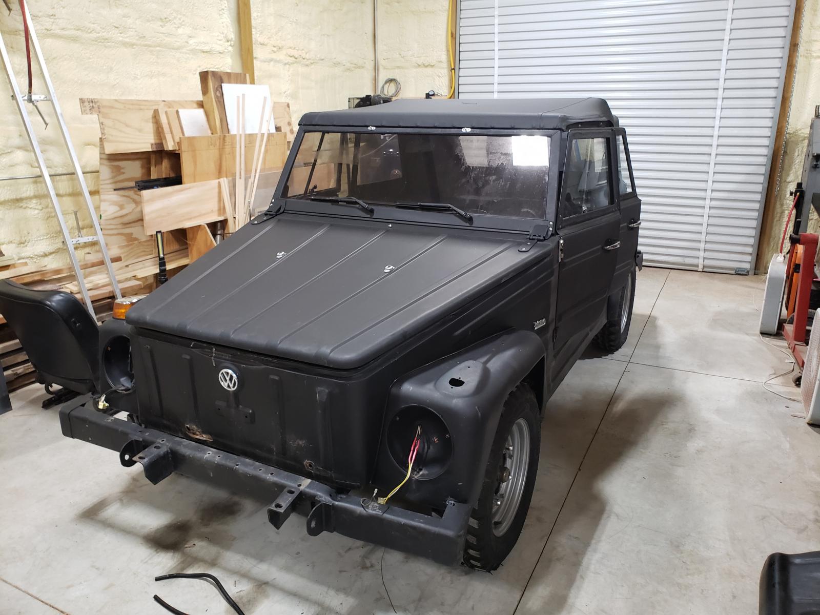

Hi folks. I have been lurking for a while hoping one day I would again own an airculd machine. I started in 1986 with my first car being a 1968 Beetle. Then I got a beat up '69 Baja and I built a pretty nice Franken Bug Baja Prerunner that is still running around Virginia Beach, Virginia.

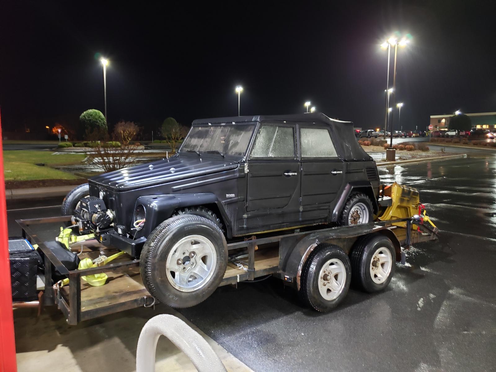

Then a couple months ago, with retirement looming, I scored a 1973 Thing up in North Carolina after months of scouring the classifieds, Facespace and Craigslist for my next project. I have always wanted a 181 and finally! I have one! Well - We have one!
I brought him home in the rain through the mountains of NC with my adoring wife who not only approved the purchase but was excited about it!
We rolled him off the trailer and into the garage.
Made an assessment...
And got to work!
Always some hidden stuff up in there but we are up to the task.
It is possible that this 181 may have been on here before or may be recognized. But there is plenty to do. A little pan/frunk and bumper work and inside body work, pedals and cables, brakes, exhaust and get the seats sorted. The biggest project is the electrical. I have been down that road before on a few old Toyota trucks and Beetles so "I ain't sceered!"
I will try to post here from time to time to keep you all up to date. I am retiring in 86 days so the speed should pick up!
Enjoy!

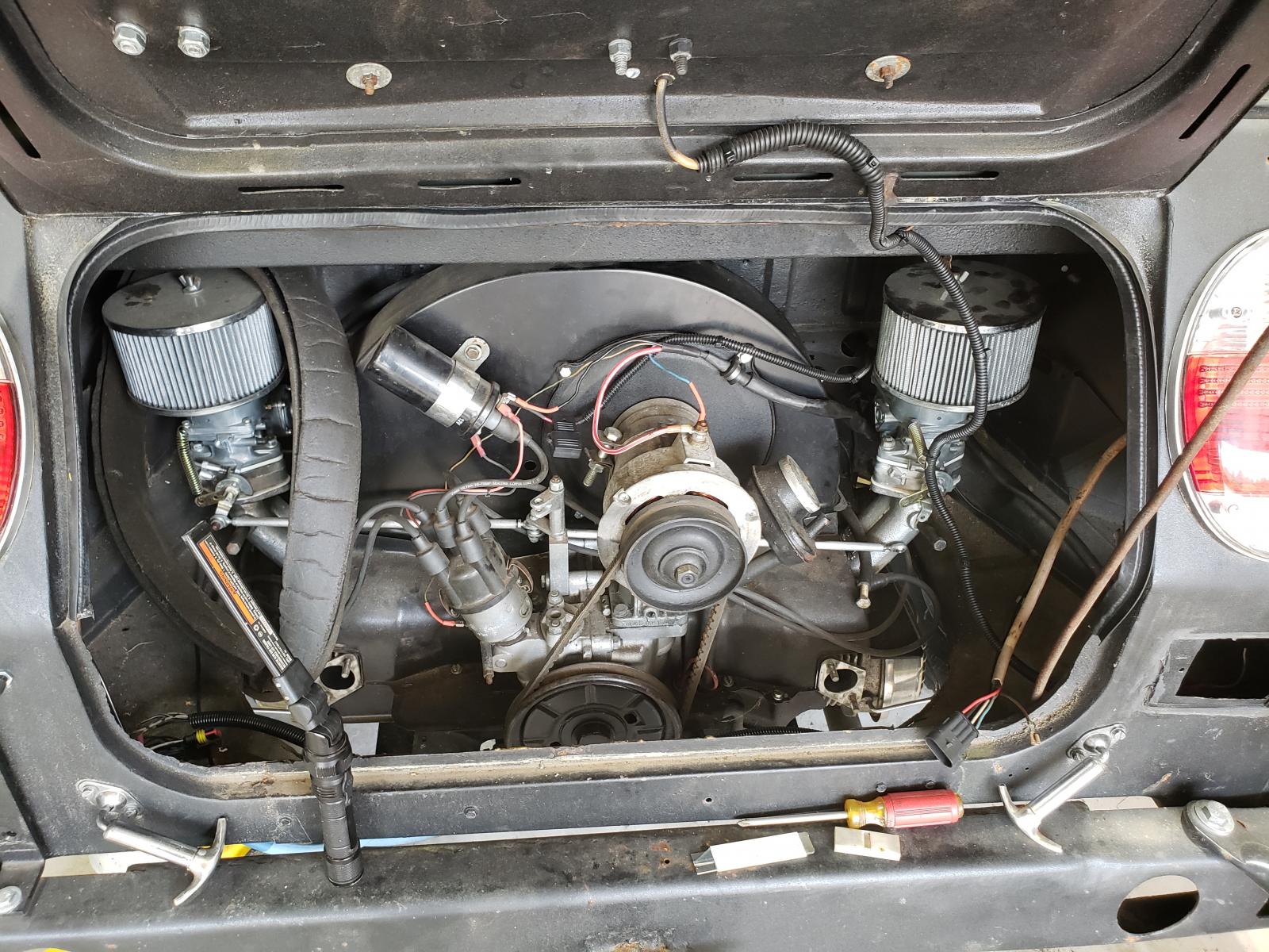

You will all learn I am slow on these projects but I have accrued a pile of parts to throw at the Thing. I retired on June 29 and figured I could thrash on the project and get it going in short order. Not so.

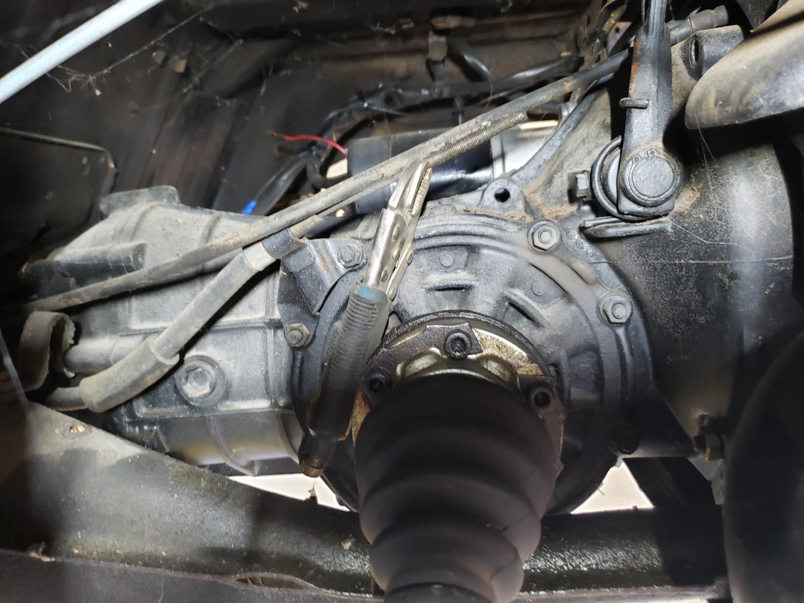

Today I got in a new rag joint (the on in it was bodged).
And discovered that a PO had added a new hard line and it was pinched everywhere. I pulled it.
I am going to replace it with -an fittings and proper line. The original line was broken off in the back below the transmission horn.
(PO left me the visegrips. They came in handy today.)

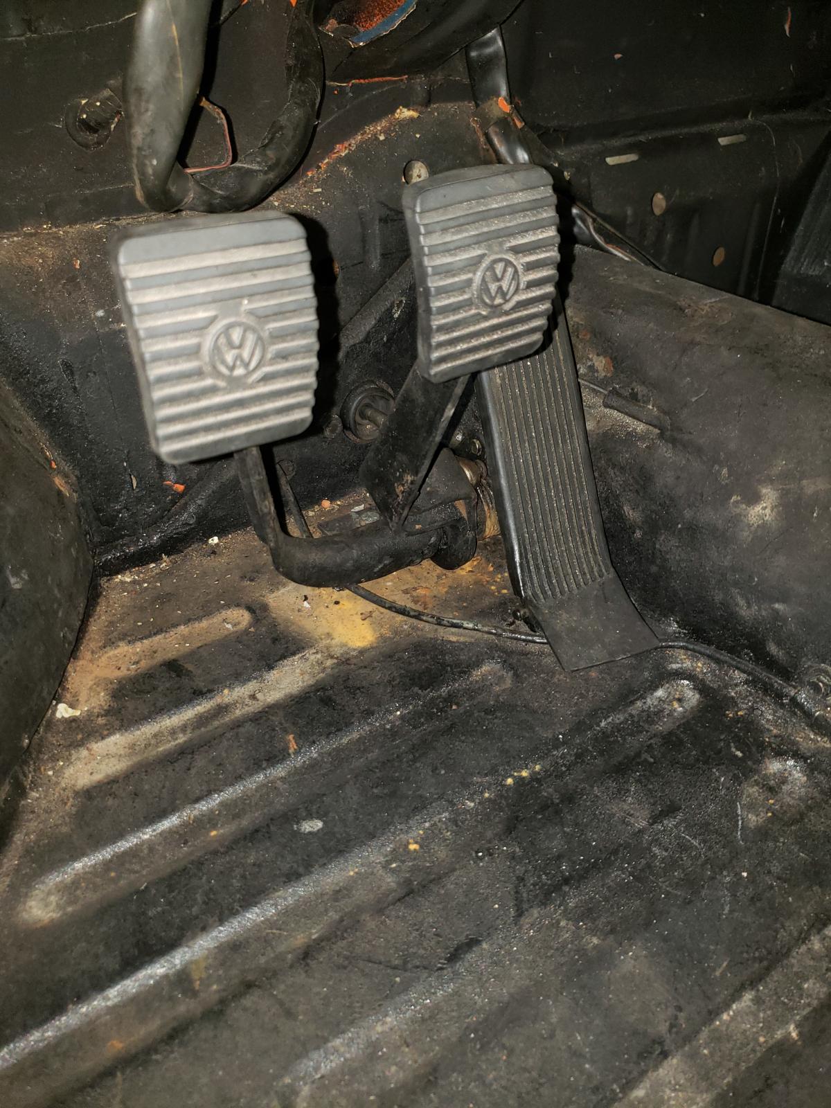

I did get my pedals re-installed. They were laying on the floor when I got this home. The petal stop was merely a piece of angle iron loosely bolted to the floor so I made new one.
I also figured out there master probably was not bench bled so I am doing that tomorrow in situ and then will get everything all hooked back up the the brakes bled. There are a bunch of new lines already.
After that it is all about this mess:
The PO had a bunch of accessories like offroad lights and even a winch on the car. I have pulled all that off and pulled a mile of mystery wire out. He also had tried to move the signal lights to some chineseum headlights with LED signals incorporated in them. I will get rid of that and go back stock.
Stay tuned. Or not. Laughing

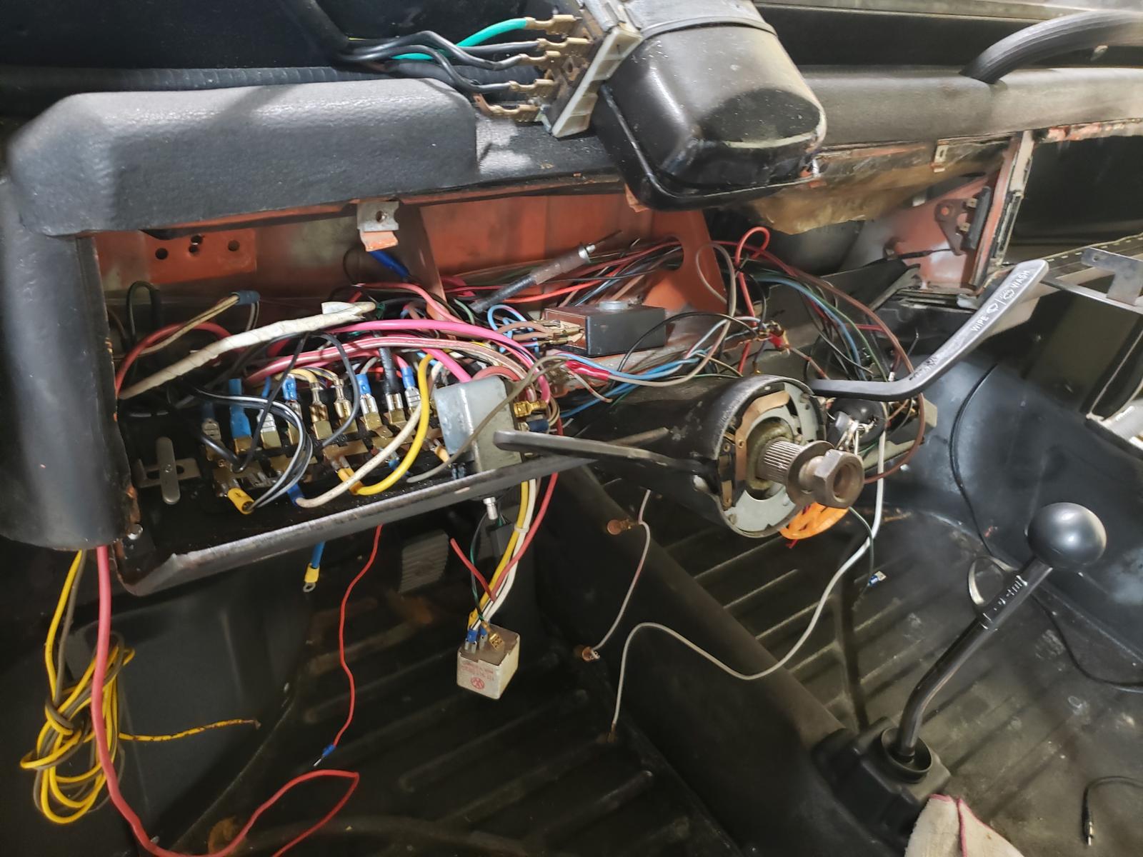

I can't tell from this photo but there should be a jumper wire going across the steering coupler (AKA Rag Joint). This provides a ground path for the horn wire.
Walküre Restoration Thread: https://www.thesamba.com/vw/forum/viewtopic.php?t=737492
There will be. The connection is there on the new joint. It had been "deleted" by the PO. He had tried to install an aftermarket steering wheel which led to an aftermarket horn amd he add a "shim" to the old rag joint. It was a mess. You can see the "engineering " in the top right. Surprised

Well, I found so many janky connections I pulled the main loom and stripped it. Glad I did. There were some soldered and frayed wires. Car never would have run and frustrated me blowing fuses.
So I spent the entire day rebuilding it and it is ready to go back in. So much easier than a post 80s car.
It also allowed me to delete the diagnostic plug.
If anybody is doing a full resto and wants it, lemme know. Shipped free.

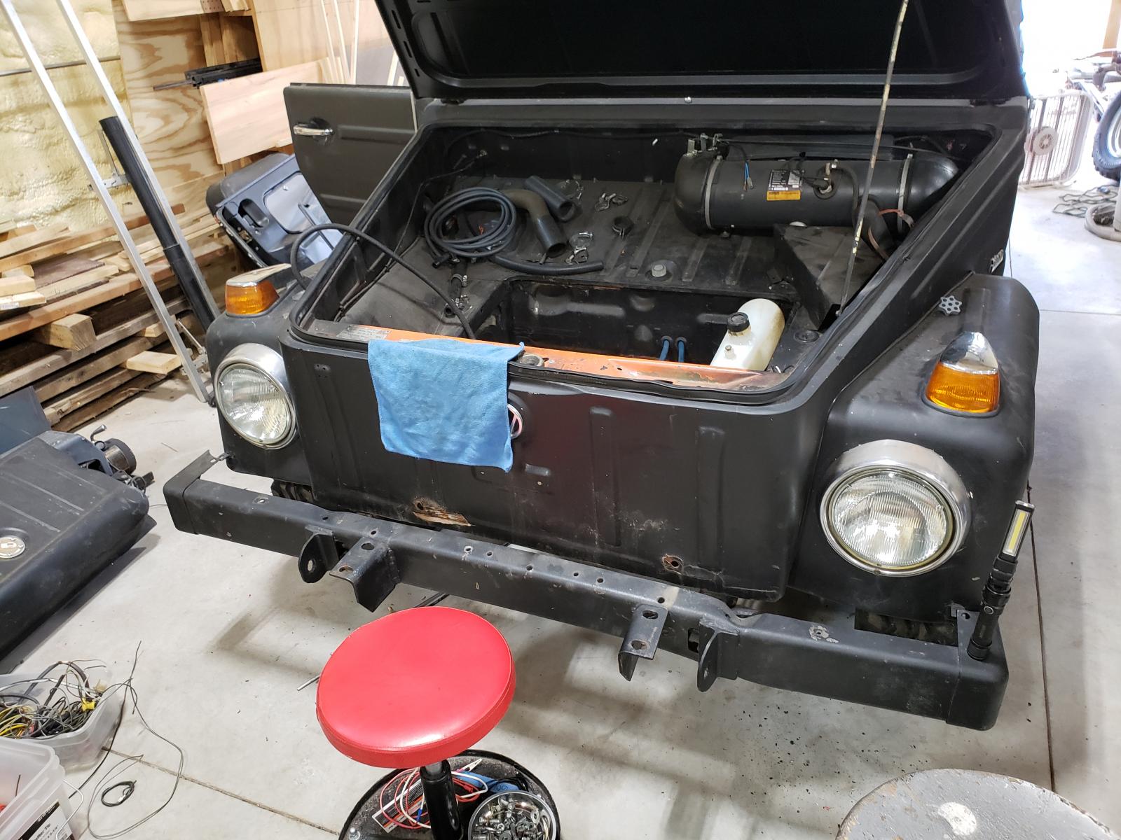

Obviously I ended up starting at the back. Seemed easier and wiser to ensure the harness was where I wanted it.
The Ms. Is going away for a few days so I will keep at it.

As to my wire junction question? Well, they are going to be in the trunk now. I finished everything in the engine bay.
Hit it hard today. I am waiting for some gray 16awg wire to finish off the front marker lights. I will be able to bundle all that up and get the headlights in when that happens.
Then I worked at the dash and ignition. Once again, there was some wonkey stuff in there. There are a couple circuits I am a little confused about based on the wires I have to work with. I may just have to build those from scratch. Anyways, if the 16awg shows tomorrow, I may be able to throw some 'tricity to it! Certainly by Saturday.
