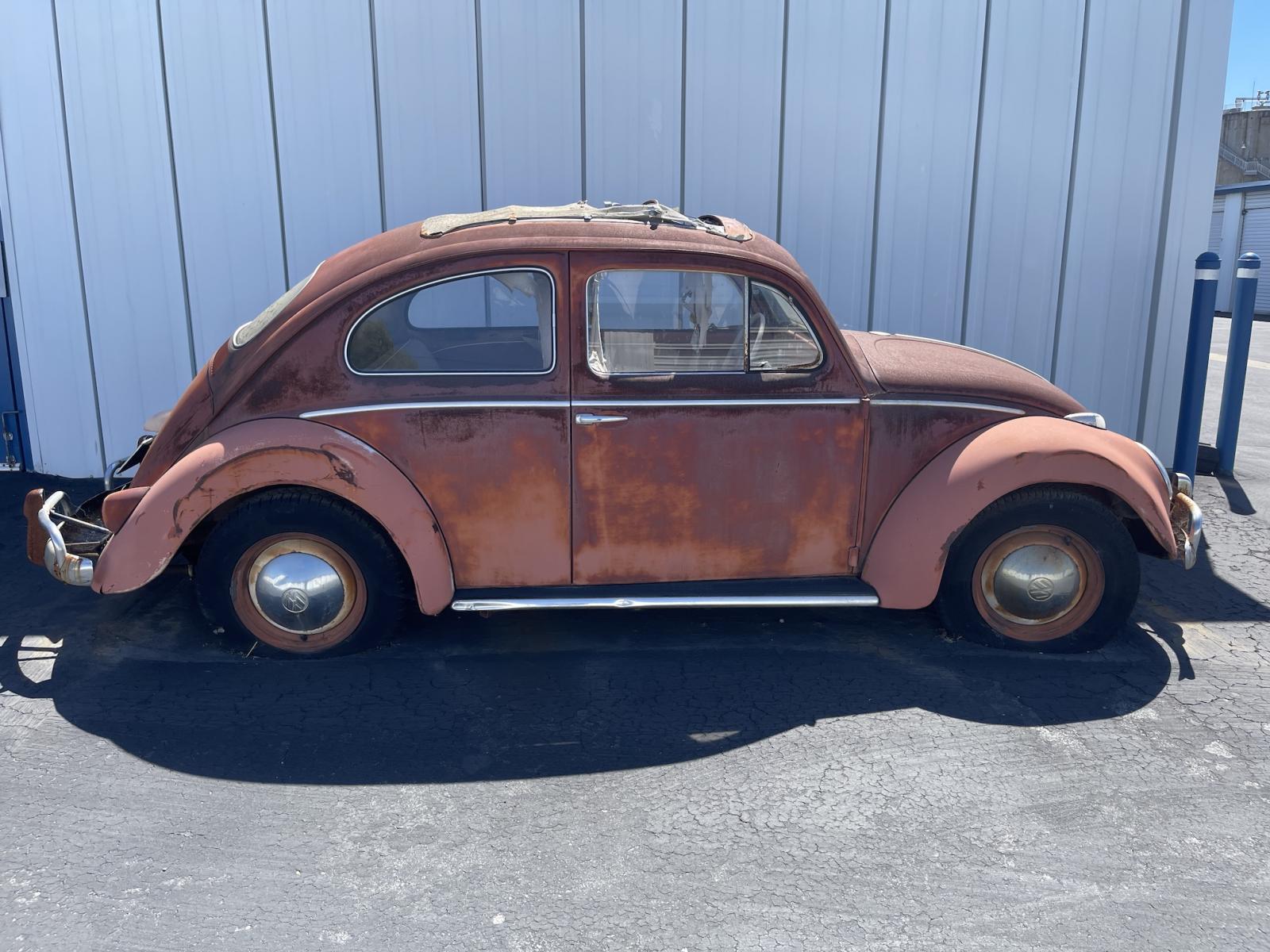

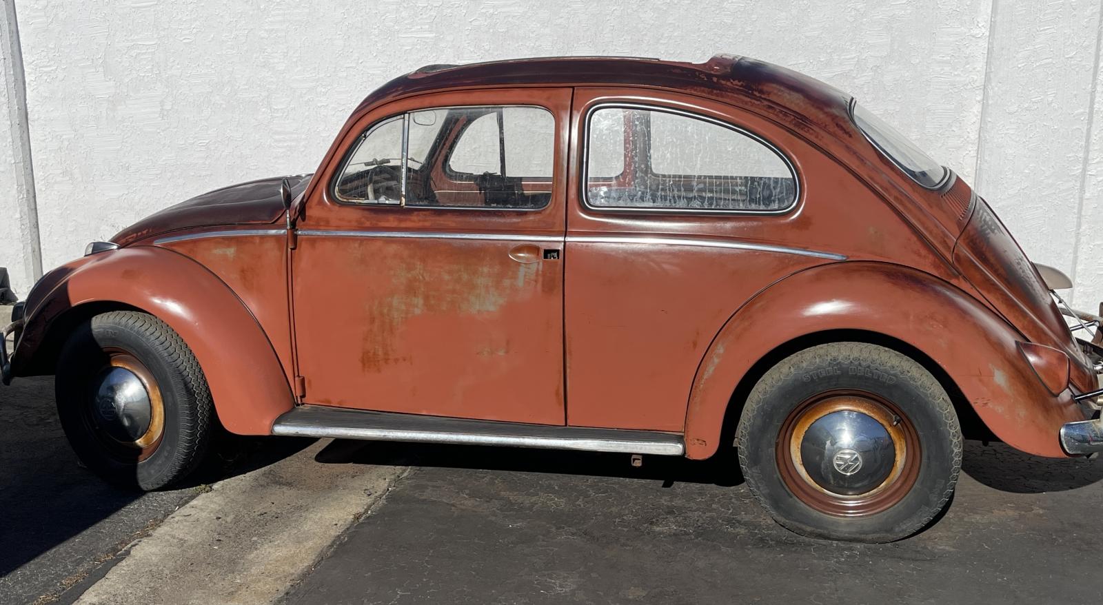

Hey all, just wanted to say hey and how much I appreciate the site with it's huge wealth of info. I'm a first timer at bug ownership and look forward to spending time with it.
Anyways, the car. Its a 1958 ragtop with 39K miles that has spent the past 20 years sitting outside in a storage facility as the original owner (who bought it new) was in a care home until they passed.

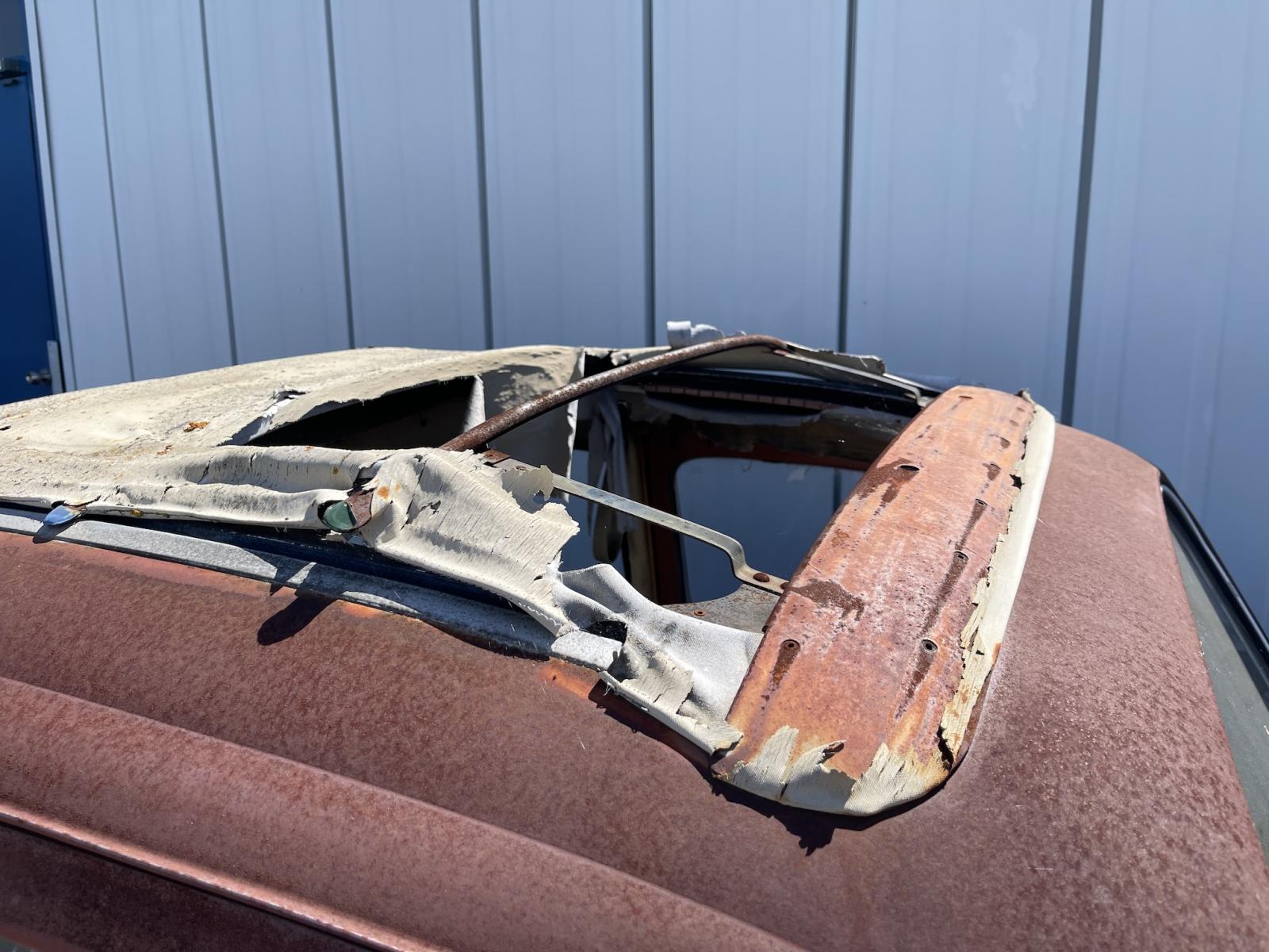

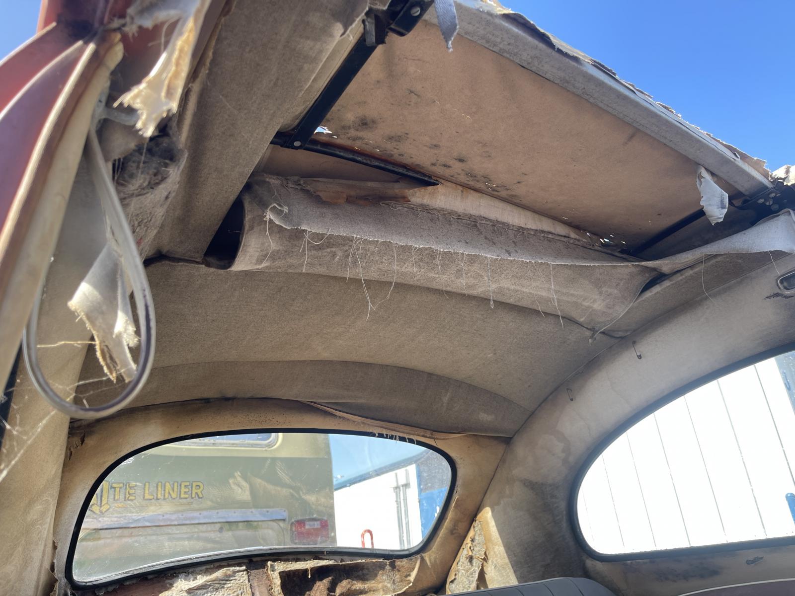

The car had no cover and the roof finally gave up the ghost over the last 5 years so it has been exposed to rain and harsh California summers all that time.
When I got it there was a puddle of water in the drivers side floor wells so I removed the rubber mats (in good usable condition still), removed the small amount of carpet and mopped up the water and was surprised and delighted to discover that there is only minimal surface rust on the floor panels but all the A & B pillars, heater tubes and sills etc are in excellent condition.
The plan now is to upgrade the brakes/running gear, replace any worn parts, redo the ragtop and interior and fit a bigger motor (keeping the original after we get it running again) but leave the beautiful exterior patina as is and make it a good running Sunday driver/car show classic.

Coral red, one of my favorite colors. Nice find!

Great find!!! Looks pretty solid in those pics.
Some would kill for that patina...

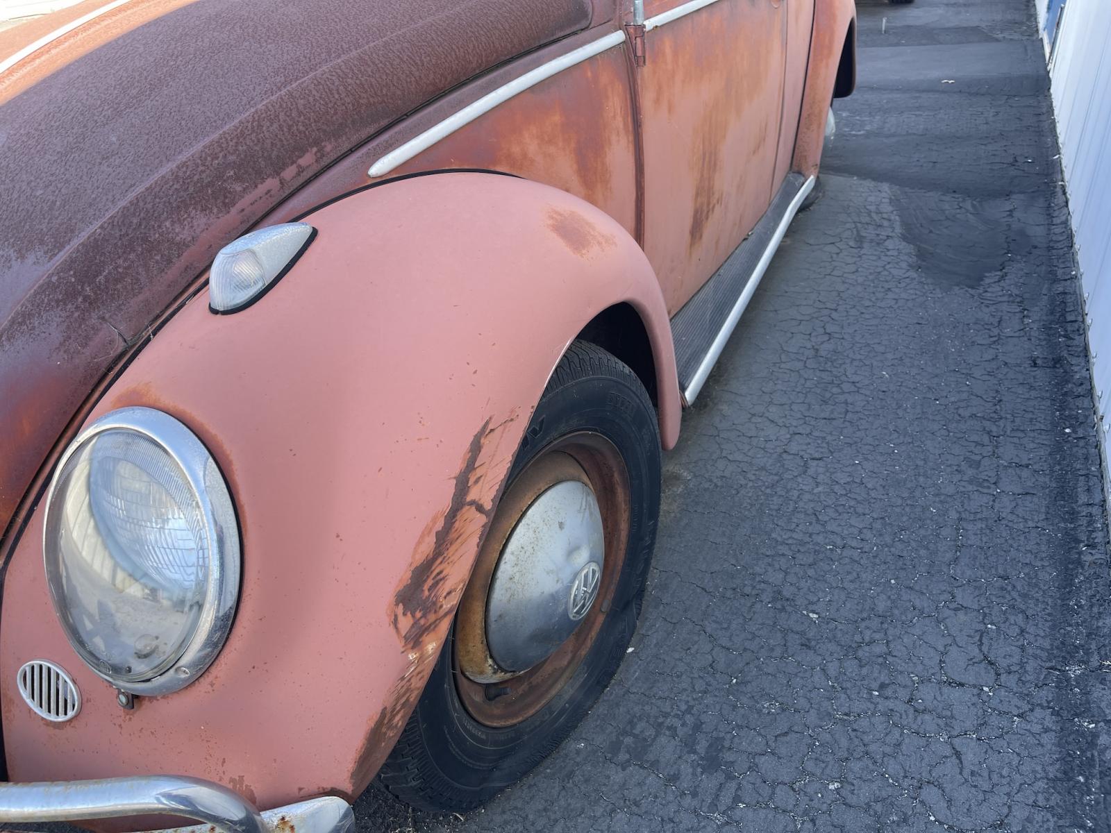

Wow - a very nice and very ORIGINAL car! The fenders can be repaired, other than that, it doesn't appear to have been hit in either the front of rear. Tights gaps on hood, decklid, and doors. Original seats and door cards (which look very restoreable). My suggestion is not to throw anything away - even if you decide not to go that route, someone else may want parts for restoration or to use as a sample.

I wish my '58 coral red sedan started out in this condition Very Happy
Check the engine numbers to see if they align with a '58... A bunch of stuff has been replaced that makes me think that maybe the engine is not original. (fuel pump, distributor, coil, air filter, generator and regulator all seem to be replacements).
Also strange that everything seems to be coral except the rear apron. Maybe there was rear end damage that was fixed at some point.

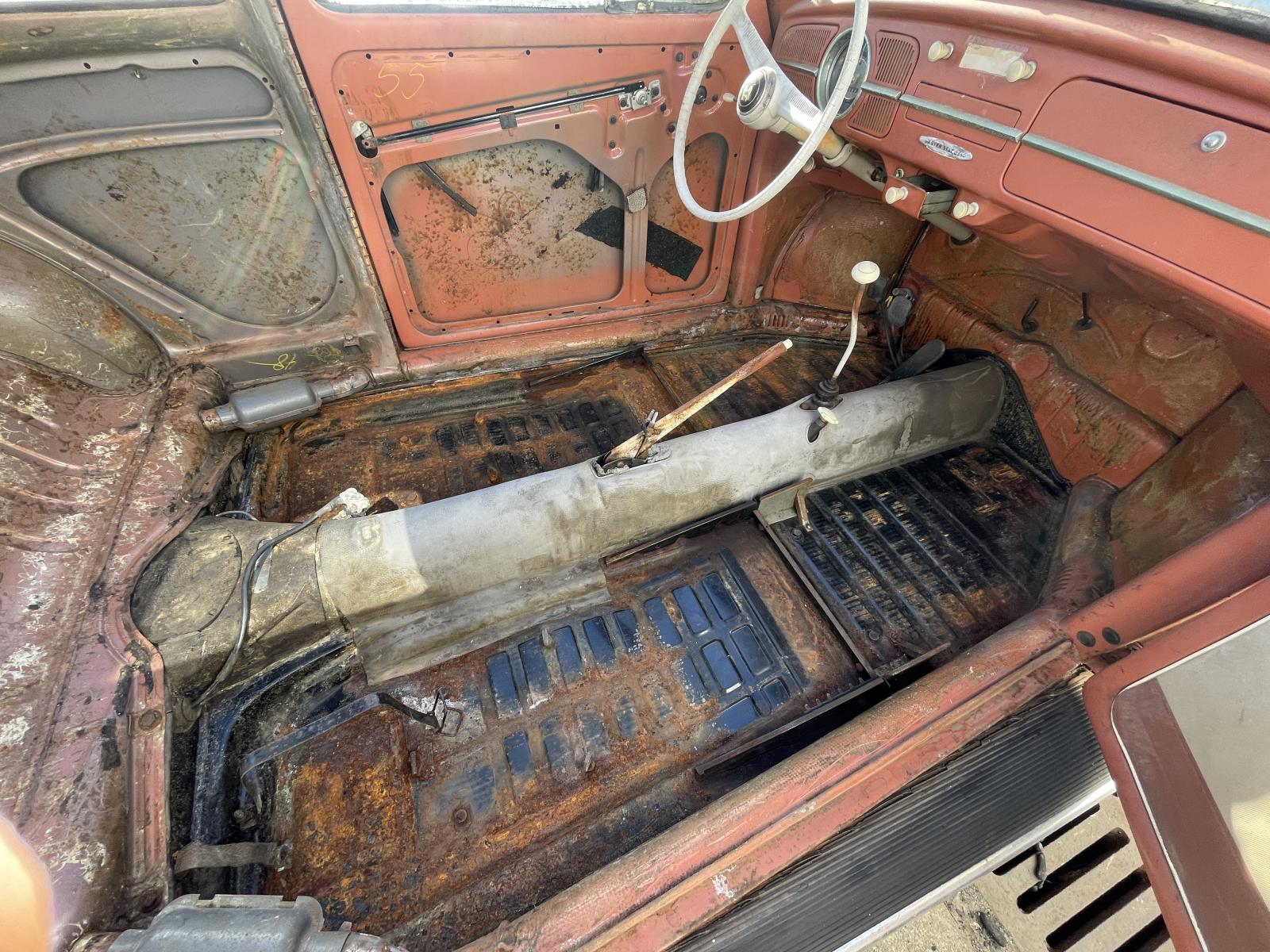

PostPosted: Wed Jun 05, 2024 10:09 am    Post subject: Re: 1st time bug owner - found a '58 ragtop. Reply with quote
Hey all. Thanks for the welcomes and comments on the car and the info about the Wolfsburg Okrasa engine upgrade kit, I wasn't aware of that until now but it looks like a great way to go!
Anyways, after I got back from overseas I gave the car a good scrub down with some 5:1 mixture CLR and some green scotch pads and then preserved the patina with a boiled linseed oil/mineral spirits mixture. It's probably not everyone's taste, but my wife and I like it.

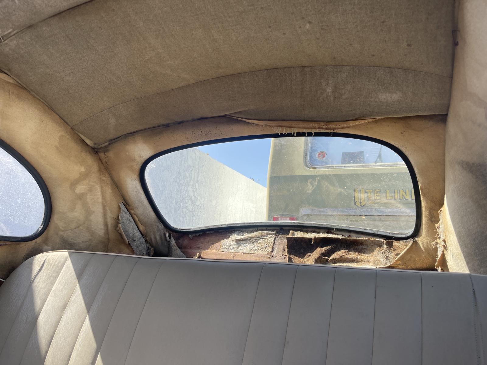

I also ripped out the stinky, moldy interior in readiness for a complete interior replacement.
I discovered the passenger seat had a very dodgy repair so I am now looking for a replacement.

What is under the floor pans securing the eye bolts used to anchor aftermarket/later year seat belts?
I've seatbelt end simply bolted thru pans with a collection of fender washers. Had the state inspector note no seatbelts as they were not required in '59, and I'm not trusting them to save my life.
The door cards are nice, clean em up, and keep the interior stock. Don't lose the headliner bows, and stripping out the cloth headliner you might want photos of it prior to to get the folds and seams located. Two tone seats, sweet. I've the optional all red seats with white piping (now hammered to death)

Not a lot actually. Looks like bolt with washer. That will be rectified properly!
Yep the door cards are good but the backing boards will need replacing as they are bowed but easy enough job to do. As to the headliner, I'm going to purchase the liner and have it installed by people who know what they are doing to save myself any frustration. The new rag top covering and floor/carpets I will do myself.

Remarkably solid car despite the torn sunroof.
The rubber tunnel mat appears to be solid, without obvious wear points near the pedals nor along the top at the openings for the shifter and e-brake. I suggest removing it "very" carefully if you want to inspect and clean the tunnel. The rubber has likely become brittle over the decades. Before you remove it, try applying a synthetic-based rubber softener so that when you do flex it during the removal, the rubber will bend and not break.
Do you plan to undent the fenders with hammer & dolly, and unbend the creased edge at the right front fender? Polish the bumpers with 0000 steel wool and a fine metal file for the rust pockmarks? Could also try spraying full-strength CLR onto the chrome surfaces of the bumper and letting the fluid work down the worst of the rust. Scrub with a brass bristle brush (not steel bristles which will scratch the remaining good chrome). But wear sturdy gloves, since those rust blister edges could cut your skin.
This might be too far into the future, but have you thought about what color sunroof and what material? Dark red or black; vinyl or canvas?
