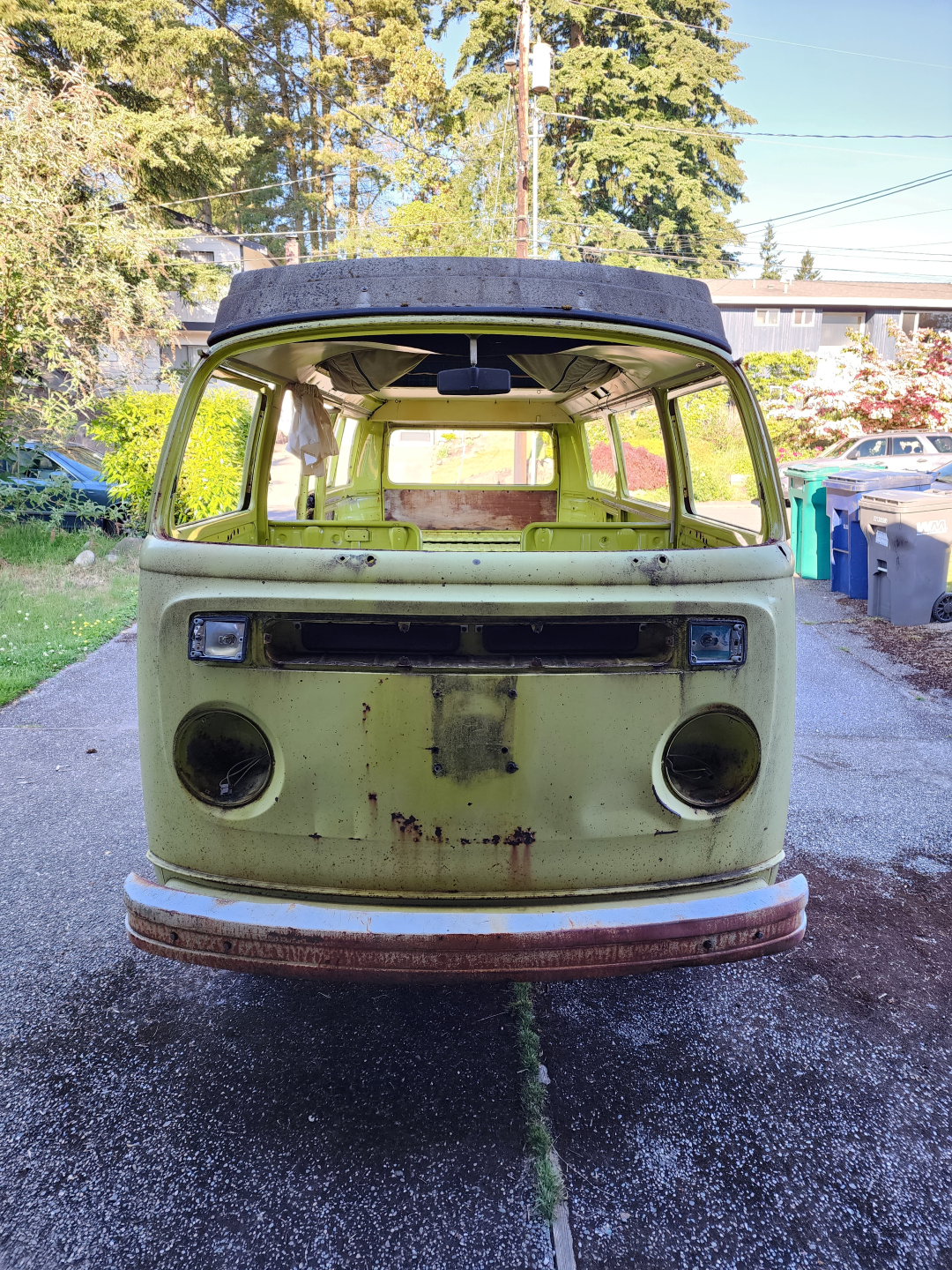

Before photos
Some photos from early-on in the tear-down process. Unfortunately I don't think I have any from before I started (I've always been bad about that).
After (almost) everything was out:
And it's off to the body shop to have the rust damage repaired and get some new paint à la Arizona Iced Tea aesthetic.
They're saying it could be as high as $30k....even with everything out. Does that seem normal? Seattle area.
