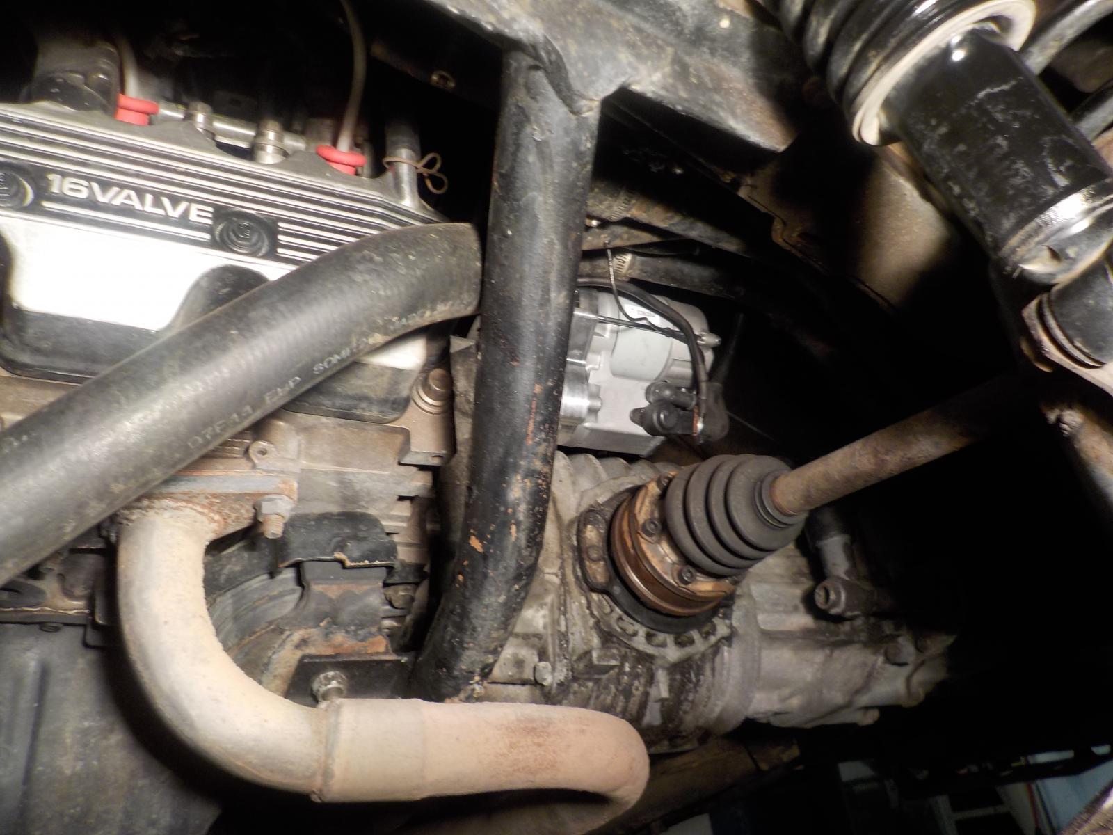

Hi everyone -
Really quick question. I'm about to install GW Gear Reduction Starter in 85 Vanagon w/ Auto trans.
Does it matter which connector accepts the red/gray wire in the attached photo? I'm thinking it goes into the connector shown on the left and the yellow wire goes into the connector shown on the right, but want to confirm, as no instructions came with the unit. Thank you.
[/img]

Unless the photo is not accurate, those plugs share the same wire, so it won't make any difference.
