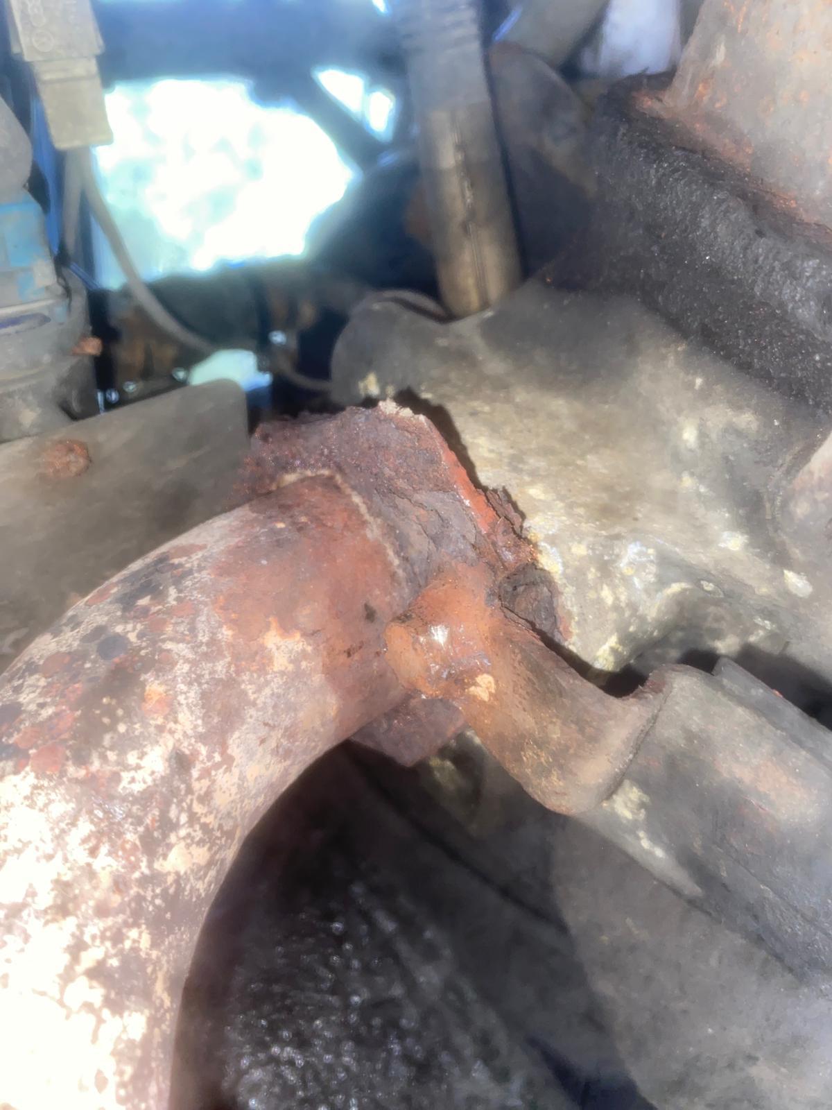

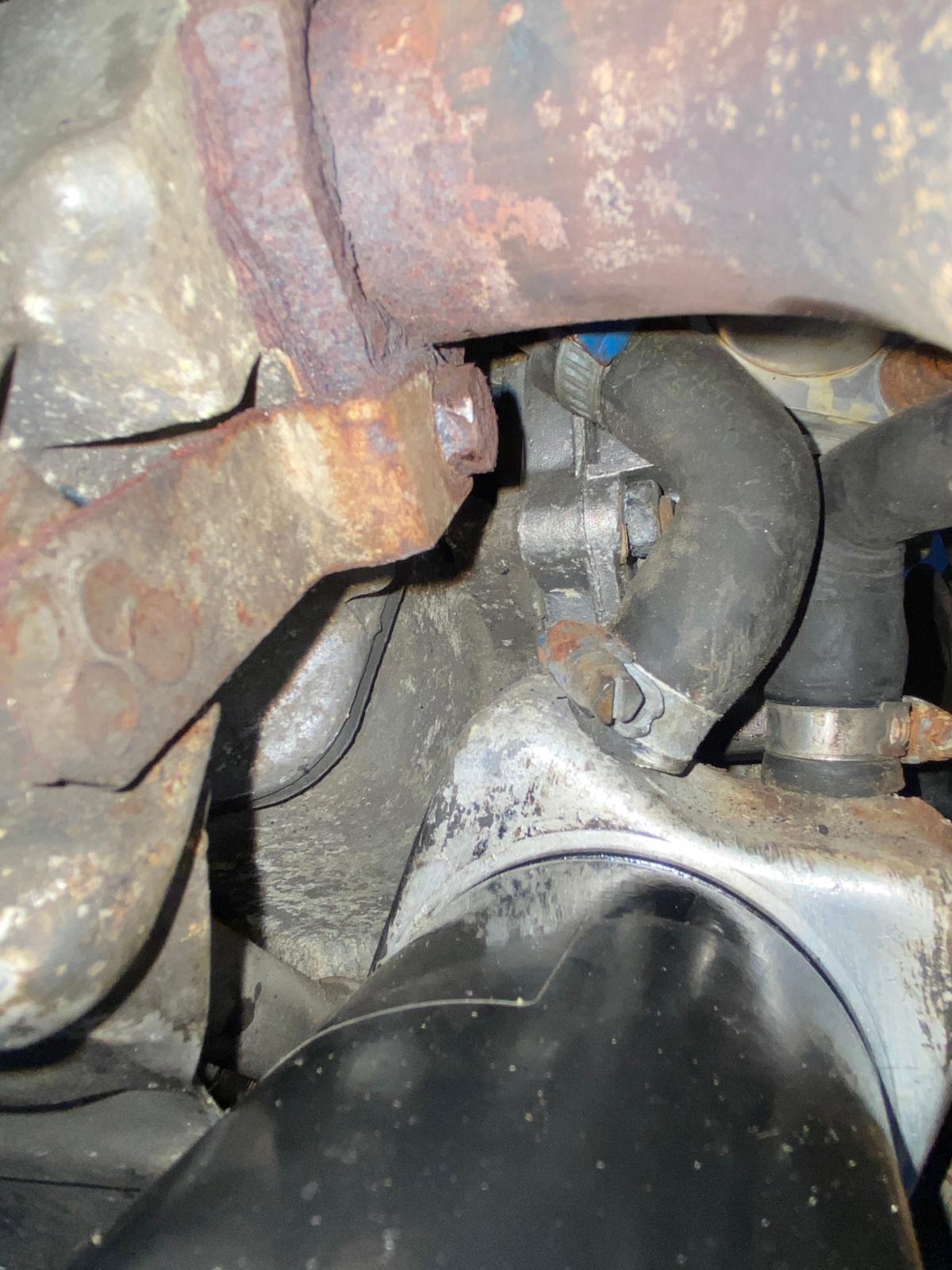

1. Cut the tin off the engine so I can reach the low pressure sensor and check the oil pressure like normal. Continue as planned depending on results. Bolt the tin back on... somehow?

I may be thick but I had an idea of what I was getting into with vanagons. If y'all can give me some feedback somewhere on the spectrum between "you're a moron, your engine's probably about to explode, change your plans" and "fuck it, have fun while you can, prepare to have your heart broken" it would go a long way in helping me get a better feel for this van. I expect many of you have been in similar situations and feel wiser and more experienced because of them. Please share your thoughts Very Happy

MAPP gas can be your friend for rusted hardware, but not sure about your "welded' comment on the remaining hardware. That's why a picture or two of your struggles would help. Smile

I believe the tin is bolted on with the exhaust on the two that you are mentioning as 'welded' looking... I would not touch those if that is the case, unless you can be also ready to pull the engine, and get the exhaust bolt/studs replaced... Not something I would touch in your exact position. The tin is mostly useful to keep the pushrod tubes from getting damaged, which is usually only likely when 'offroading' where big chunks of crap are flying around, or you go over big sticks or rocks. I don't keep mine on anymore. Once they come off, they stay off. I'd say cut the tin, get the oil pressure information you need and be done.

As for the pushrod tin... well, I can't quite remember if there would be space enough to cut the tin in an arc around just the oil pressure switch, depends on how much the tin can be pulled down after the lower bolts are out I guess. Tin Snips might fit without hitting the pushrod tubes, I don't know. BUT, I agree, the stock tubes are fragile. My remark that I don't run with the metal pushrod covers needs an asterisk, I guess. I run the spring loaded replacements that were pointed out to me by a well respected member here. I've picked the wrong ones before going to the source, as it were, of which ones work best... The ones I was steered to are something like $100 "Jaycee from CB" for a 1600cc beetle engine, you got to install them backwards to accommodate the different sized holes on head and block of the WBX, though. They come in multiple color options for a 'cool factor'... doesn't impact the performance, but its something... Ability to re-use them is the real reason. Stock works best when you can, as far as I've heard.

Re: getting to the low-pressure sensor, I'm going to leave the pushrod cover on for now. I frequent rocky roads and I don't think I'd feel great having fragile parts exposed if I were to hack the thing off today, not having a good way to get it back on.

Photos of the corroded bolts holding the cover in place. The first and second photos show the one that I speculate might be welded. I tried chipping away some of the rust at the base of the head and it's all just solid steel. I'm not getting that thing off anytime soon...

FWIW: Hot oil pressure is critical, and you’re well into the danger zone on mileage for an “unknown” engine.
burnyourkids wrote:
Quick, lazy, cheap option? I’d suggest just cutting the rusty pushrod shield tab shown above, get your
OP gauge installed & wire the tin back in place temporarily with a nice length of galvanized steel wire.
You’ll be checking OP, still protecting your pushrod tubes & on the road again in no time… Cool
