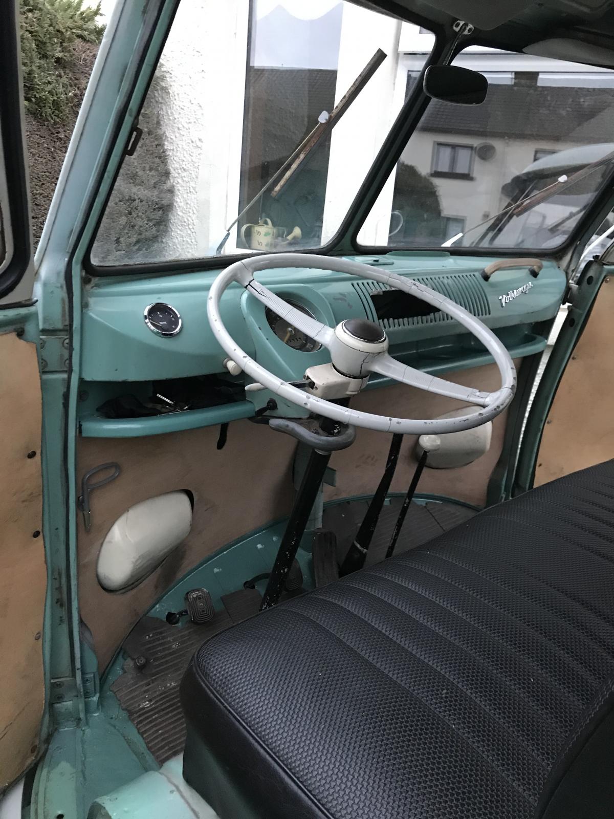

Dash unfortunately has been hacked but that will be a welding job for the winter when I replace the front screens/seals, the Volkswagen script I would normally hate but I’ve grown to like so will probably stay but I had to paint the dash tray, it’s a match close enough for me just now and now has no holes in it that’s not meant to be there.

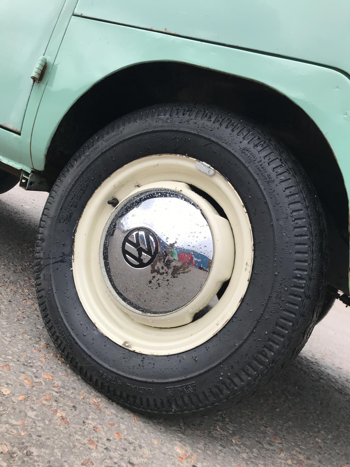

It had correct size crossplys on it which as pretty as they are had to go-I’ll drive the bus everywhere it’ll mostly be b-roads and it often rains in Scotland so the wandering an random grip you get with them is a no-no when carrying my daughter in it.
I tried Avon radial steels (Normally fitted to things like Aston Martins an jaguars Laughing)at first which look like crossplys but they were 185s an just made it rev a bit high a cruising speed so hauled them off,Sold them and fitted Falken 195 AT “soft roader” tyres-much better RPM at 50mph an ride great!

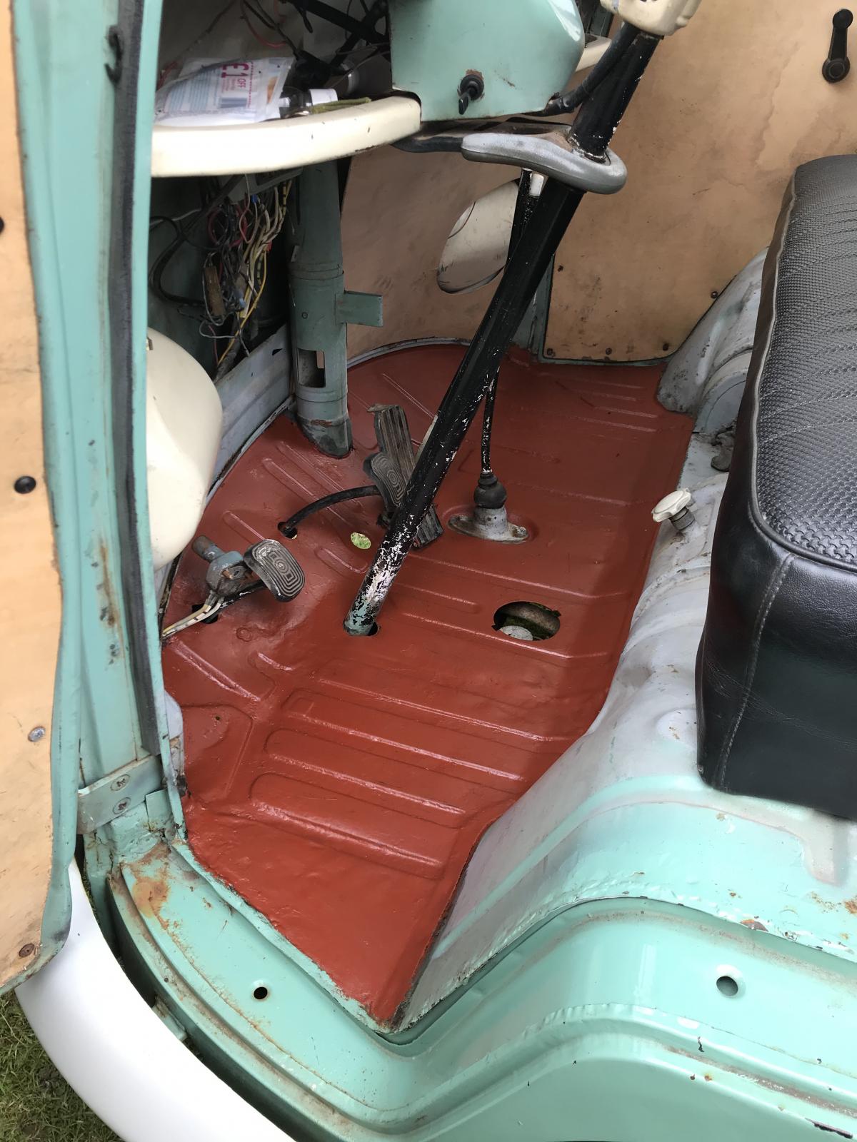

Cleaned up this mess/fire hazard, there was a plastic battery tray from a modern car and 2 spare dipsticks in here! Crazy how much crud came out! You can see original paint and the respray colour which is lighter the the original Turkis-its been re-painted in the 1960/70s I guess but all in the engine an cargo area too which I thought was strange.
A note on the paint, it should be a single tone bus which I think is great-maybe one day I’ll get it back to green on top. If anyone can post a link for a good M code decoder that would be great,either the one I was using wasn’t working anymore or I was doing it wrong. I did start decoding it from the Eccles Transporter guide,sticking the numbers in would probably be quicker.

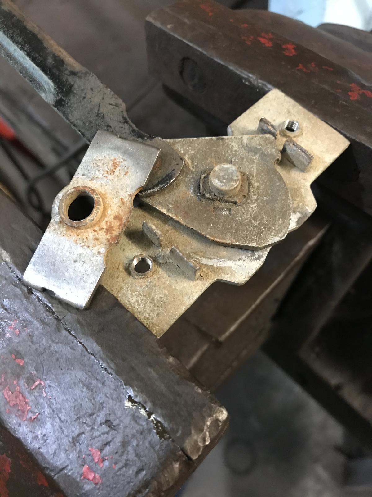

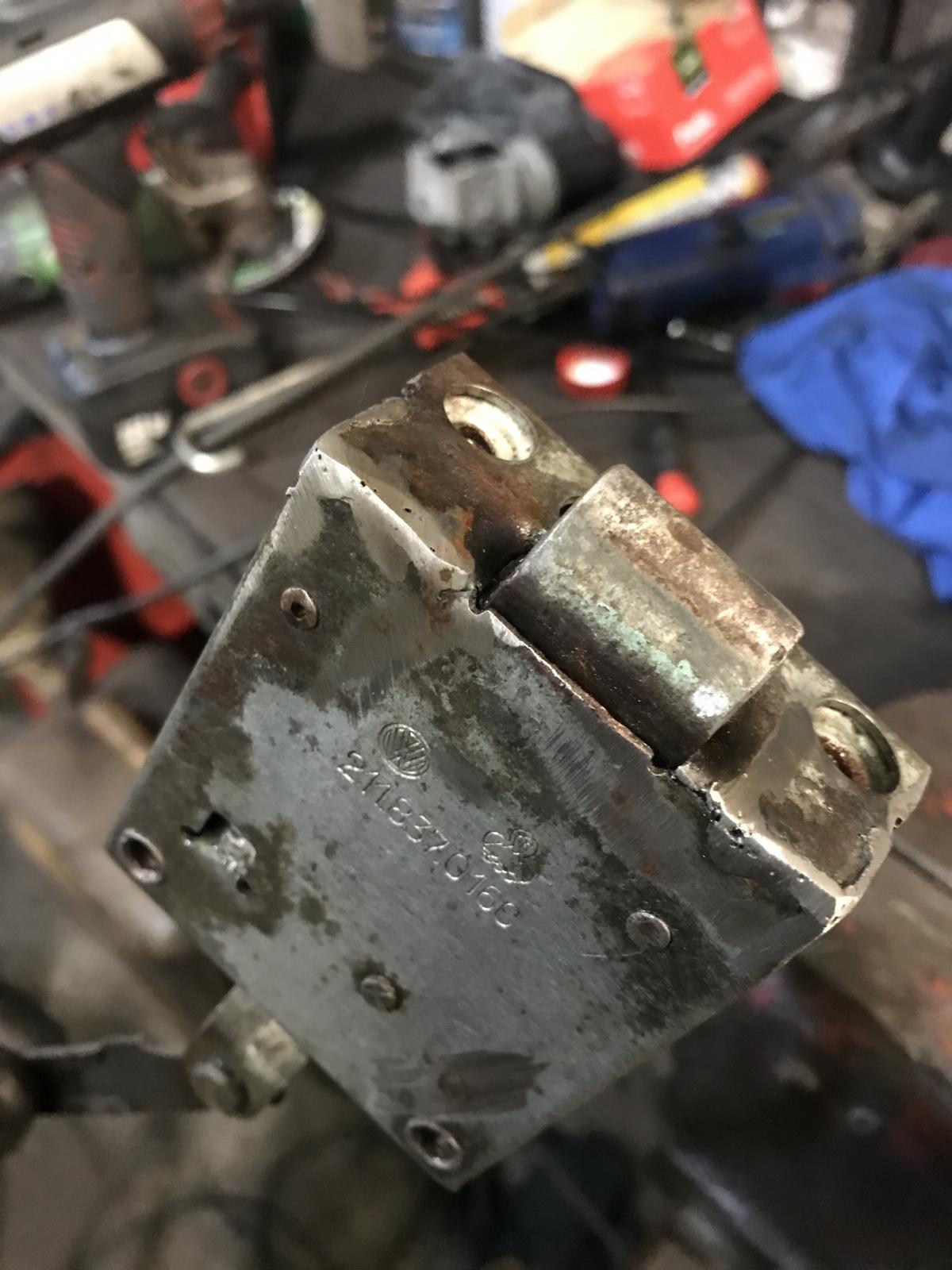

Another fun moment I had with the Bus one morning on the daily commute, a Left 90 degree bend with me nipping on (running late every damn day!) I had the passenger door fly open! Tried closing it, the latch part jammed so I had to drive on the second click with a bungee cord on the handle to dash Laughing
When it came to stripping down it was missing screws,the latch face where the screws go in had sheared off, the mech was seized and the striker was badly worn-honestly a complete casserole of nonsense due to no maintenance-I’m sure if someone had greased it back in the day none of this would’ve happened....
So I lubed up and freed off the latch, welded the catch screw plate part back on,replaced the striker plate with I think a NOS one, adjusted and started to put it back together, as I put the handle back on, the plate that holds the splined crank fell through into the door-REALLY!? off it came again, weld it up and re-fit. Now I guess you’re thinking just put a new one on...the damn thing owes me a lunch breaks-it’s gonna work for me now!
