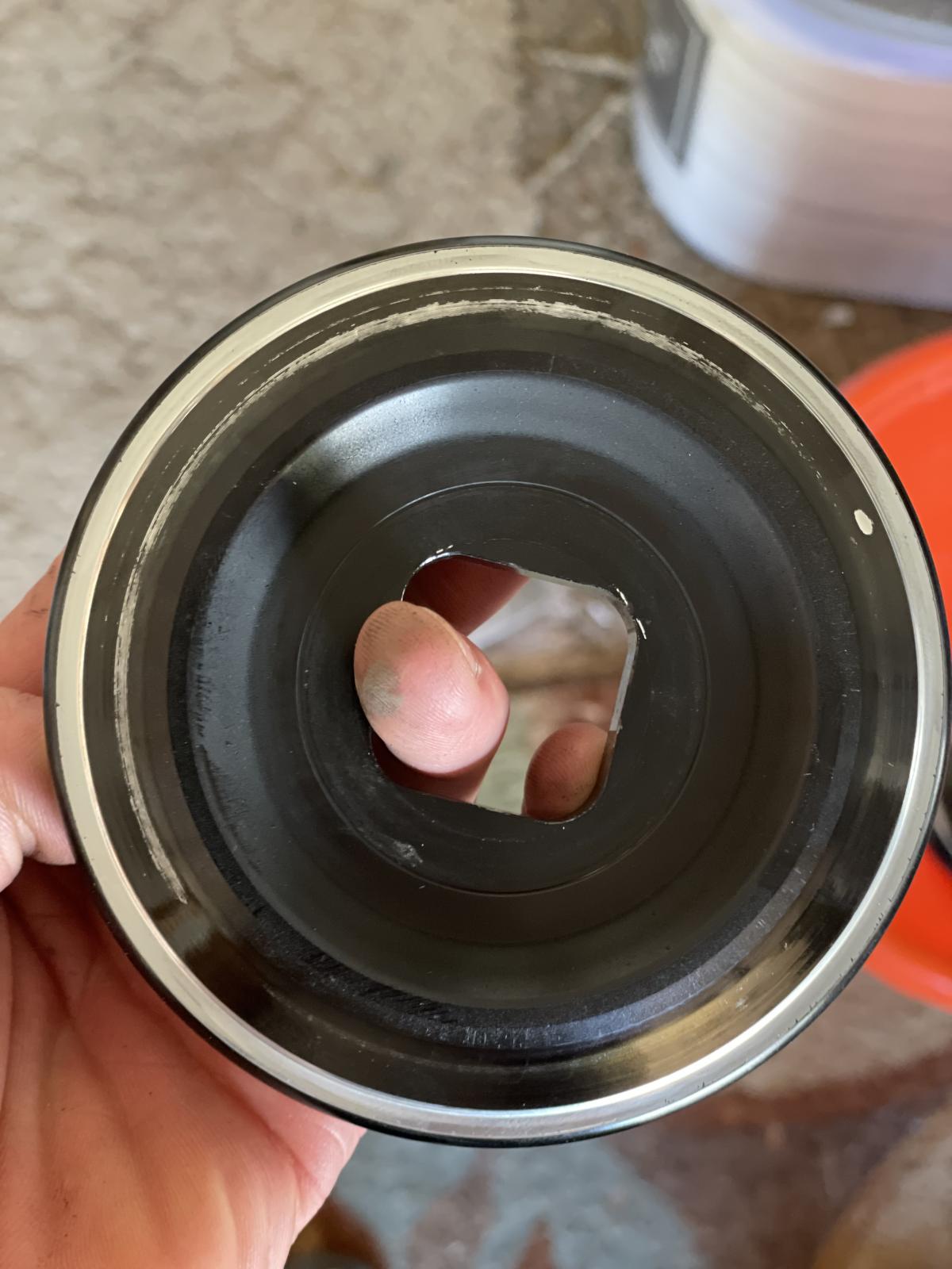

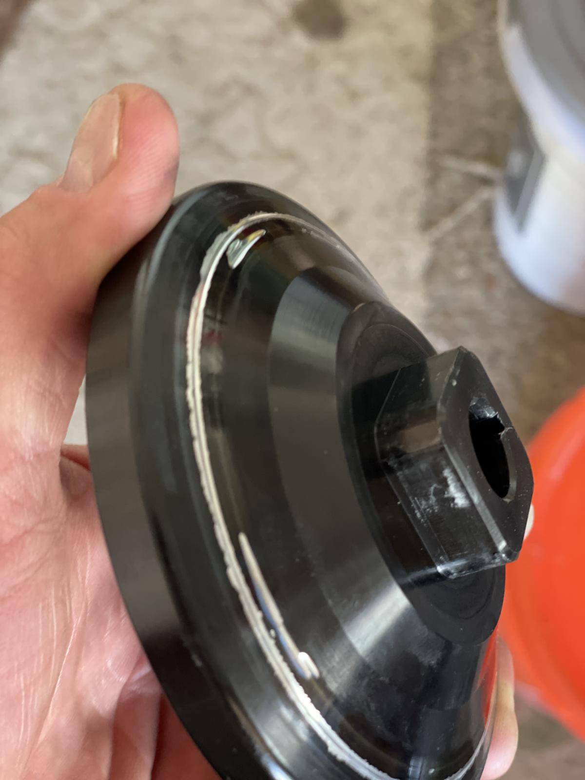

I have been using a CB 1914 billet alternator pulley on my bus motor for the last 17,000 miles. Over that time I’ve noticed that the face of the alternator has been turning black. I recently put a new smaller belt on, which I feel better matches the 6 3/4" Equalizer crank pulley I’m using. Anyway, when I pulled the alt pulley off I noticed there were deep groves on both sides and some gouges on the inside surface.
What do you think caused this to happen?

it's aluminum
not going to last forever.
I'm amazed that it hasn't worn through the anodizing entirely by now!

hard to tell from the pics, but to me it looks like the \/ of the pulley doesn't match the \/ of the belt. i would try running the new, improved belt and see if the wear pattern improves or declines.

I installed a new belt and pulley. CB was out of the stock steel pulleys, so I bought another Billet one. I did not want to make the trip down to Flagstaff for the Jamboree next week with the grooved pulley. I’m on the email list to be notified when the steel pulleys are back in stock and I will order one then.

So far the new pulley isn’t showing any wear and the alternator face does not have any black on it.

Is the back half of the pulley on the shaft hole supposed to have a slight chamfer or completely flat? I had a rash of pulleys come loose with the chamfer then I found one that was flat no chamfer to but up against the bushing on the generator and it stop self-destructing usually in 5 to 6k in one case i had to find a new bushing for the generator because it mushroomed out where it met the pulley, this happened both on my Type 3 and Bug.

Good point. A big chamfer would be no good. Those details matter.
