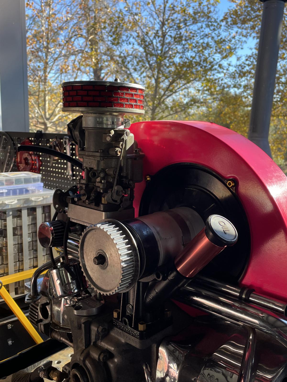

WrennMetallWerks wrote:
Yep…. It’s pretty neat.
I found it to be kinda tricky to get out.
I tried to pull the breast tin to make it easy but the downdraft tube runs through it and looked everywhere for my tool to remove the filler neck with no luck.
I did notice some interesting tin at the heat riser tube to the muffler.
This pulley tin looked odd to me as well.
I can honestly say I know very little about this application, it’s definitely interesting.
Those 36HP fresh air engine have a few unique features. 7.2 compression, special intake manifold with long exhaust crossover tubes and breast plate to reach them. Little tapped ears on the bottom of the engine case for fastening engine tin. Oil is drained by the strainer plate instead of boss on the case. The boss is still there but not drilled and tapped for a drain plug. Just like my 65 111, there should be no seat tracks, only the two studs per seat with a claw and wingnut to hold them down.

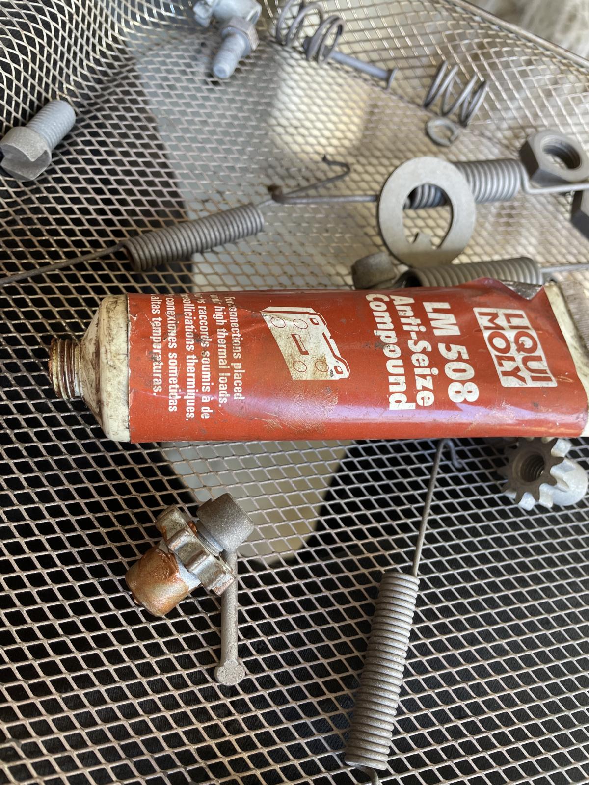

PostPosted: Thu Nov 28, 2024 8:40 pm    Post subject: Re: 65 European Standard (My Patina Pal) Reply with quote
I was taught to always use anti seizes on the adjusters as well where the brake pads sit on the raised sections on the backing plate.
You will see in one photo that I also like to use it on the speedo cable where it lives in the spindle, they can be a pain to remove when the cables go out. They seem to fail prematurely these days.
One little trick I like to use for the springs are these wire crimping, cutting and stripping pliers. It makes a perfect grab without damaging the spring itself.
⚒ Believe In The Power Of Positive Thinking ⚒
Purpose Over Pleasure 🕊
“Hard Werk ⚒ God First “

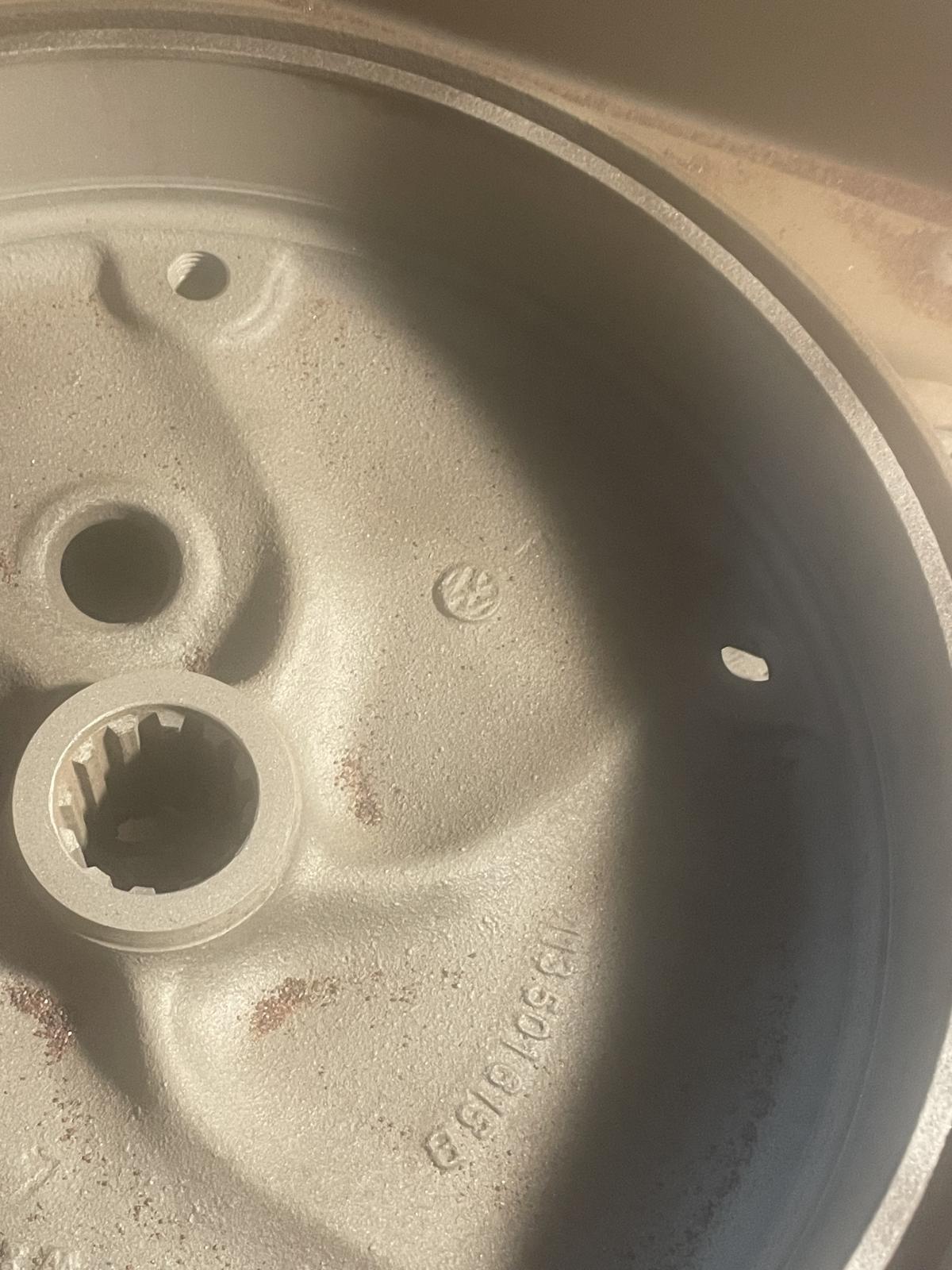

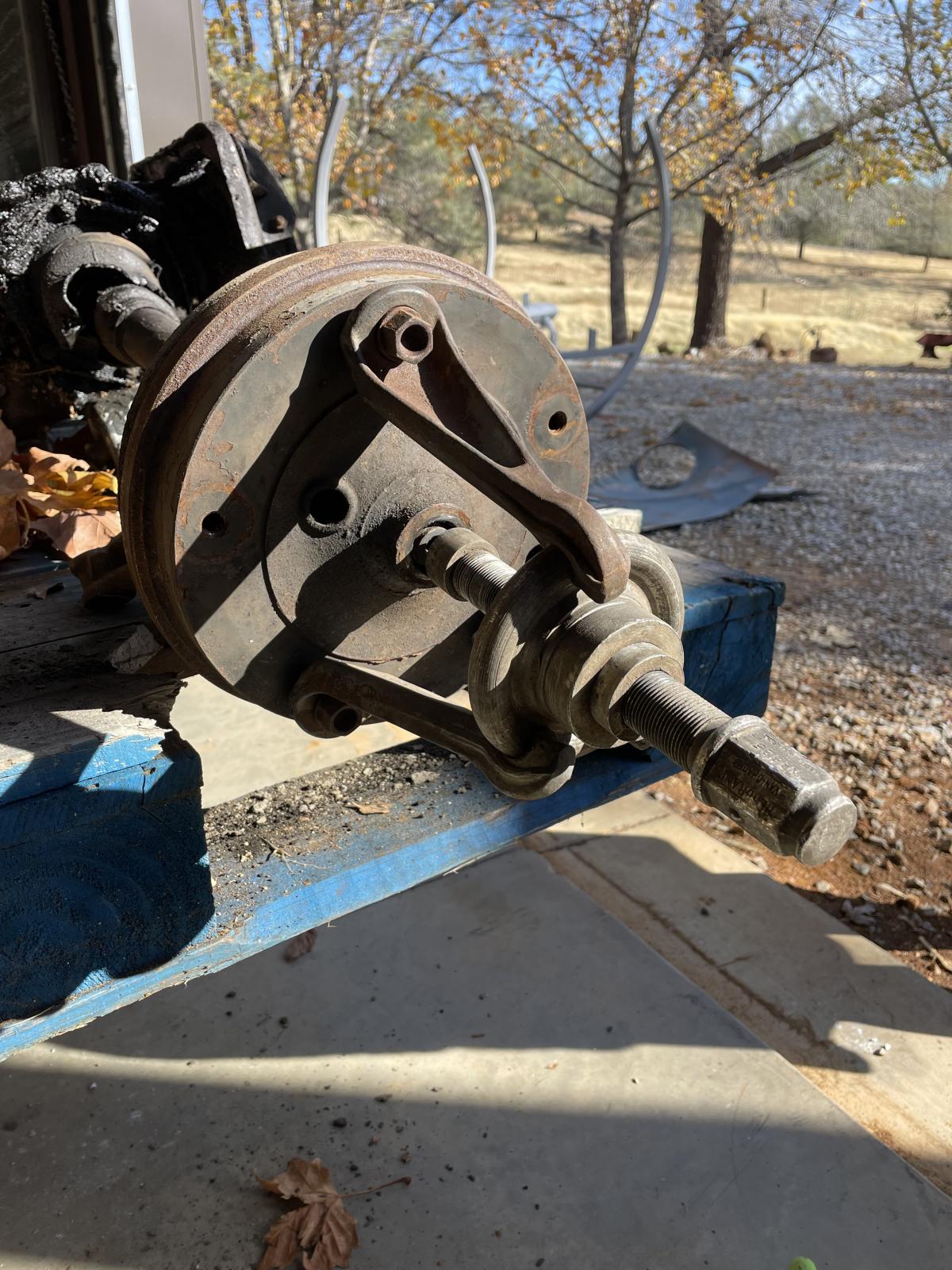

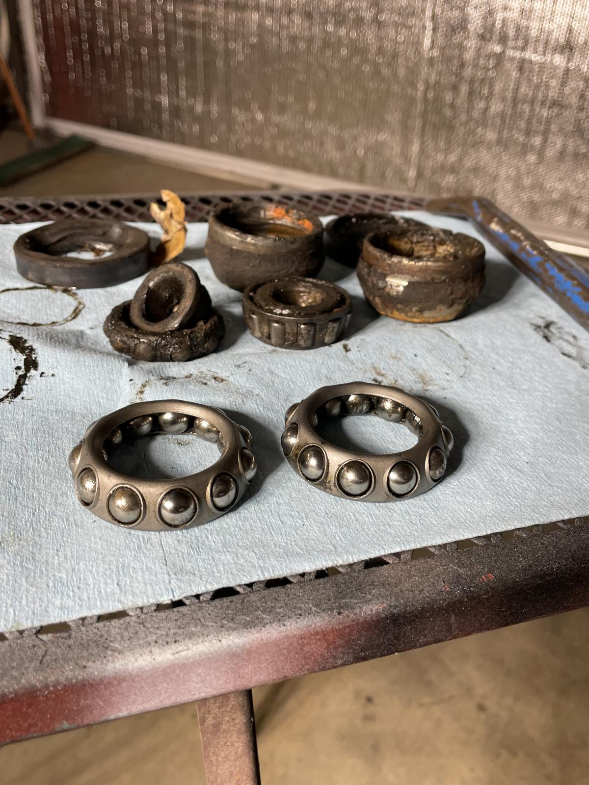

PostPosted: Fri Nov 29, 2024 12:06 pm    Post subject: Re: 65 European Standard (My Patina Pal) Reply with quote
Hope everyone had wonderful Thanksgiving….. it’s a beautiful far day… there is so much to he Grateful for!!!

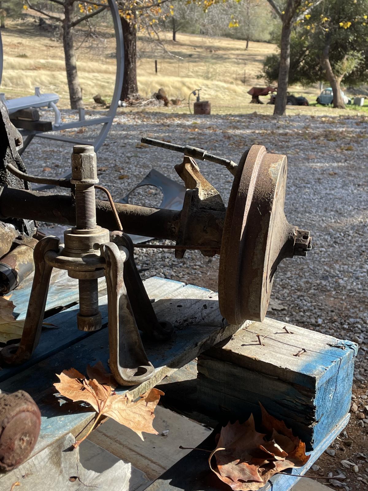

Time to harvest some more of the original parts from the suspension. I need to grab the ball bearing races off the spindles and then snag the rear brake compartments. I think I will take this stater off also and see if it will come to life.

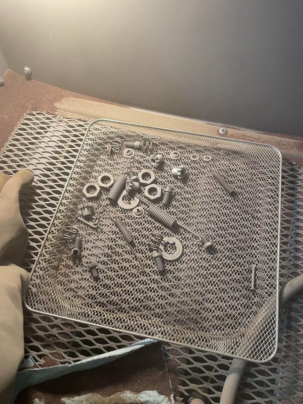

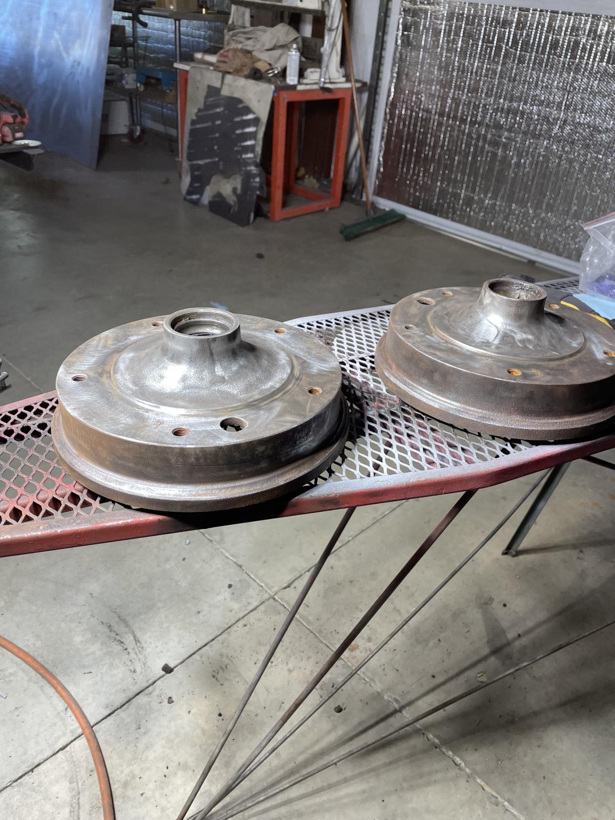

PostPosted: Fri Nov 29, 2024 4:03 pm    Post subject: Re: 65 European Standard (My Patina Pal) Reply with quote
Dirty but rewarding werk.
