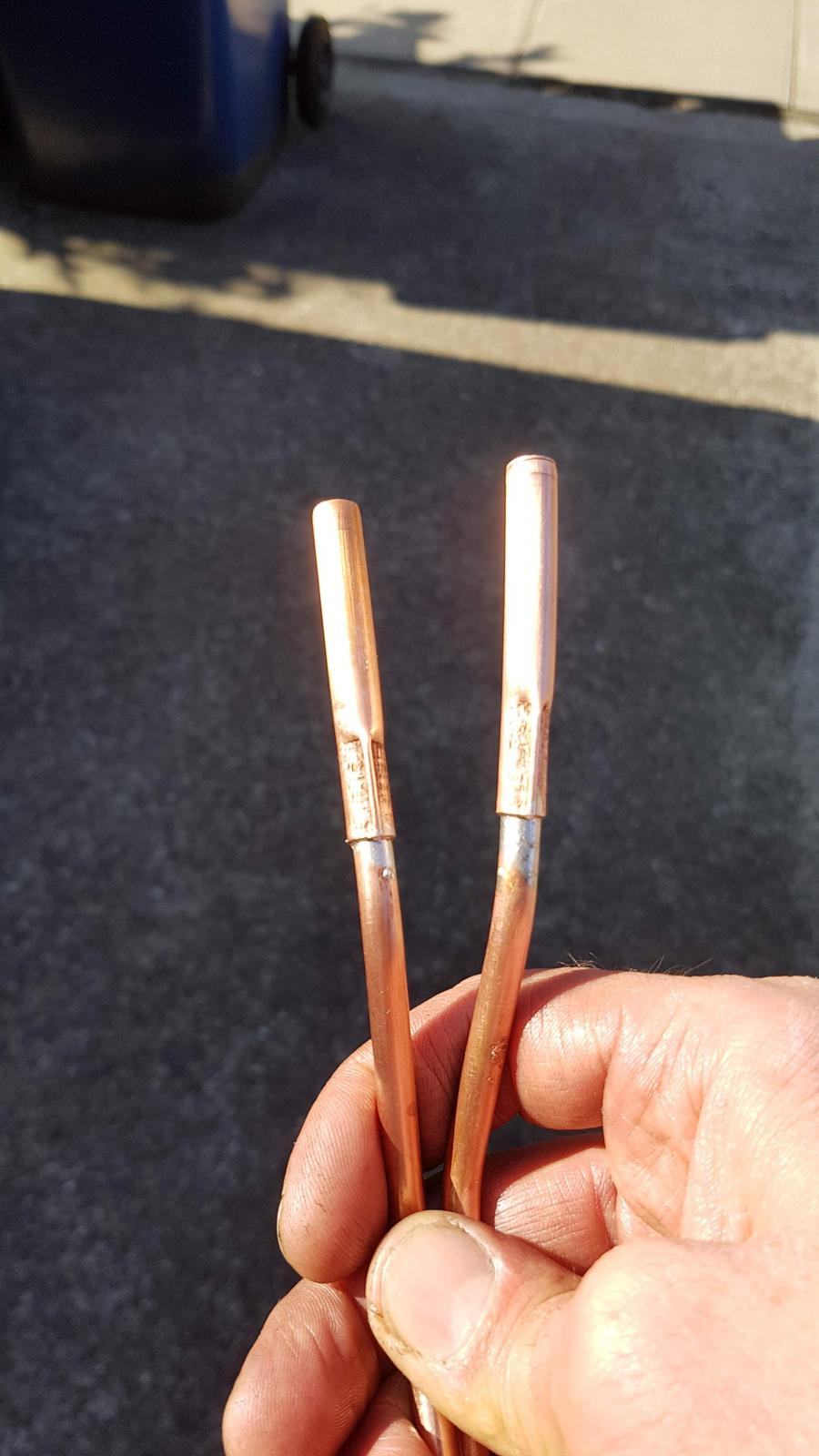

PostPosted: Wed Dec 04, 2024 2:09 pm    Post subject: Re: 67 brake reservoir questions Reply with quote
I used a '67 reservoir from WW when converting my '65 to dual circuit. This is how I solved the different pipe diameter problem. The WW reservoir came with copper tails. I already had the the larger OD copper pipe, so crimped it to size in a vice, using a screw as a former, then soldered it on.
That was 4 1/2 years ago, and no leaks. Though TBH aquifer's adapter barbs might be a better solution.
