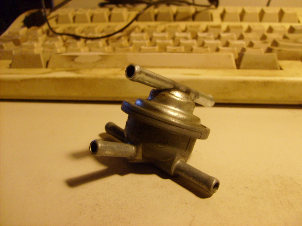

PostPosted: Thu Jun 12, 2025 1:11 pm    Post subject: Re: 72 Fastback Smokey Engine Reply with quote
Nothing jumps out at me here.
Do these carbs have chokes? Are they adjusted properly?
Have you checked fuel pump pressure?
Early cars with carbs had a fuel valve that prevented flooding while sitting, something like these:
https://www.thesamba.com/vw/forum/viewtopic.php?t=671540
The carbs don't have chokes but they were set up by and old school mechanic friend and the car is running really quite well and after a few minutes there is no smoke. I have never seen one of those fuel valves in any of the many air cooled VWs I've ever had.
They were only used for a couple of years. Later an anti-flow valve was incorporated into the fuel pump itself, so the separate valve was discontinued.
