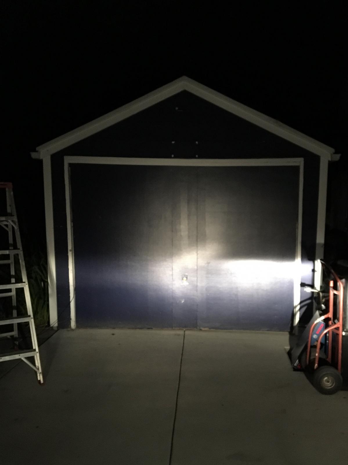

PostPosted: Sun Oct 27, 2024 10:25 pm    Post subject: Re: Square (87 - 91) Vanagon headlights. What is the basic problem? Reply with quote
Vana Guy wrote:
Why are they so dim. What is the basic problem? Is it the wiring? If I installed heavier gauge wire in a dedicated circuit would that help?
My sample size is small but I'd say 90% of the problem is the stock DOT headlamps.
- At 30+ years old the reflectors may have deteriorated and the lenses may be dirty on the inside.
- The DOT light pattern seems to be just plain lousy.
- I saw a remarkable improvement replacing the DOT fixtures with e-code units as did many other people in this thread: https://www.thesamba.com/vw/forum/viewtopic.php?t=...mp;start=0
Stock DOT fixture on the left, e-code fixture on the right. The brightness and cutoff on the road was, er, night and day.
The reflectors in my stock DOT fixtures were cracked, worn and not shiny at all. Years ago there were threads covering how to wash the inside of these fixtures. These may have been subject to some aggressive cleaning.
