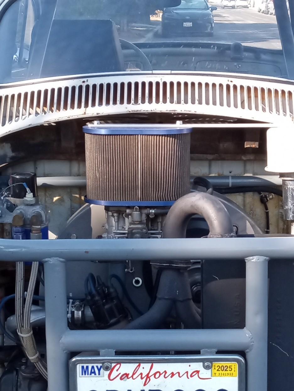

Two stage filter with K&N inside:
K&N filters with Outerwears:

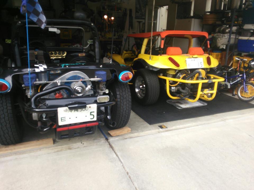

Not K&N, but an interesting set up my dad ran with a Holley Bug Spray to get the filtration away from the tire kick up:
It's not the filter, it's the application the filter is used for. Go to the K&N website and look for more info on the application you need a filter for.

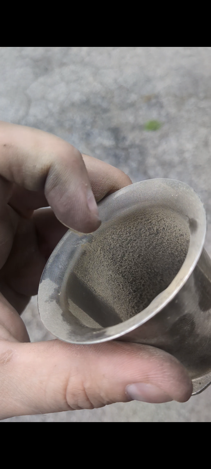

100%. I'm in the middle of making side panels with protected areas for my carbs because it made such a huge difference when I prototyped it with cardboard.
3.5-4 engine hours at 3/4 race pace (pushing it, but not violently) resulted in this:
Wiped out the rings, cylinders and valve jobs enough that I tore it down. It was oiled K&Ns with Outerwears on dual 44s. Obviously proximity to the tires and centermount/duals plays a huge role but we all know that. A centermount of any sort with even an okay filter will do better than duals in an open body with even some of the best filters. It is one of my more compelling reasons to deal with the limitations of a single for offroad apps. Still not compelling enough for me to actually run a single, but compelling enough to suggest it to other people. Laughing
