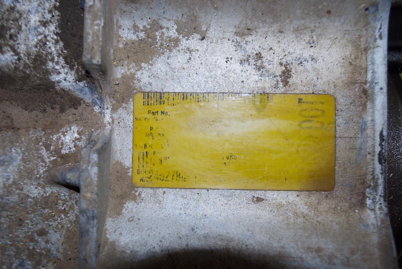

PostPosted: Sun Jul 10, 2016 8:18 am    Post subject: Re: July 2016 engine job vanagon 1991 multivan Reply with quote
The Yellow tag (unreadable)

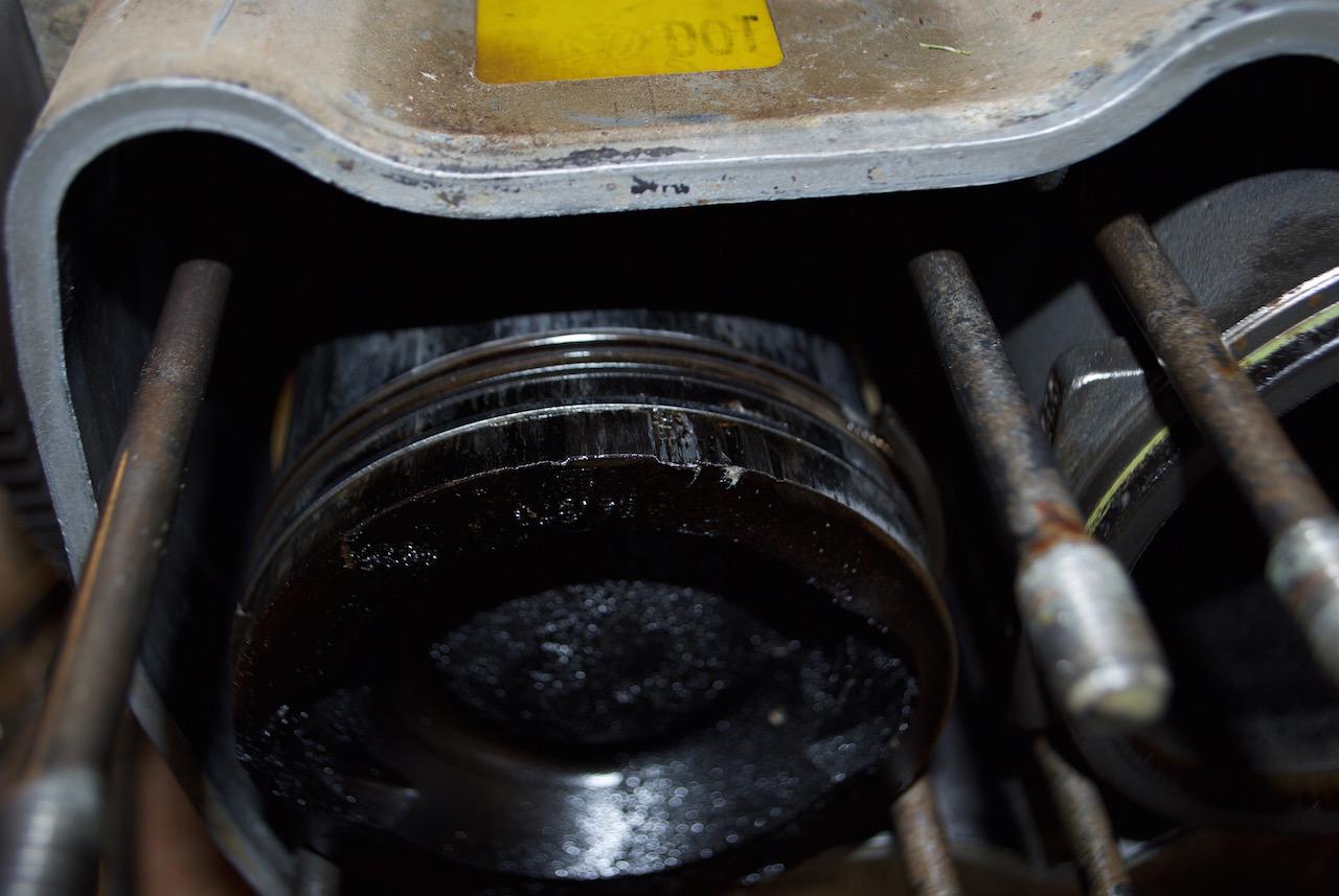

#3 and #4 piston and cylinder view, just opened.

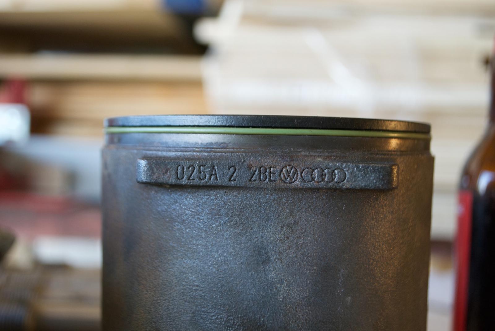

PostPosted: Sun Jul 10, 2016 8:23 am    Post subject: Re: July 2016 engine job vanagon 1991 multivan Reply with quote
The unfindable cylinder, with visible stamp (upside down).

PostPosted: Sun Jul 10, 2016 8:25 am    Post subject: Re: July 2016 engine job vanagon 1991 multivan Reply with quote
The damage #3 piston.

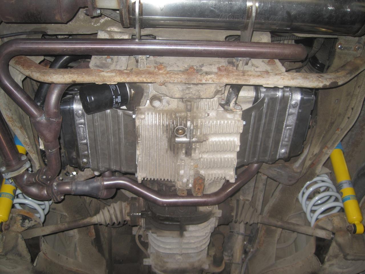

PostPosted: Sun Jul 10, 2016 8:39 am    Post subject: Re: July 2016 engine job vanagon 1991 multivan Reply with quote
Underneath after head (AMC Gowesty), exhaust (SS Gowesty), shocks (Bilstein HD Essex), springs (Gowesty zero lift) job.
There is leak in the clutch case. I couldn't find out yet if it's coming from the trany or the engine. I will change the main seal along with the trany coupler seal. Hopefully it does the trick.
