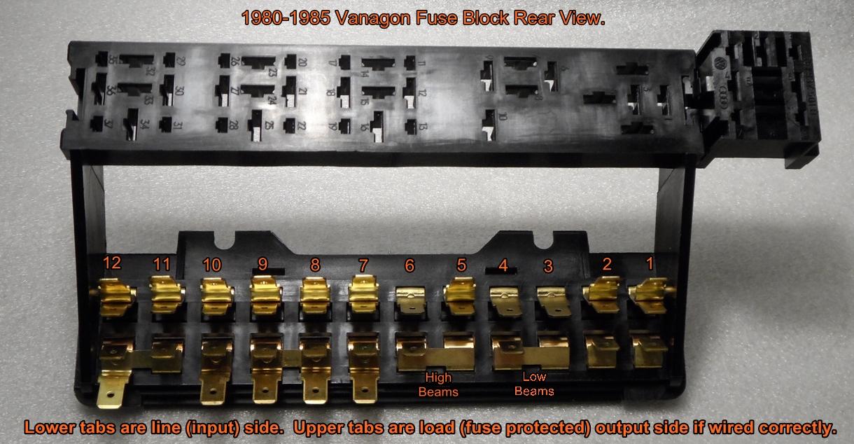

As Dave mentions, on 86-91 vans, you can grab power from the G terminals on the rear of the fuse block. No need to tap into any wires when nice 1/4" tabs are ripe for the picking.
Here is a full listing of the G terminals and their functions as originally posted by tencentlife:
G1 & G3- X-bus load-controlled power (hot when ign. on, goes cold when starter operates) via S12
G2 & G5- #15 ignition-switched power via S18 (this is the ideal power source for extra instruments)
G4- D+ (alternator trigger circuit) via alternator warning LED
G6-dead end
G7 -headlights power
G8 -dimmer-controlled panel lighting power (to light your extra gauges)
G9 -parking lights power via S20
G10- hot when windshield washer pump runs
Ground the gauges to the chassis using a ring terminal and a toothed washer. Scrape away enough paint after you drill the hole for the ring terminal mounting screw to ensure a good ground. A thin coating of dielectric compound over the ground connection once everything is nice and tight will help to fend off oxidation and corrosion as long as possible.
For 80-85 vans, a piggyback connector on the circuit protected (upper) side of any ignition controlled fuse should do the trick. Fuse assignments may change from aircooled to watercooled, so check your owners manual and use your trusty VOM or test light to confirm that you have a switched circuit.
Depending on the options installed, there may even be a couple open male tabs on the fuse block. The Dakota Digital ODYR/ SLX-11-1 gauge is listed as pulling 0.2A. If this is the gauge you have, there is no need to worry about overloading a circuit.

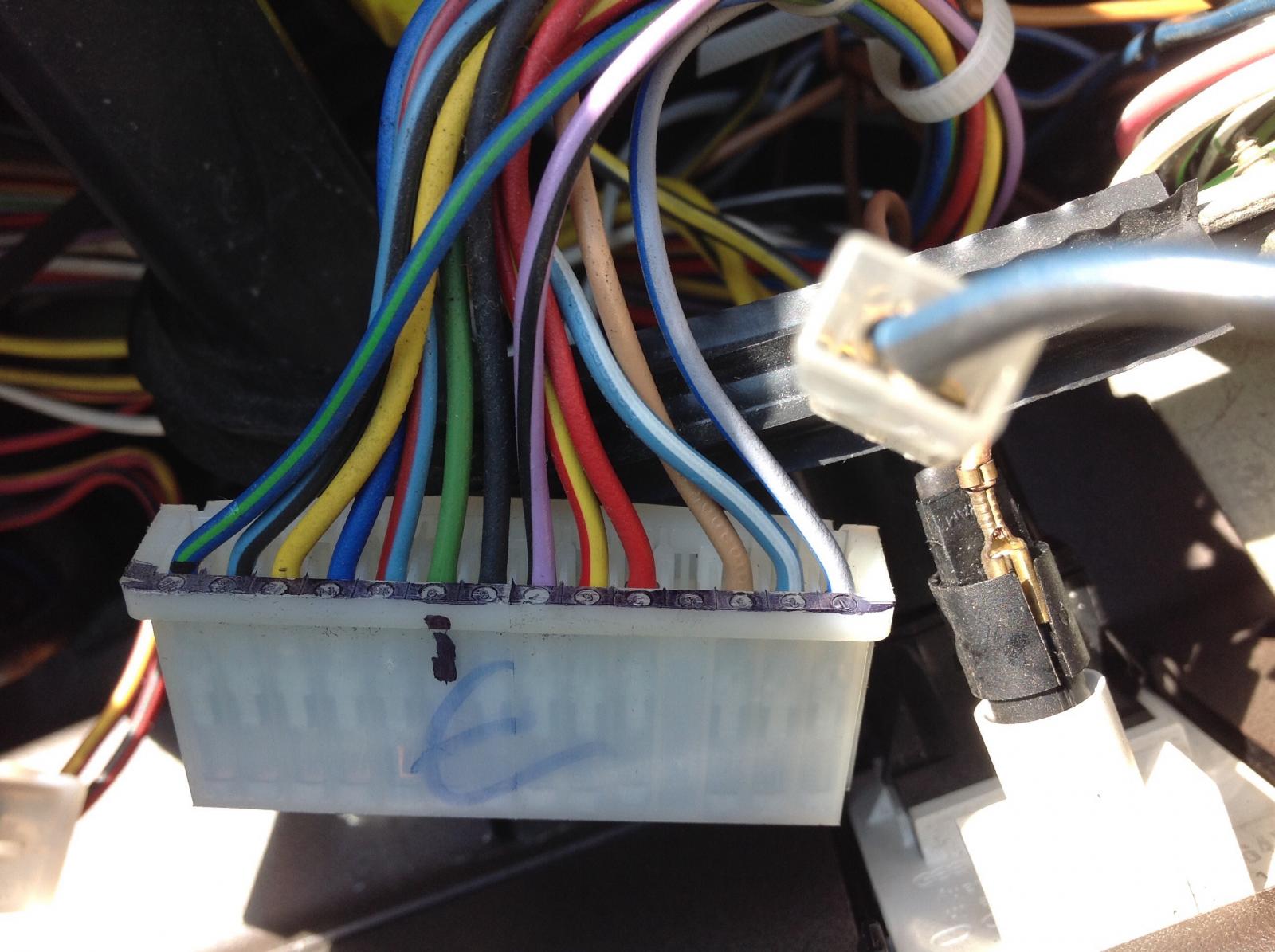

On my 86 (wiring diagram from Vin G 055 690)
G2 is protected by Fuse #18 a 10amp. This fuse serves the Seat Belt warning system and Brake warning system (foot and Parking) fuse Panel terminals G2, G5 and D7 are empty on the same fuse.
Interestingly....... Fuse 6 Terminals C22 and B16 is Vacant.
The Green wire is present in my Cluster Plug T14 spot 9 ........ I highlighted the numbers with a Sharpie......
The Green wire is also present in my engine wire box Plug T7a spot 5 and the green wire exits the box to the coil....... Green wire by my Pinky goes to Coil.....
I will check continuity to verify this but if the tach wire is already run, I will simply clip the green a few inches from the T14 connector (Allowing splice room just in case a Cluster tach is installed some day in the future and to not be THAT PO!!!! ) and pigtail it to my New VDO Tach. Why run a new Tach signal wire that already exists in the factory harness??
So again...... Sharing a common 12v feed and a Common ground will present no problems?
I will power up the electrics and verify the G2 terminal as a switched power point.

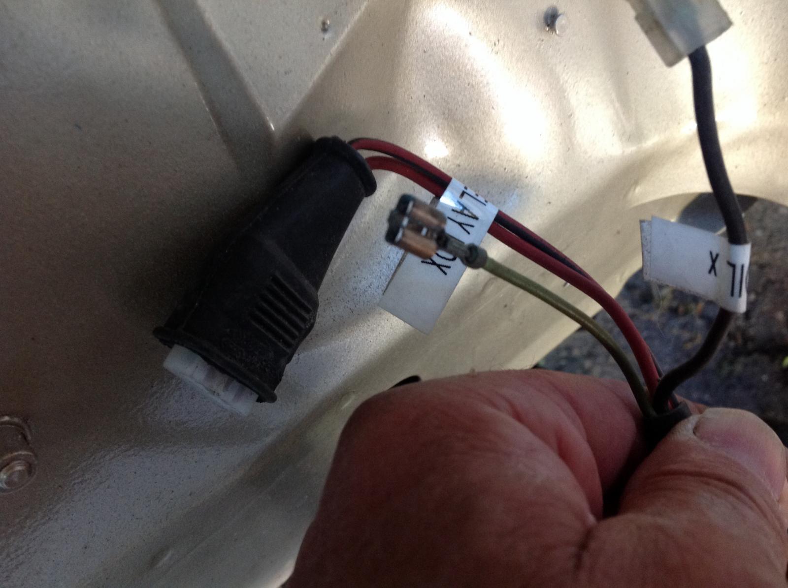

In 86-91 vans the green wire is used whether there is a tach or not. The oil pressure warning board in the cluster uses it. When it sees 2000 rpm and higher it monitors the high pressure oil switch. If you cut the green wire only the low pressure switch will be used by the oil warning system.
G6-dead end
Thank you for the pic and info…This makes things a bit easier. Should be a simple fix to locate an upper slot to tie into!
Mark
Wow!
Thanks for pointing THAT out!!!!!
I so should have seen that!
It looks like the two units share the one wire from the Coil.
I think that I will still use the factory green wire but Tee into it properly (stripped and soldered NOT a Scotch Lock) and feed my Tach.
Here is the diagram obviously showing this ......

For the Tach, I Tee'd into the green tach wire at the instrument cluster and ran a Green wire to the VDO "S" terminal.
Ran the provided wire from VanCafe from the Oil Pressure Gauge following the factory harness back to the engine.

For the switched +12v for the gauges I plugged into G2 on the rear of the fuse panel using a Red Wire.
The lights, ground and 12v wires leapfrog from one gauge to the other.
