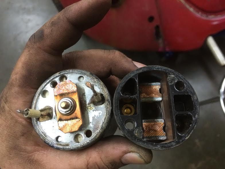

Yes and no. The ignition switch does not turn on the starter motor, the starter solenoid does. When you turn the key the electrical flow goes to the starter solenoid. This causes the the electromagnet of the solenoid to pull the starter gear into the flywheel gear. When those gears are fully engaged, deep inside the starter solenoid a pair of contacts are bridged across to send electrical flow directly from the battery to the starter motor. So electrical flow goes via from one to the other of the two big threaded posts on the front of the solenoid without this electrical flow going anywhere near the dashboard. A weak pull of the starter solenoid will cause weak contact of the bridge contact points in the starter solenoid and thusly a voltage drop in those connections going to the starter motor.
A hard start relay does help extend the lifespan of the ignition switch, but might as well install that relay up next to the ignition switch, then out of the weather that water is sprayed up under the VW when driving. Even better ignition switch protection from wear and tear would be to just install a hidden push switch and not have to turn the ignition switch to the "Start" position.
Better results than just blindly installing a hard start relay is to clean, dielectric grease, and tighten down ALL wiring connections and ALL grounds after cleaning those connection surfaces. The dielectric grease seals out both water and oxygen from getting into the connections so corrosion does not cause voltage drops.
Just the starter grounds are many when you really think of it. The starter solenoid grounds to the starter motor housing. The starter motor housing grounds to the transaxle. The transaxle grounds to the body via the ground body strap. Then finally the body needs to ground to the battery via the battery ground strap. ANY of those ground connections if loose or corroded or even painted over will cause starting problems even if all the wiring connections on the positive side are clean & tight to perfection.
If one needs a hard start relay due to slow/hard starting, most likely the other electrics onboard are also being adversely affected. Having bright lights mean you can see better and other drivers around you can see you better, faster wipers means better to see the road ahead of you, louder or any horn that does not work with wipers and all the lights working can mean the difference of being able to give that other driver a heads up you are there to avoid an accident, etc...
If one is running the earlier bell shaped headlight switch, those need to be opened up to solder all of the internal and external riveted together connections to remove voltage drops. Same for most any pre-1968 VW fuse boxes with the loose packed in brass clips that need to be soldered together in each slot. Sometime in later 1967 model year VW did finally spot weld those clips together, and for the 1968 model year was the standard for all VW types.
