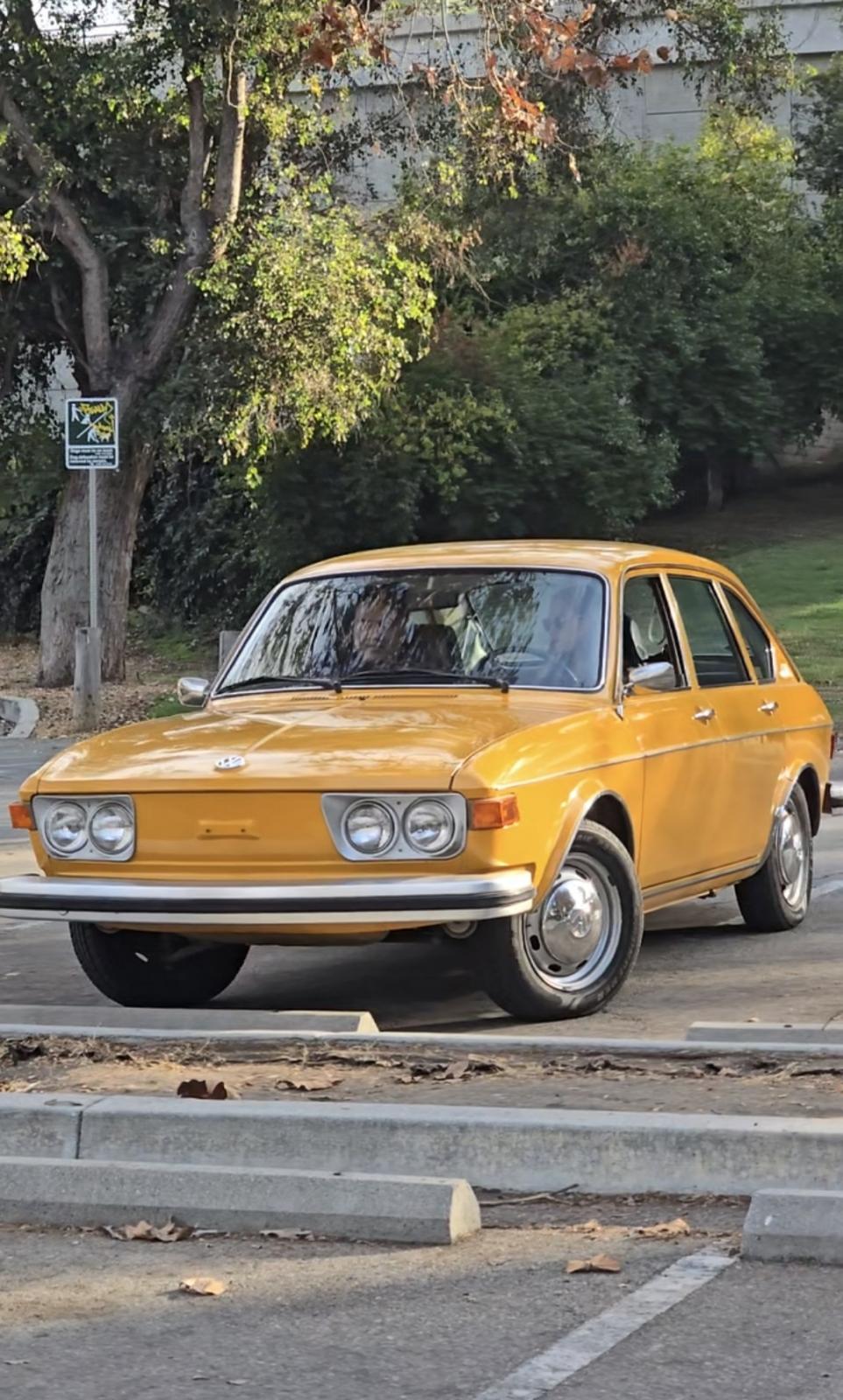

Ok so I finally got a 412. 1974 4-door. I read through all the lowering techniques. Yes I know the issues.. its clear but what isnt clear is how much drop the regular BMW E30 springs vs the BMW E30 M3 springs drop front of the car. I can find regular BMW E30 springs on ebay but the only M3 versions I can find are aftermarket and lower an E30 M3 an additional 0.25".. i would appreciate a clear answer on my question not some long winded explanation that doesnt answer my question. Ive searched high and low for the difference in drop height and how much of an overall drop BMW E30 springs achieve but all Im finding is vague info that devolves into a discussion about all the stupid issues these cars have. I get it.. but im here to get a clear answer about this question and yes I'll also do all the other stuff with the struts/bushings/ect. But please can someone just tell me how much E30 and E30 M3 springs drop the car (not just it levels it or tangets about spring rates, strut rebound, hitting bumps, bushings, strut bearings, audi struts, or w/e stuff that doesnt answer this question above)
Thanks in advance

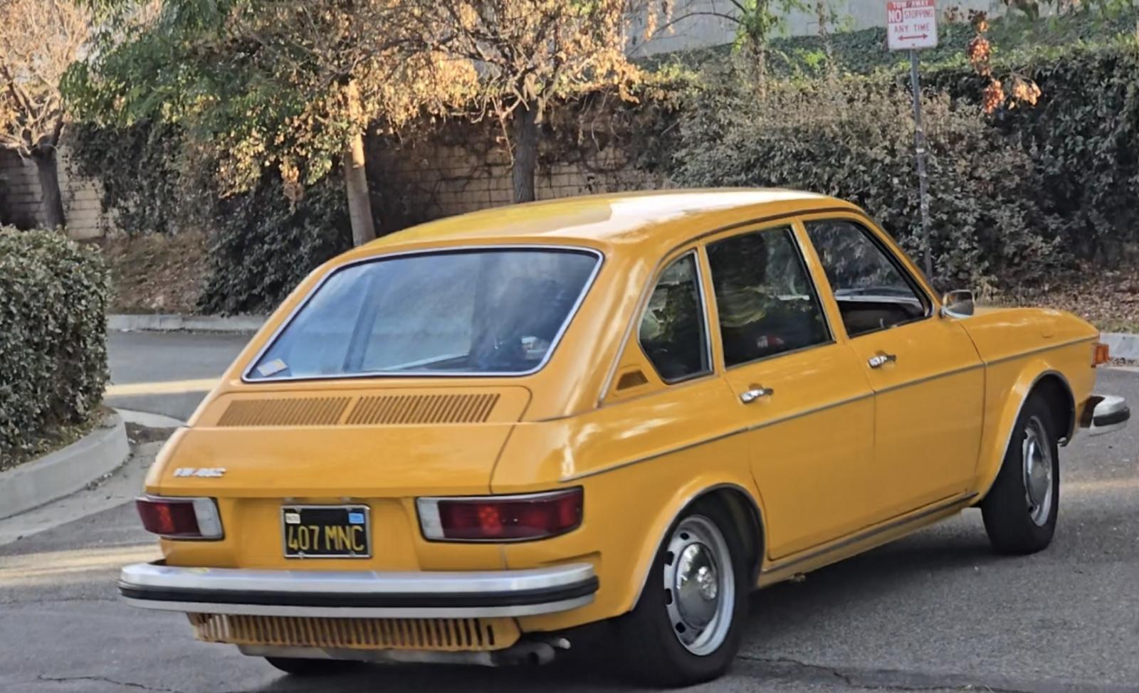

This group kinda sucks. Its been nearly 20 years and not one of you can give an estimate how much a stock e30 spring will drop the front of the car vs a e30 m3 spring.. guess this is why no one really gives a shit about type 4s because the forum is full of the same fear mongering bullshit over and over again for 20 years.. we get it the suspension fucking sucks. I asked a simple question.. thanks for writing a fucking bible like you have for the past two decades.

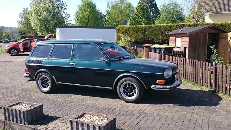

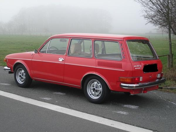

What I can contribute is the following:
I installed springs from the E30 4-cylinder and my shock absorbers were shortened custom-made ones from Koni.
If you want to do this conversion, you should definitely only use the original 4-cylinder springs (316/318).
They work even if the rest is still original (old shock absorbers, etc.), without losing the preload when fully extended. (Better and safer with adapted dampers, though)
You shouldn't use the springs from the 6-cylinder, as they are designed for a heavier engine. And we don't have one in the front.
What I would also definitely not use are M3 or other sports suspension springs. These are even shorter than the original 4 cylinder springs and therefore have no preload at all.
No guarantee that all of this is still correct. I wrote it down more from memory.
Found some pictures on my PC
with BMW E30
with BMW E30
with E30 6Zyl.-Spring and Bilstein
E30 Spring
E30 Spring

Hello Gerold! Thank you for the reply and pictures. At one time across the STF and maybe some other forums I have seen pictures of the black 412 Wagon and maybe the red one with the distinctive wheels.
Virtually all except for the beige 412 are not really lowered but are instead leveled or even slightly raised like the black one. But having the E30 Spring mod and the right damper/strut should greatly increase ride control and handling.
