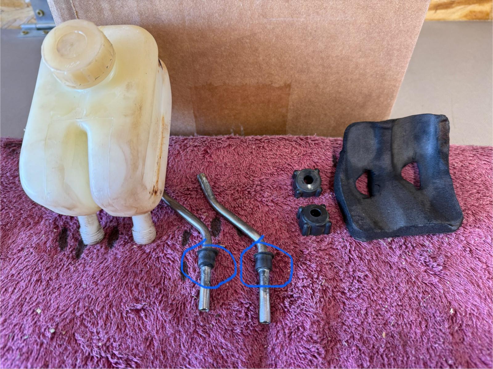

I’m replacing a leaking master cylinder in my 67. While I’m at it, I removed the reservoir to clean it and replace what looks to me like rubber fuel hoses being used for the supply hoses.
Anyway, it appears that there had been some gasket maker on the rubber seals (circled below). I got it cleaned off, but I’m wondering if I should smear a light coat of aviation gasket maker on them when I reassemble everything.
Is that a good idea? Thanks
Edited to add: how far on the steel lines should I put the hoses? The rubber lines that were on it were shoved clear up to the reservoir with two hose clamps on each one. That seems like overkill. Wondering what is normal.

I am not sure about the sealer. But you must make sure any sealer you use is brake fluid safe.
Black fluid hose should be used as not all fuel hose is compatible. Often the brake hose is blue colored, but not always.
The hose is typically inserted over the pipe no further than the bend in the pipe.
Use of hose or sealer that is not brake fluid compatible can contaminate and ruin the master cylinder.

Thanks for the info. I’m checking into the Permatex aviation’s resistance to brake fluid. Since none of the documentation I’ve found so far brags about resistance to brake fluid, I’m guessing it’s not.
If I could find new rubber grommets for my reservoir, that would probably be the best solution. But I haven’t seen the grommets for sale by themselves, so I’d have to buy a whole reservoir just to get the grommets. Still, a new reservoir is only $30, which includes the grommets and short steel lines, so it might be worth it just to get the grommets and steel lines, provided they fit properly into my original reservoir. I want to retain the original reservoir.
And I should have been more clear….I did buy proper brake hose because I knew those rubber fuel lines were a bad thing. I think it will work out fine because I’m replacing the master cylinder and the wheel cylinders too, so hopefully if there are any remnants they will get flushed out now.
I might just focus on trying to find new grommets, which would be the correct way to make sure it doesn’t leak when I put it all back together.

Consider converting to DOT 5 Silicone fluid. Conversion requires that ALL wetted rubber parts be new, if you are changing all hoses, and cylinder rubbers to new, then silicone is a great upgrade. I have done that on my Bug about 25 plus years ago. No need to flush the system every few years, as DOT5 wont absorb water. But you MUST use all new rubber bits as used rubber that has been exposed to conventional fluid can swell and fail once exposed to silicone fluid. I have done this conversion on two cars, love it. Basically maintenance free, and leaks wont eat paint either.

I like DOT 5, and that's what I installed in my '67 with a fresh zero-mile full replacement of all brake components. Bleeding took a bit longer but that was all. While I was researching which fluid to use, I came across a statement about flushing any accumulated water from the wheel cylinders that I'd never considered: The bleeder ports are at the highest part of the wheel cylinders, so any water accumulation will be left in the cylinders unless they're removed and turned upside down during the flush.
It's a risk I'm willing to take but worth considering nonetheless.
Regarding the rubber grommets, I'm not aware of anyone selling them individually, they are always part of a "reservoir assembly," but I can't see any reason for them to have a sealant applied. The nuts form a compression seal on them.

I have seen threads and comments where people have switched to DOT 5, but I hadn’t really gone down that path in my mind yet. I appreciate the suggestion, and I will do more research. It is appealing that it won’t eat paint if/when I spill it, and there’s less maintenance.
I’ve read that brakes feel more spongy with DOT 5. Is that true? Of course, my 67 isn’t going to be driven hard by any means, and if it’s just a matter of getting used to it, then that’s probably ok with me. Just thinking out loud here.
Another small issue has arisen. I think I’ve discovered that the short steel lines at the reservoir are 1/4”, while the fittings on the master cylinder are 5/16”. I can get brass hose barb adapters, but this would double the number of fittings where a leak can potentially occur. I realize now that the PO just used 5/16 hose and pushed it all the way on the reservoir lines using 2 hose clamps per line to keep it from leaking.
This can’t be what VW intended. I know the supply hoses are not under pressure, but is there a better/preferred way to deal with this?

That’s how it was for 67. VW actually had a hose with different size ID on each end. NLA. The brass barb is one option. What I’ve had on my 65 where I converted to the 67 set up are the cut off ends of the cheap common fuel filter. The nipple on each side is a stepped shape and is perfect. I came across a Yt video tip about using heat to reshape the hoses. I’m going to experiment to see if I can replicate the VW NLA part with that approach.

With air in both circuits, when you try to pump bleed the rear circuit first you are first pushing against the front circuit in the MC. So it is like having a huge fluffy pillow over the brake pedal when first rear bleeding.

67rustavenger wrote:
As weird as it sounds. Yes, start at the left front wheel cylinder and work your way away from the MC.
Like you, I was taught to start at the furthest away wheel cylinder and work my closer to the MC. It works, don't fight it.
Front axle first. Wheel cylinder farthest first from MC on each axle.
EG left hand drive start with front right wheel cylinder. Right hand drive start with front left side wheel cylinder.
In Stereo, Where Available!
aquifer
Joined: August 30, 2021
Posts: 200
Location: Nebraska
aquifer is offline
PostPosted: Sun Sep 29, 2024 4:08 pm    Post subject: Re: 67 brake reservoir questions Reply with quote
Well I’ll be. I stand corrected! I will follow your advice (and the manual).
I guess it does make sense, I have just assumed this was a set procedure and didn’t need revisiting!

And to totally confuse everyone.
FOR SOME OF US WITH DUAL MASTER CYLINDER FACTORY DISC BRAKES e.g.Euro Beetles.
Bleed the rears first then the fronts.
Eric&Barb
Joined: September 19, 2004
Posts: 25533
Eric&Barb is online now
PostPosted: Sun Sep 29, 2024 4:37 pm    Post subject: Re: 67 brake reservoir questions Reply with quote
Except for not talking disc brake overseas beetles. Very Happy
