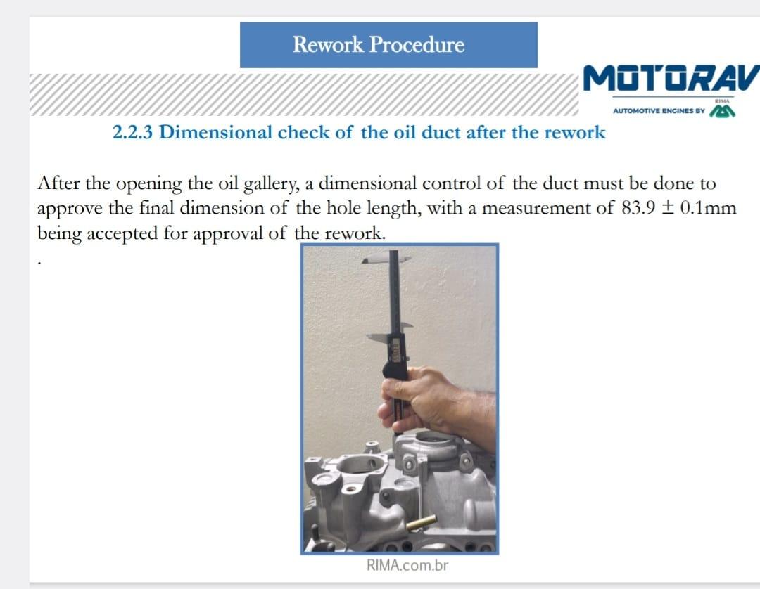

The RIMA foundry took over casting the magnesium cases years back under license agreement with VW. RIMA continued to manufacture cases with the VW logo after the license expired and was ordered to stop production leading to the case shortage a few years back. The cases have been plagued by various issues since the beginning. Line bore issues were the first and looks like oil gallery drillings are the latest.
Motorav is the new name brand in Brazil selling the non VW logo magnesium stock cases which are still being cast at the RIMA foundry.

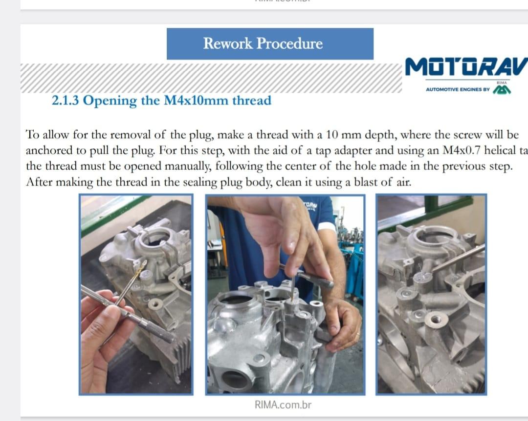

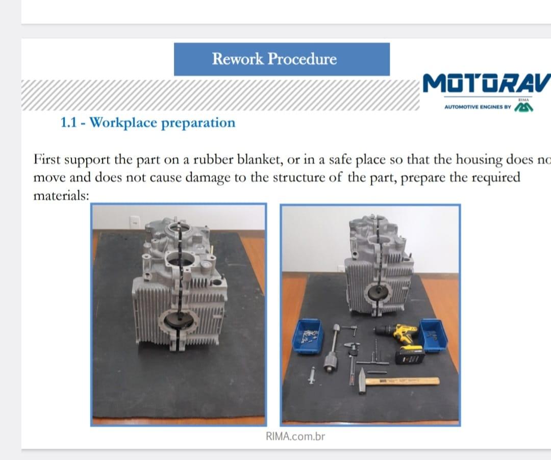

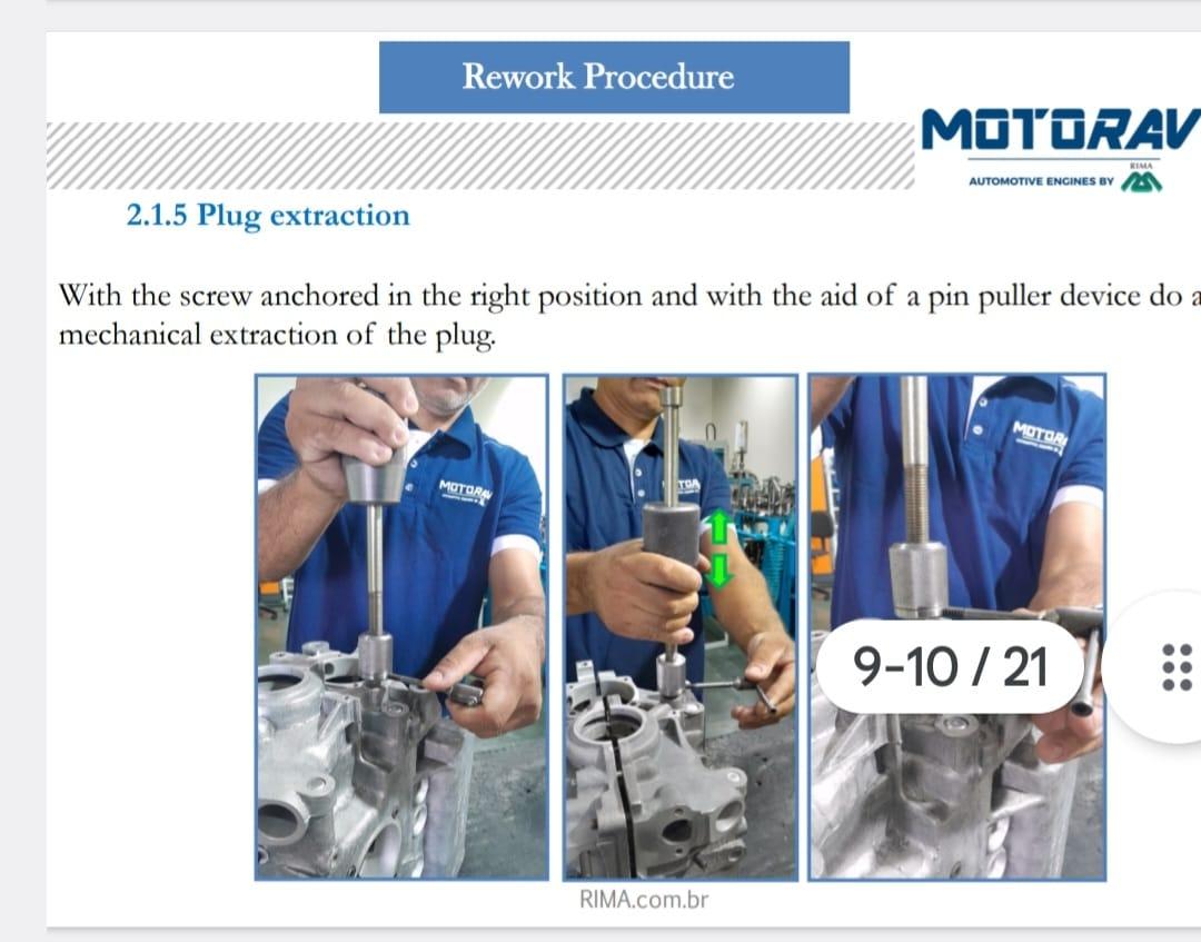

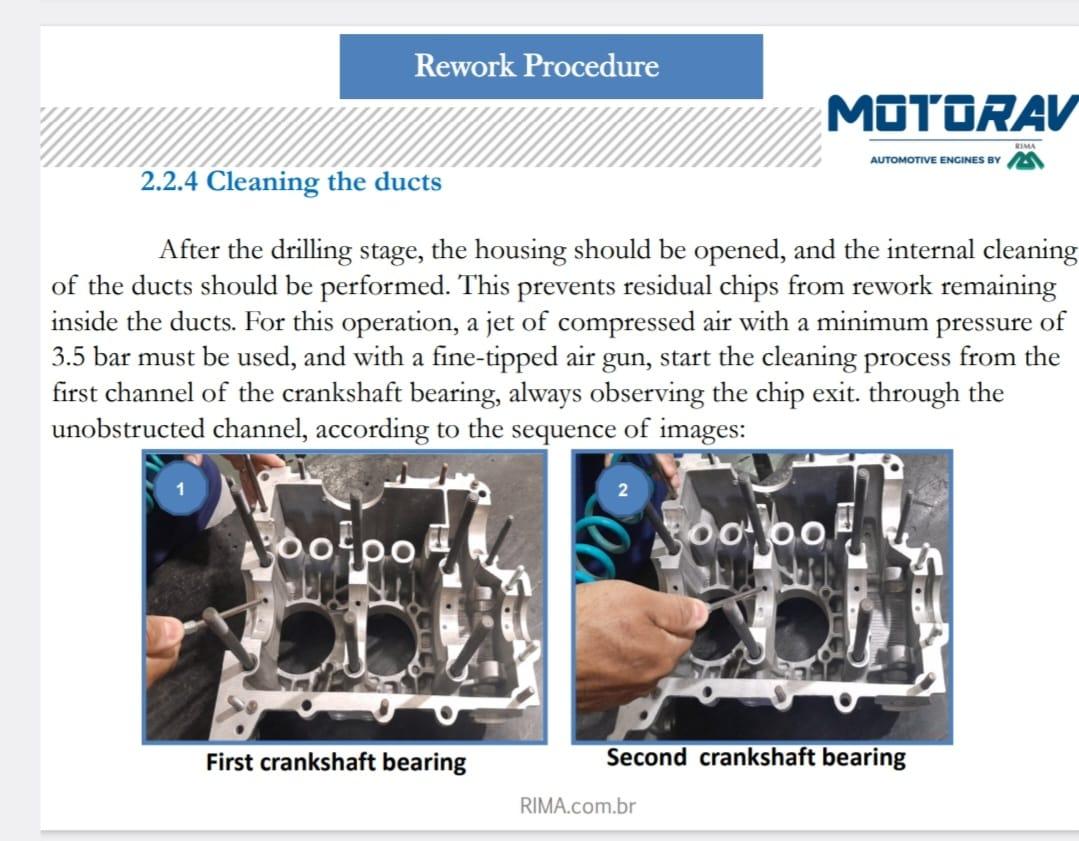

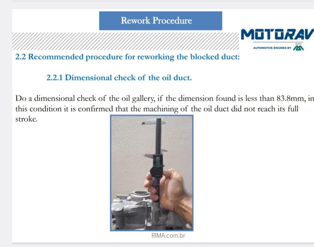

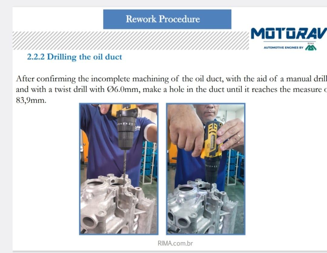

Here is the bulletin from Rima on the repair of the oil gallery that was not drilled correctly.
Greg posted this on Facebook and thought it would be useful here as well

It would be nice if someone on their end prefaced the entire documented process by clearly describing the problem, FIRST. The user (who is sometimes bone-headed, like me) has to deduce after reading the first couple pages.
Something better might be: "During the manufacture of cases from the period of blah blah blah to the period of blah blah blah, it was discovered that the drilling of the gallery that (insert bearing number or other purpose of the particular gallery here) was not drilled deep enough, resulting in blah blah blah, etc. As a result, the gallery must be opened up at the blah blah location plug and reworked to finish the drilling process to the required depth to effect normal operation of the engine housing (or, "case" as we call it)."
Did I perceive the problem correctly? I've never de-plugged/re-plugged a case, I've always crossed my fingers as to cleanliness and just been lucky, I think.
Sorry, just ranting as an engineer who has to write peer-reviewed documents for an aerospace firm. Wink

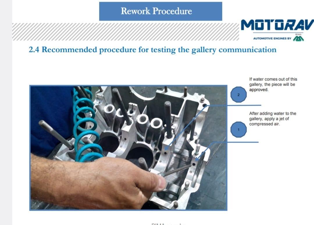

Yes you got it right, they did not drill deep enough to reach the oil gallery which feeds the #4 (pulley) bearing.
Sorry I didnt add more to the original post, the pages on FB had video of the inspection process of a case where the issue was found. Another poster who was aware of the issue and had the bulletin sent them to Greg via PM.
I got excited on finding this information and posted as soon as I read it.
I wonder if they ever found case "0" with the broken off drill bit lodged in the oil gallery.
What I find disturbing is that the distributors did not give this information to the public. Being that SCAT is on the import list and they purchased a huge amount of cases a year ago Im sure they have been aware for some time.

Appears a few of us got screwed, does not appear to be that hard of a repair to do except does anybody know where to get the sealing plug? Part 040 101 112 1 that is listed, I did an internet serarch and came up with nothing.

It's tough to read the dims on the plug, but it looks like 6.3 plug dia. in a 6.76 hole, should be 6.8, probably just can't see it clearly, I will make some plugs if people need some, PM me, I have a case here also for a customer he says his case is exempt.

Anybody that has a case on the list needs to do the qualifying test at the end of the instructions, I did mine that were on the list and they flow, no blockage. Even pulled an original case and the water / air flow out the third bearing oil port is the same.
Check em'

I would like to pull that plug out of the two cases I have even though both passed the water squirt test, unfortunately no access to replacement plugs. I did send an inquiry to Scat if this plug was available, no response. Then sent a request to Motorav for spares, offered to pay, even offered to buy in quantity if required. No response. If anybody comes up with source for those plugs post it.
