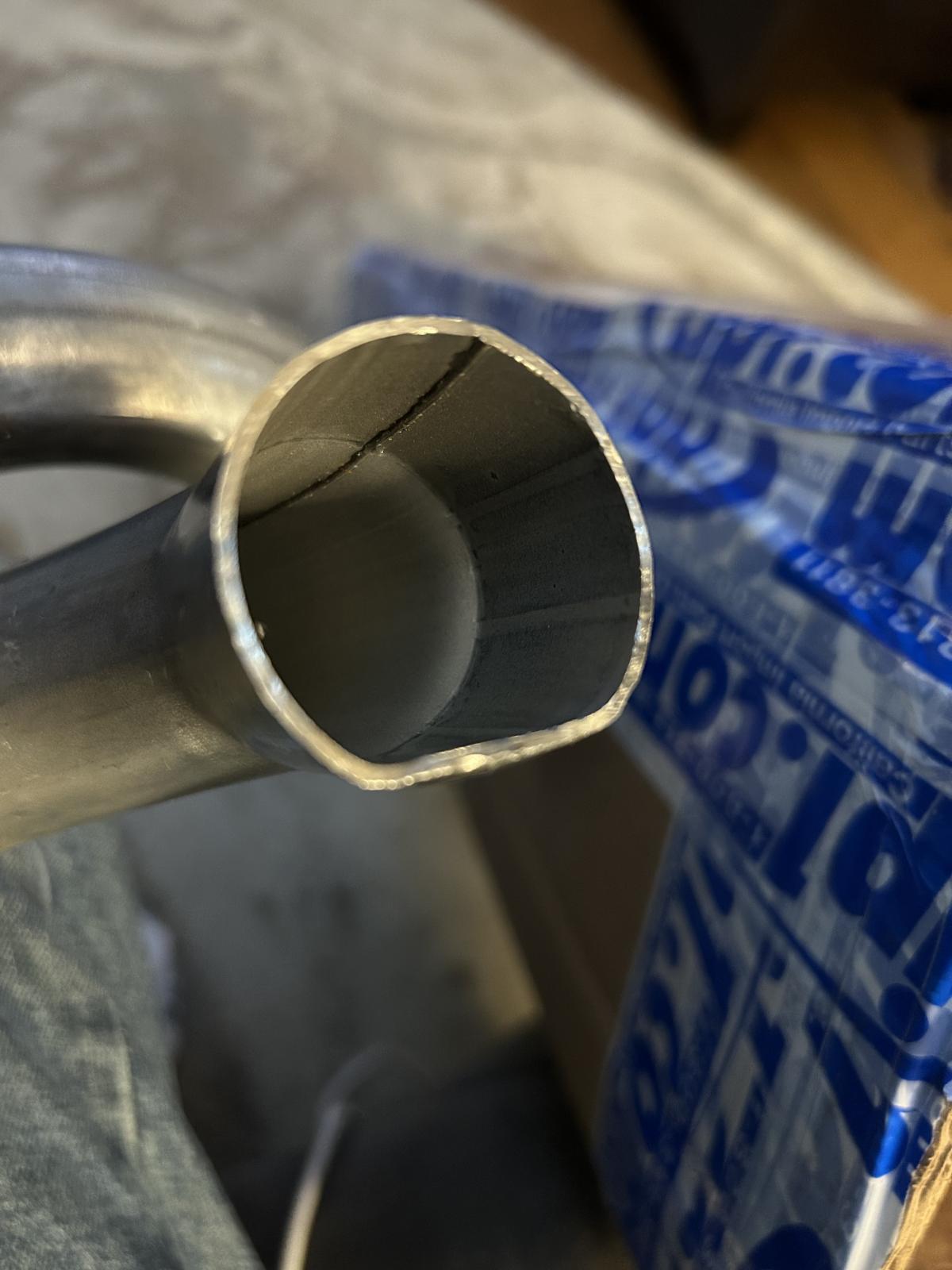

1979 muffler replacement……… well
I kinda don’t know what to do except try to get another gasket in the one two cylinder side to try to seal the flange !

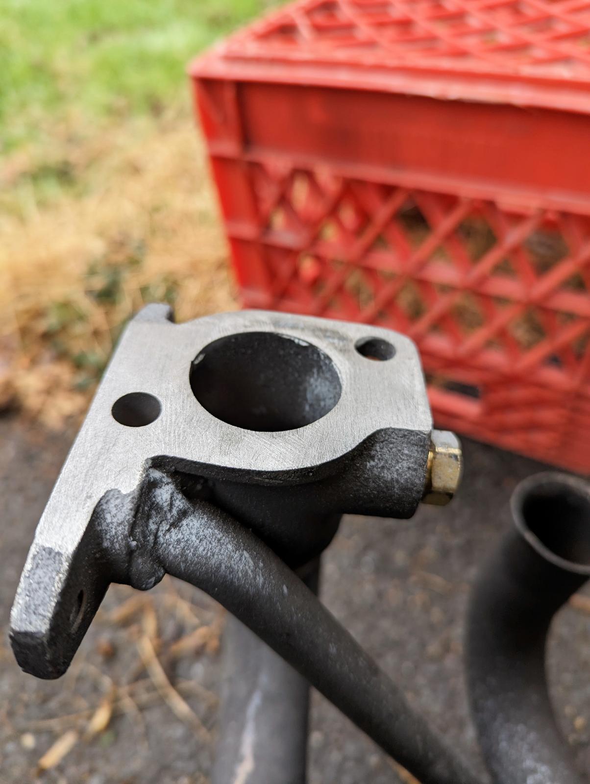

I had this problem w/a "new" (had never been installed) Thunderbird header on my '74. I had to take a couple of flat files to it and repeatedly test fit until it sat flush w/the 2 & 4 exhaust ports, confirmed it had sealed by doing the soap bubbles test, then finally by running it and seeing that the previous leak spots remained free of escaping exhaust residue.
3-4 side's leak pre-fix:
1-2 side header flange filed flat.
Click to view image

I spent a hour last night removing it and using a large table mounted belt sander to bevel the flange .
The round exhaust pipe just tapped out with a ball peen hammer.
Still when reinstalling it i bolted this side up first and noted the 3&4 side was out about an inch , springing outward .
I guess laying a level across both port surfaces on the muffler , or laying both on a flat surface ( table saw ) will show which is bent .
I ran out of gas for torch will get the tanks replaced in am .
I think a little heat will solve it .
Of course i will be very careful using the torch and
Wear safety glasses .
As well i will have a fire extinguisher handy , just incase .
