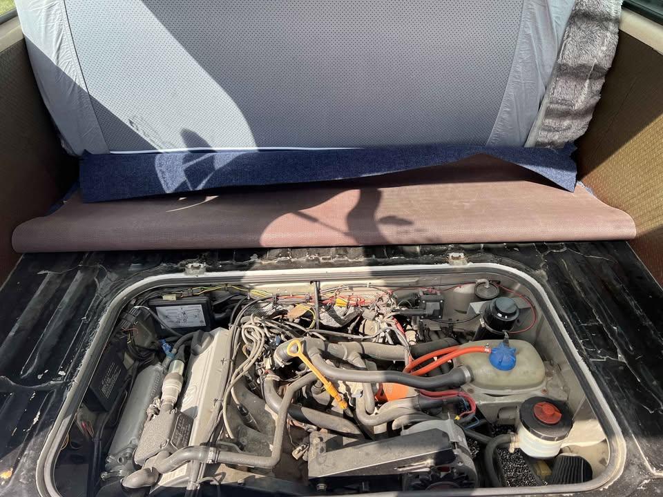

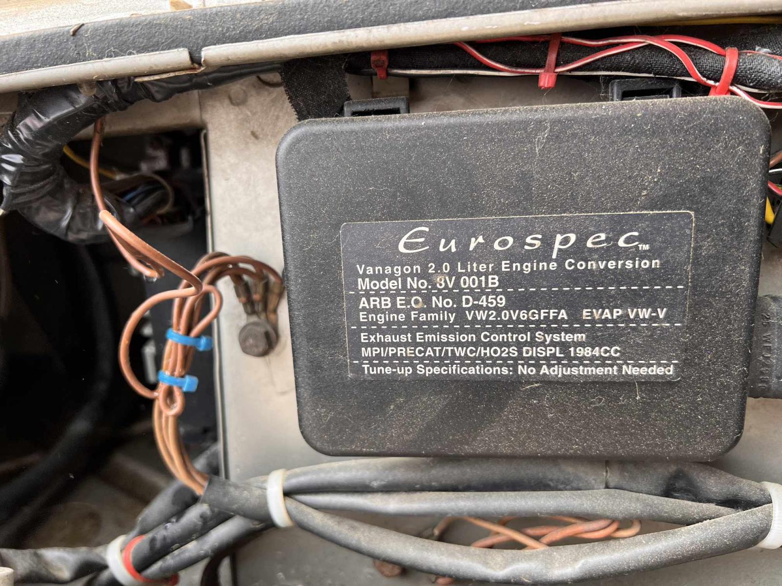

It's sporting a Eurospec engine swap of unknown age or mileage using (from what I understand) a factory fresh 2.0L engine normally found in an early to mid 90s Jetta and what looks like very good quality conversion parts. I will say that it runs great and has significantly more power than my '84 with its stock 1.9L waterboxer.

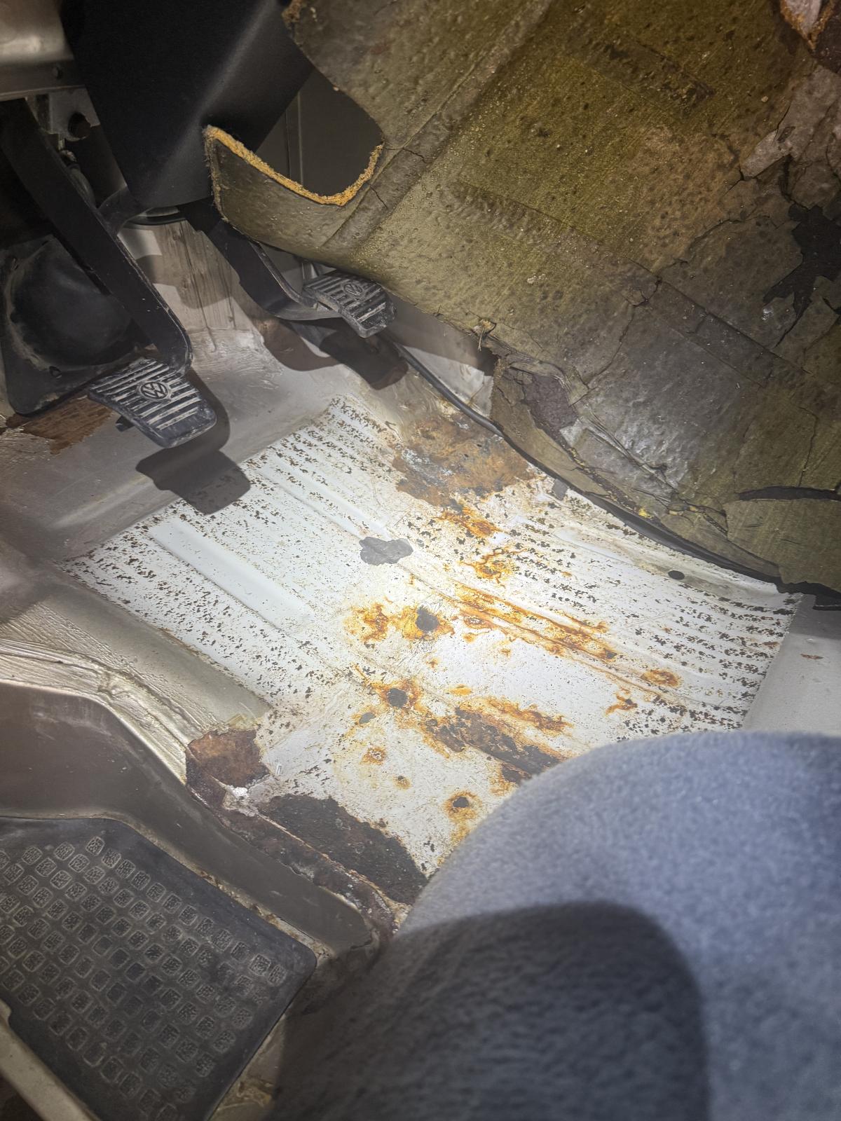

I got in a good work session today and straightened a few things out that have jumped out at me so far. First was the horrible alignment. I knew it must've been pretty far off on the test ride when it was all over the road and that the seller told me he had recently replaced all the ball joints and tie-rod ends and had tried to 'get it close'. I haven't looked at the caster or camber yet, but the toe-in was very toed-in. I did a quick and dirty adjustment with a tape measure and it actually handles pretty well now.

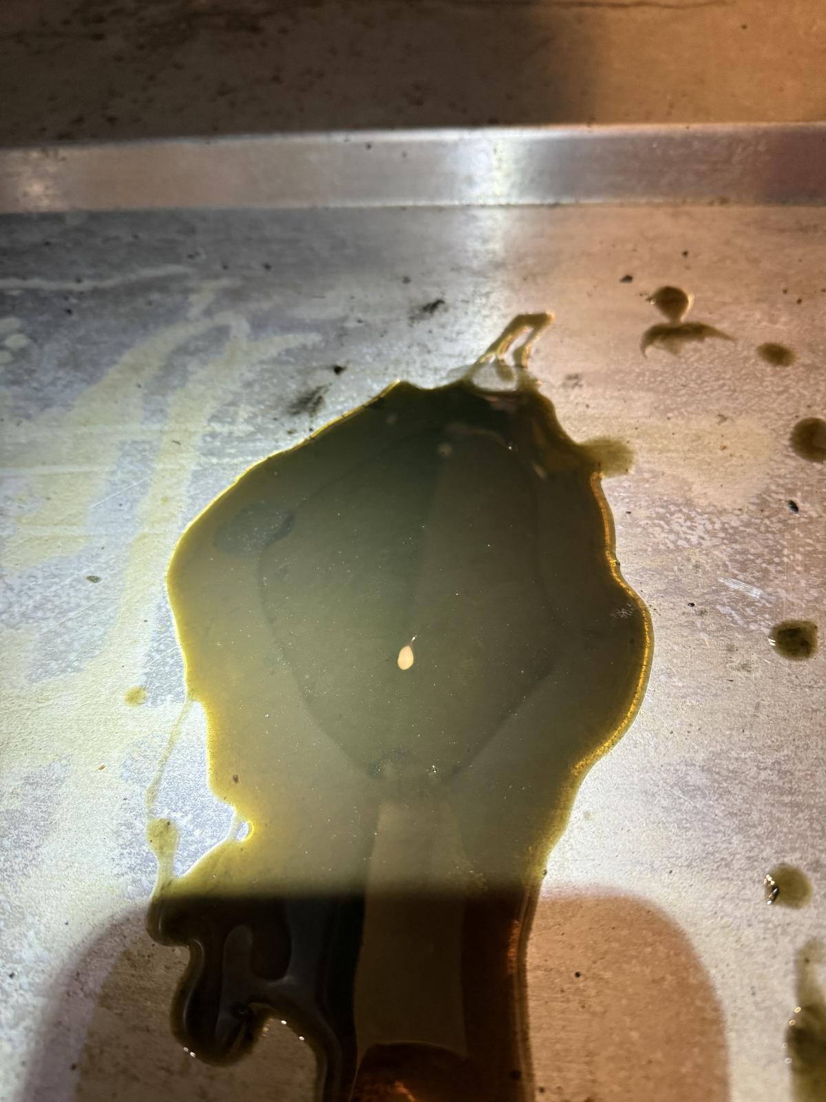

I also addressed a pretty severe gear oil/grease leak from the right inboard CV boot. At first I thought it was a torn boot, but turns out the center of the flange cap was broke out somehow. <shrugs> I put a couple new ones in my next GoWesty cart and RTV'ed the old one back in for now. Since I was under there I figured now was the time to check the oil level and see what the magnet looked like. I have to admit I was a bit nervous pulling it out, but extremely relieved to see it:

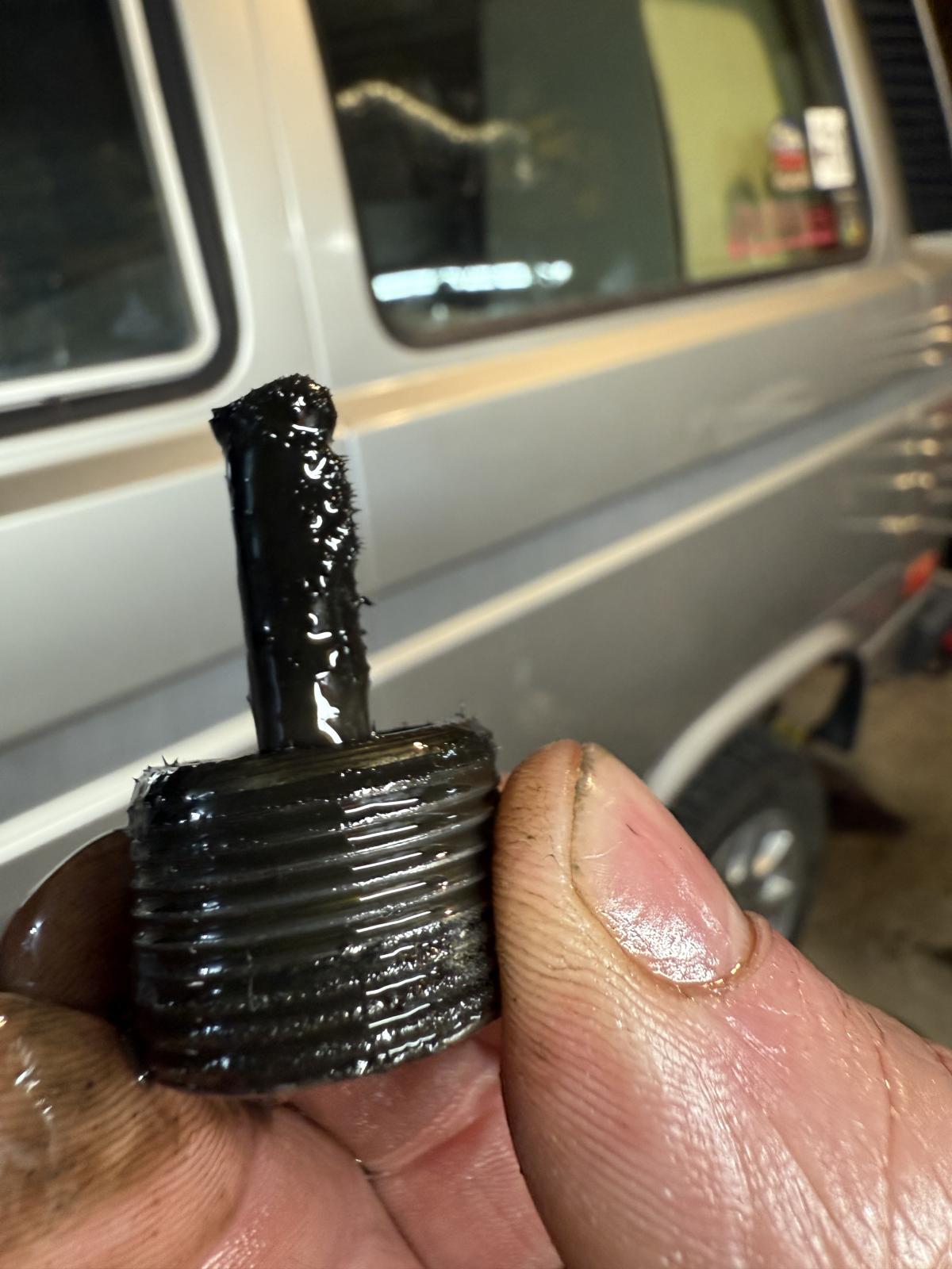

And a quick view of the oil that escaped, there was a little brass glitter but I'll take it:

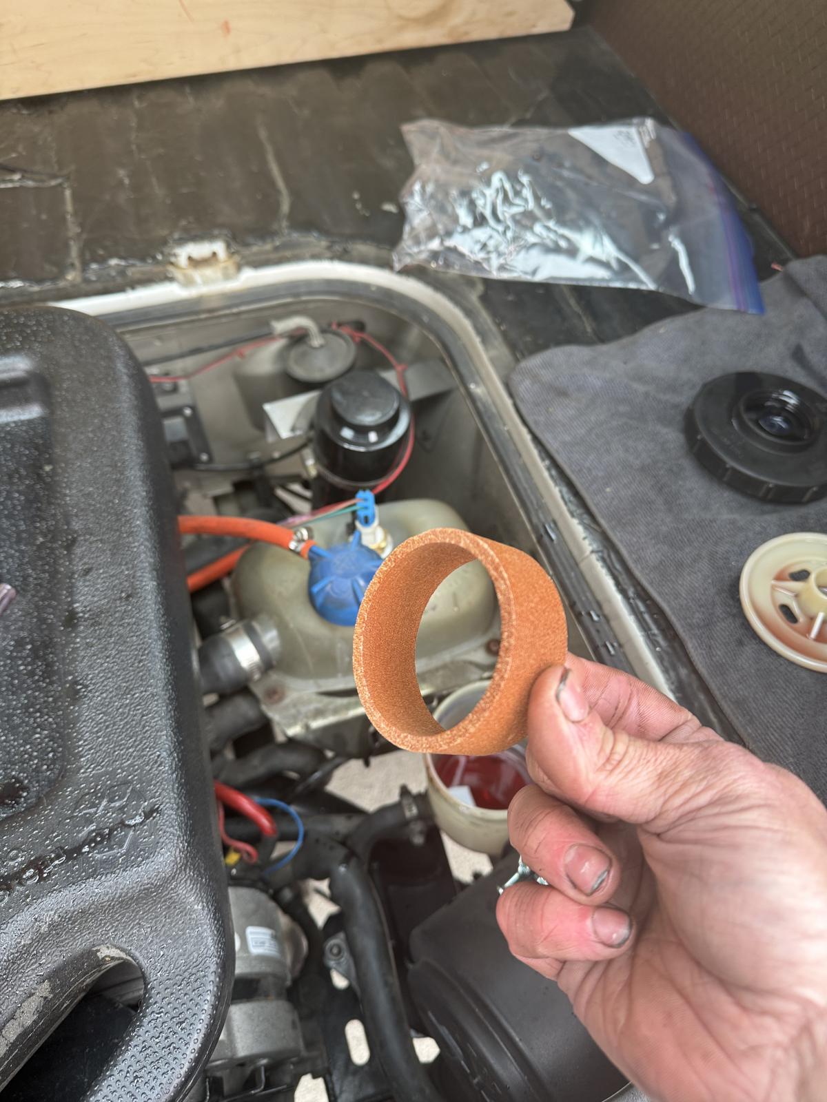

There is also some evidence that leads me to think that somebody has been inside the transaxle. Mostly that there a couple of seams that have just a little bit of rtv peaking out. I plan to pull it and the front diff for a rebuild and front locker install at some point in the next year or so. I also suspect that the VC is getting weak.

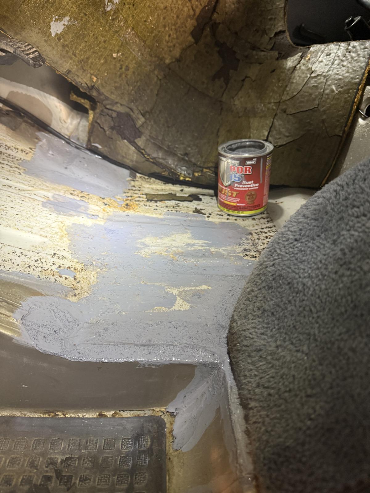

The other major issue I took care of was the loose and rusty gas pedal mounting area. Happily it ended up just being surface rust and dirt. I ripped out the sound-deadening (which wasn't glued down any more) and scraped and wirebrushed all the scale and loose paint. Some Por-15 rust converter/sealer should hopefully stop any further deterioration. Now if I can just keep the padding from getting soaked... Anyway, I decided to improve the pedal mounting arrangement. I added a couple of 1/4-20 riv-nuts (with a dab of JBWeld for good measure) and have a vastly more solid mount than the wood screws in the sheet metal it was before.

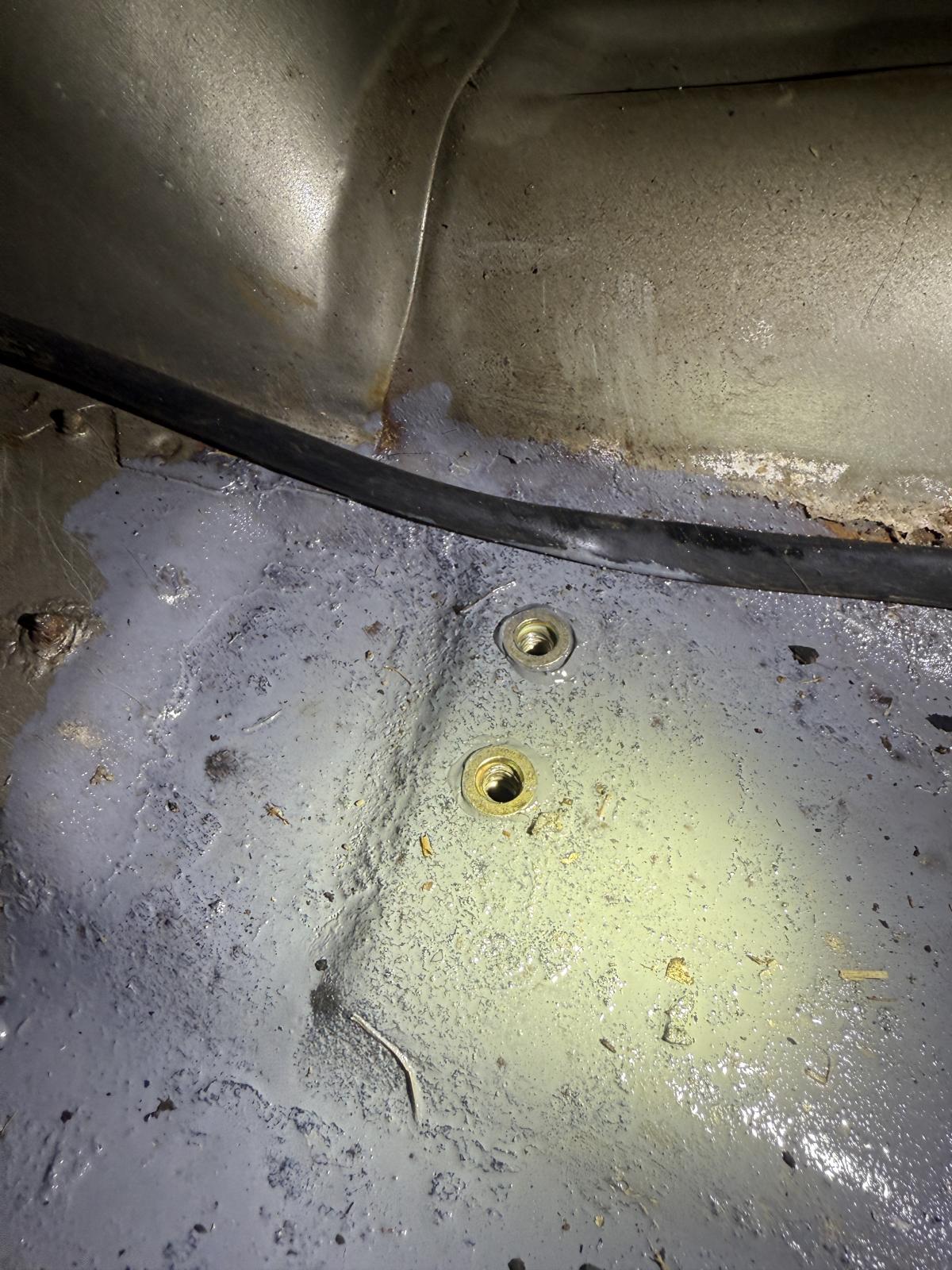

I see three hookups on the side of the van, are they for power and water?

And the story on the vent/hookups I got was that the previous-previous owner in Fairbanks was in the process of installing a Westy interior and never finished. I might try to patch those holes back up and repaint that panel, or just try to make sure they don't leak and ignore them for now. Who knows, maybe one day I'll come across a good donor for a poptop and a full Westy interior and finish the camper conversion. Cool
If the hookups are done well I'd just be sure they will not leak and leave them for another project. Solar hookup, compressed air port, electric cord hook up, etc.

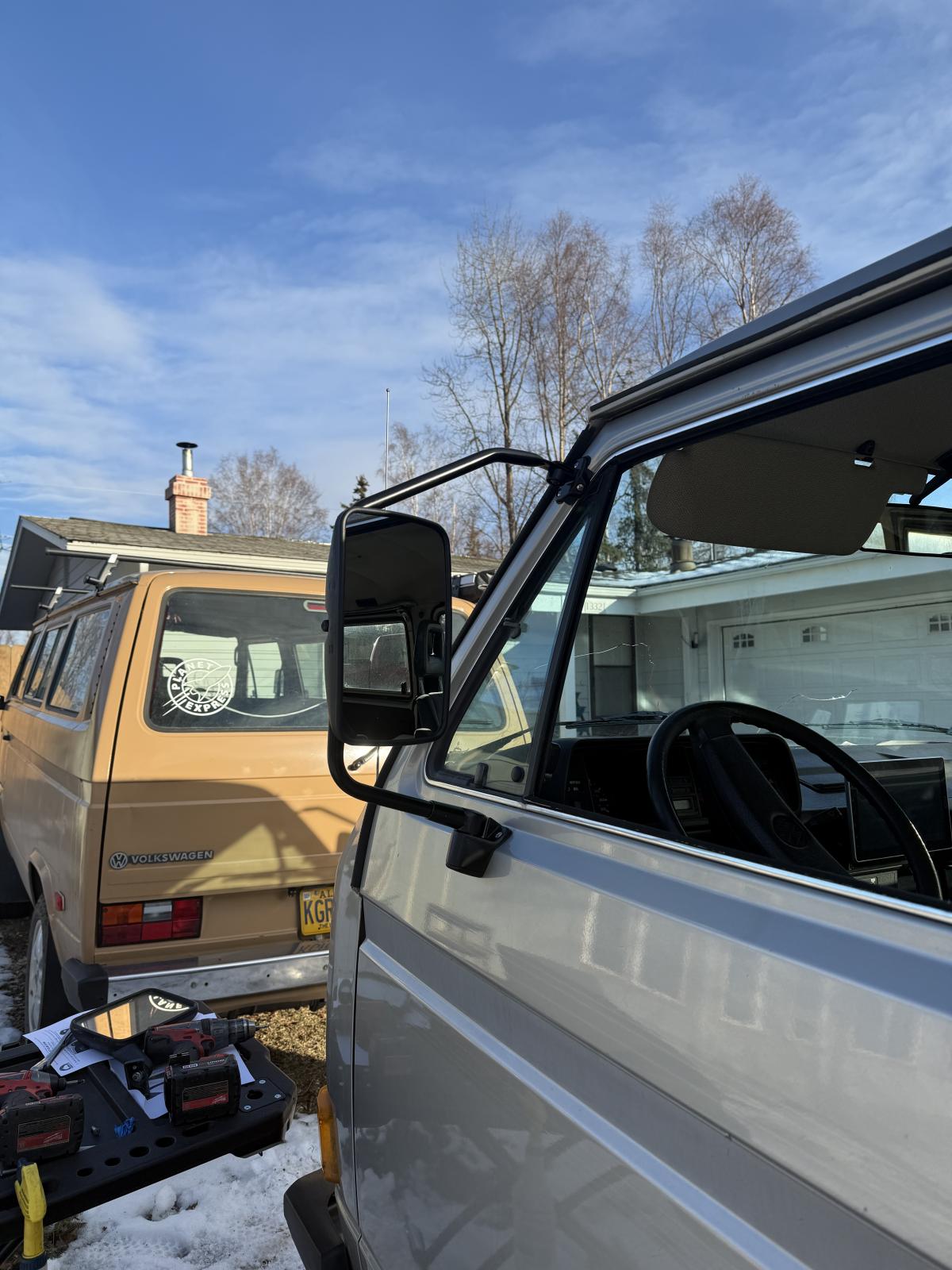

I've been wanting truck mirrors for a while. Cool

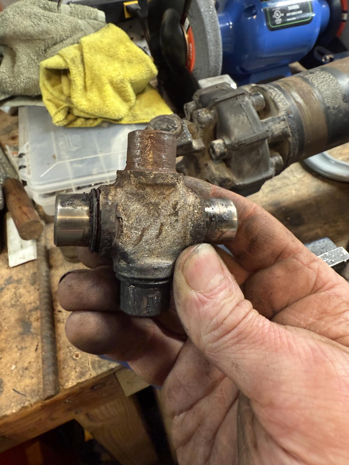

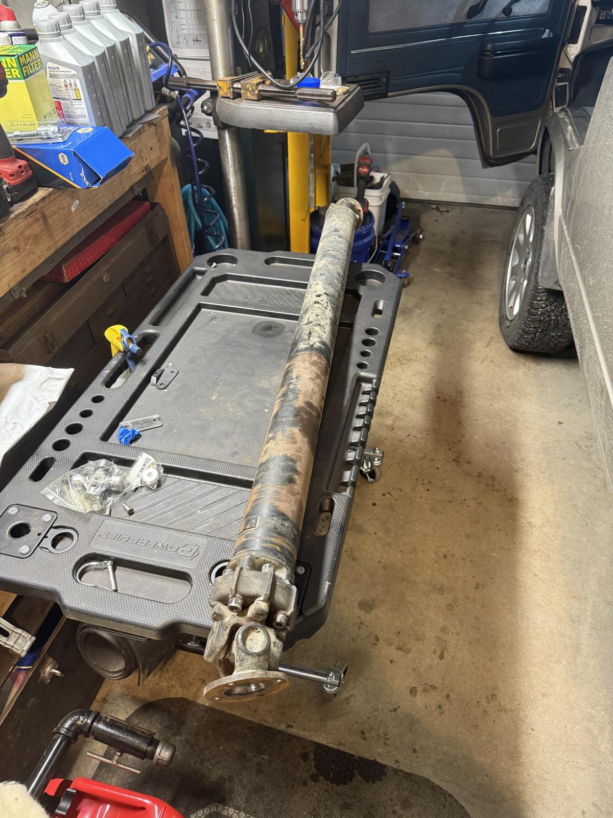

Next on the list in addressing the driveline vibrations. Never having driven a Syncro before, I didn't know what to expect, but to be honest, it felt like it was trying to shake itself apart above like 15 mph. I initially chalked it up to the engine swap throwing off the u-joint angles and crawled under the van prepared to move/remove spacers or even modify the engine mounting bars. Imagine my surprise when I found that the u-joints were out of phase! No wonder it was shaking so bad! I quickly unbolted the rubber donut from the main propshaft body and rotated the u-joints to be in phase. I did drive it a few miles yesterday and the vibrations were vastly improved, but still a there. While fixing the phasing, I noted rust/dust coming from around the cracked and partially missing rubber seals of the joint itself. After a little research I ran to Napa this morning and picked up a Neapco 813 which seems to be the most readily available pretty-close substitute. The caps are less of a press fit and more of a slip fit. I think its more meant for tractor pto work and less automotive. I did apply a little bearing retaining compound (what we use at the bike shop to keep "press fit" bearing cups in place in carbon frames) to help hold it in place and have my fingers crossed. While I had the propshaft out, I scrapped and cleaned as much of the unevenly sprayed on rubberized undercoating off as possible. Its probably not enough weight to throw the thing out of balance but every little bit helps, right? The U-joint I used is a greasable type with the zerk fitting in the middle of the cross which obviously won't fit. I'm testing an idea of replacing the standard zerk with a flush mount needle-type fitting. I'm hoping that by unbolting the propshaft and rocking the flange over as much as possible, there'll be just enough room to get a needle in there to pump some grease into the joint. Worst case scenario, I have to buy a whole propshaft with regular ujoints.

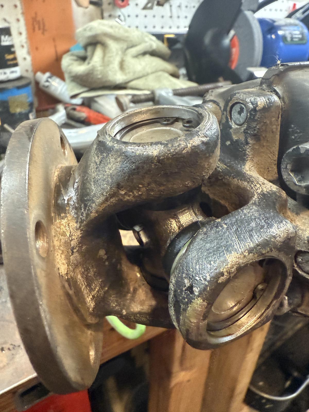

Oh, I also noticed that after unbolting the propshaft at the transaxle, I was able to turn it slowly by hand but the faster I tried, the more resistance the VC gave me. Can I assume that's a good sign?
Count your blessings. Sort of. That's why the guy sold it.
Usually the nosecone is broken when that happens and sometimes all the oil dumps out.
Sometimes it drops the driveline on the highway.
Out of phase?
So someone unbolted that rubber Guibo and put it back together in the wrong (of the six) holes?
There are brass bushings in there that go bad, and if they do, it prevents the driveshaft from being balanced. There is "legend" but I've never heard of a way to replace those bushings if they go bad. People have tried stuff, but was it actually quiet after the repair? I doubt it.
Did you check bushings condition and re-grease them?
The driveshaft vibrates at 45-50mph. Pretty easy to identify driveshaft vibration by the speed.
The rule of thumb that I heard from Syncro master Tom Lengyel: If at night, the headlights you see in the rear view mirror are little circles, you have to remove the driveshaft.
Look at a decoupler at Van Cafe. The core-charge for a bad nosecone is $1500. That's how rare nosecones are, they're unobtanium.
Vibrating driveshaft will ruin the nosecone.
Don't fook around driving a vibrating driveshaft or you too will be disposing of your Syncro, never to Syncro again.
It's a tight press-fit. Perhaps your yokes are damaged by driving it out of balance/offset by the ruined bearings.
That driveshaft sounds like a dangerous item to bolt onto this van.
Look for some balancing weights on your shaft. See how small they are? Imagine their weight .vs. the weight of the undercoating.
Undercoating on a shaft that spins 4,000 RPM can definitely cause vibration.
This van was owned buy someone who was clearly not checking in with knowledgable Syncro folk.
The Syncro was probably a nightmare for that owner.

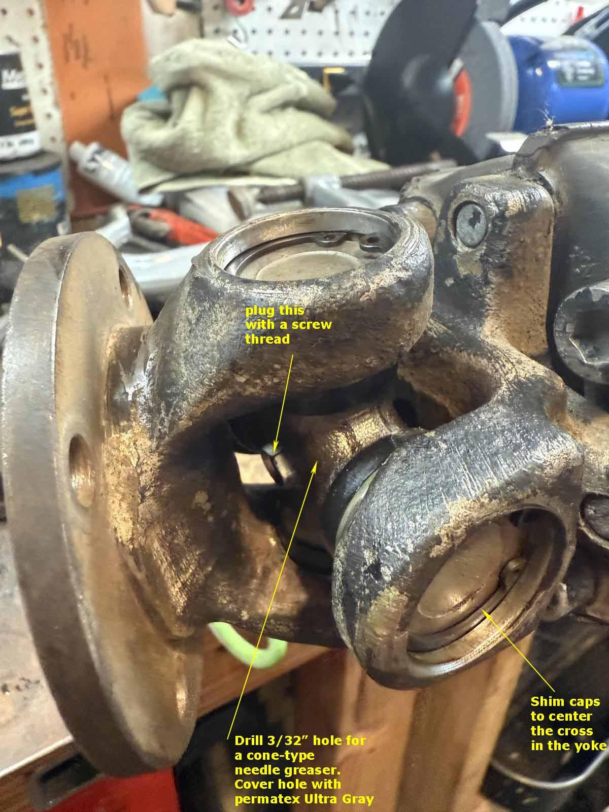

I bet drilling a 3/32 hole and buy a Plews-type needle grease adapter is better. You just jam the tapered point into a hole and pump grease in. Then wipeclean and cover the hole with Permatex Ultra Gray. https://www.thesamba.com/vw/gallery/pix/1591410.jpg.
I don't think there's much hope for that driveshaft. The yokes won't hold a bearing cup - there's no way to hold it "at center". If it goes off-center, it will vibrate and ruin stuff.
I'd go directly to that solution.

PostPosted: Sat Feb 22, 2025 11:22 pm    Post subject: Re: An Alaska NSYNCro build Reply with quote
Sodo wrote:
Out of phase?
Unless Syncro propshafts are different than everything I've seen about how driveshafts are setup, yep, somebody unbolted the guibo and clocked it 90* out. The inner yokes were not in-line when I pulled it. I'll look into how to check the condition of the bushings and regrease them, but the guibo/yoke spun easily and felt very smooth so hopefully its still good.
Don't drive at all if the driveshaft isn't smooth and quiet.
That's sounding more like wisdom the more I think about it.
I'll attempt a very short drive to work tomorrow (less than 2 miles round trip on neighborhood streets) and if there's any hint of vibes, I'll just go ahead and get a brand new shaft ordered. There's a decent budget for this project, so I should absolutely not be penny-wise and pound-foolish.
'73 Super Beetle (formerly resto-mod/rally look with a healthy 1776, currently in another round of resto with a 1641)
'84 GL adventure van project [sold] (1.9L, 4speed) https://www.thesamba.com/vw/forum/viewtopic.php?t=755844&highlight=
'86 Syncro tintop (2.0L Eurospec/ABA engine swap) https://www.thesamba.com/vw/forum/viewtopic.php?t=800194&highlight=
MsTaboo Premium Member
Joined: June 02, 2006
Posts: 4620
MsTaboo is offline
PostPosted: Sun Feb 23, 2025 11:40 am    Post subject: Re: An Alaska NSYNCro build Reply with quote
Yes.
Doing a true rebuild of the stock Syncro driveline is almost impossible without some serious work due to the internal bushing inaccessibility.
(edit, just to give an idea of the work: https://shufti.blog/?s=Giubo
Others have resorted to cutting the driveline and re-welding to access the bushing)
Replacing it with a slip yoke driveline makes life much easier, especially with an engine conversion.
I have a new in box driveline available for sale, but shipping from SE British Columbia to Alaska might be very expensive!
Of course once you have a good driveline the task of getting it properly aligned can be a bit of a challenge. Check out the various threads on Syncro driveshaft vibrations.

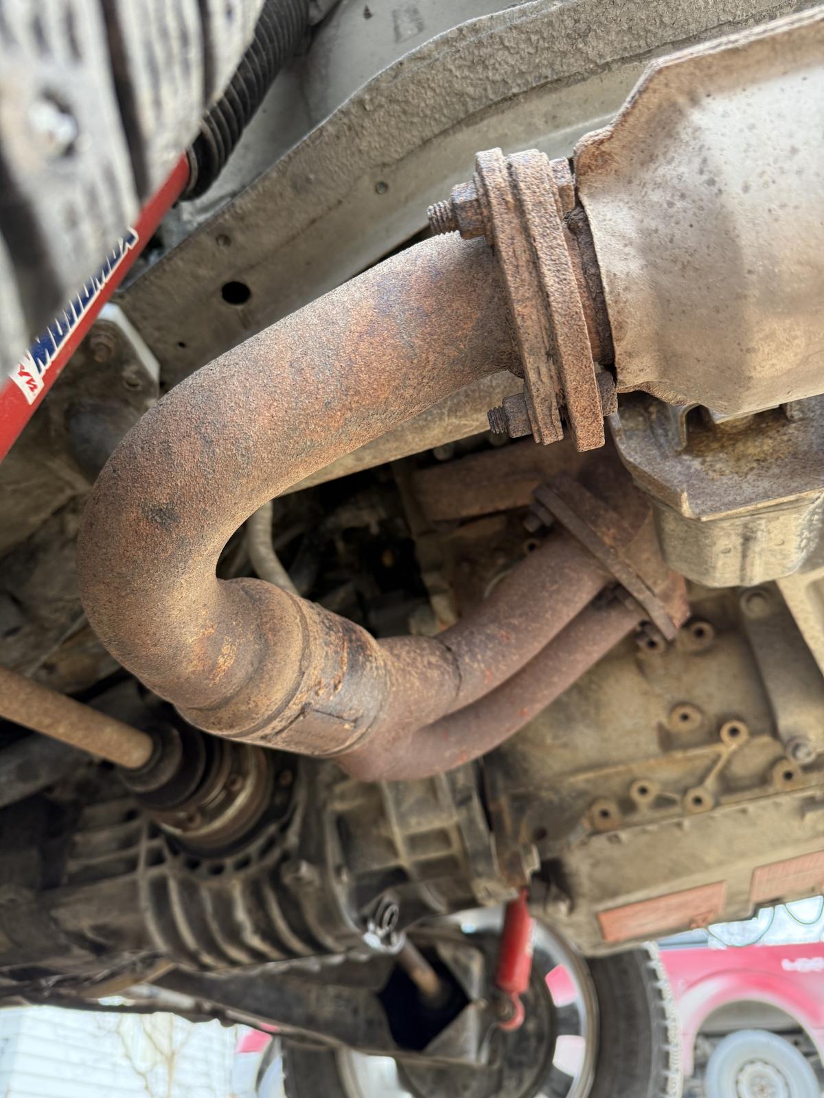

Anybody know if this downpipe/headpipe is still available?
I've reached out to FAS since they have a lot of parts and info on various inline 4 swap and they're looking into it (thanks again guys!) but I just saw that Van Cafe (and RockAuto it turns out) sells the 'correct' flange gasket but not the head pipe itself. They do list a really nice looking stainless steel header but its for a manifold with a six bolt flange, mine is four. Rolling Eyes
Unless by a small miracle the FAS guys get back to me with news that a new one of these is sitting on a shelf, I'm gonna pull it out and try to weld up the cracks. I'd like there to be the possibility of a replacement if I really booger this one up, but I suppose in the worst case scenario, I figure out what manifold works with Van Cafe's header and do some more upgrading. Laughing
