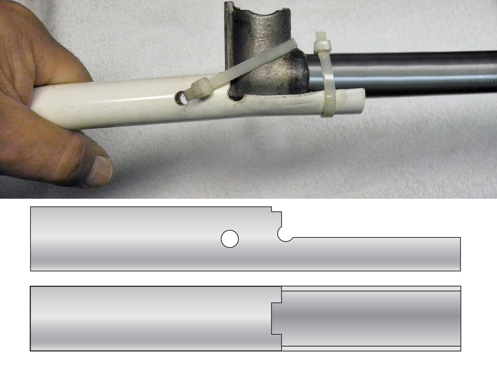

Make this tool to assist in getting the shift rod out and back in the tunnel.

67rustavenger wrote:
I have never encountered the can't put it in gear with the engine running issue.
That said, it wouldn't hurt to change the shift rod bushing.
Good idea!!

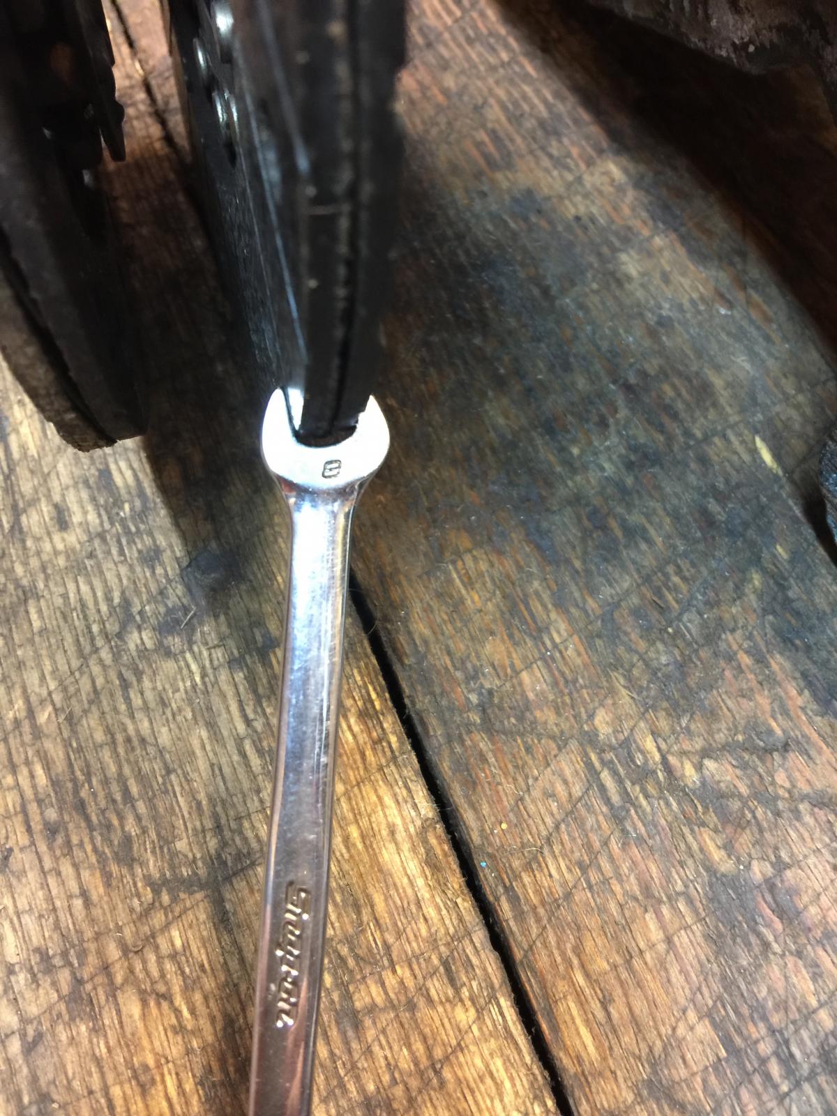

The spec for the disc is 7mm thick, if I remember that correctly. I can recall pulling out my 7mm wrench to check them when ever I would do a clutch job. There was a point back in the early 80s when an after market company was producing 8mm thick discs that would not release. It is a quick check. To be sure you could use a caliper to verify.
IIRC, minimum spec is 7mm while new is 8mm. Snug fit with an open end wrench measuring method works well (pic courtesy of Zundfolge1432's gallery).
I also remember checking disc thickness with my 7mm open end wrench, and that is the "replace now minimum thickness". I cannot remember ever measuring the thickness of a new clutch disc myself.
I only did when they started being manufactured thicker than 8mm. Lots of cars came in, from DIY mechanics, on hooks due to “not able to be shifted.”

This happened to me with my 63 as well. I was getting it back together, fresh engine rebuild, new clutch..etc. Turns out the clutch disc was just a bit too thick. I bought another disc, problem solved. The new disc was just a bit thinner than the one I had. 18k miles later, still going strong. Just a thought
I measured the clutch, 8mm has a bit of slop. 7mm won’t fit.
My 11/32nd wrench fit nicely over both the old and new clutch I bought.
