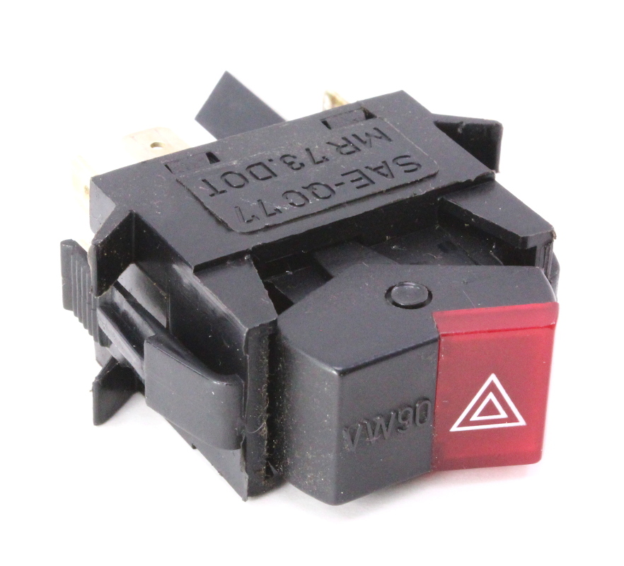

Well, I'm in need of a new emergency flasher switch that goes on the odometer cowling of my 90 vanagon.
I was tidying up my dash work after tracking down the bad ground on my steering wheel, I'd reziptied the leads and put the dash on.. went to pop this sucker into the bezel..
But.. the damned switch came apart in my hands! omg!
Lookin at Busdepot, Vancafe and GW.. I cannot find this damned thing with standard word searches..

part number #175-953-235
no longer available.
there's a bunch in the classifieds.

Oddly.. I just had connected it confirmed it works just fine.. it is only damaged because I forced it, and the case came apart spilled its guts on the floorboard.
Any confidence if I might be able to pop it together, and plastic weld the case back together.
I just welded a Audi bumper.. and have a plastic welder...
I've done crazier things.. like modding a 1.9 to a 2.0 ALH into my van..
This will not stand in my way.. damnit.. I'm like seconds away from driving a 3 yr project in my driveway..

Are these the correct switches?
https://www.thesamba.com/vw/classifieds/detail.php?id=1995406

It looks to be!
Thanks!

Sometimes switches that fall apart at the seams can be glued together or even zip tied back together. I have zip tied headlamp switches for old bugs when the board was worn away where the metal tabs hold it.
a photo of your damaged switch will be helpful in obtaining repair ideas

@EverettB, Thanks for the guidance! Doesn't that kinda defeat the purpose of using those attributes to search "Parts Vanagon"? Odd.
0-50, thanks for the vote of confidence here.. Self repair is the game we're all here for!
I am glad that I learned to repair things at a very very young age.. It makes me a hacker of things.. a modder, but certainly.. not a cheapskate!
A photo of your damaged switch will be helpful in obtaining repair ideas
The issue seems to be where the backing plate/casing clicks into the main switch body housing where those little rectangular notches click/lock into the housing, the guts went flying onto the floor.
The casing is not broken, its popped apart. On inspection of the wear points on the backing plate, which has a resistor on it, and the spade terminal connectors.. I've never seen the inside of this switch, but apparently I'm missing a metal piece..
I do have a very nice Plastic welding kit.. so no zipties.. but melting that case plastic together would be a permanent fix!
Its a nice day out, so hopefully I'm back in action, without having to buy anything.
Thanks,
Alex

VW Parts gives a different number for the emergency/hazard flashers switch.
171 953 235A listed for 84-91 Vanagon.
That is also the number on all 5 of my spare switches pulled from Vanagons.
https://parts.vw.com/p/volkswagen__/Hazard-switch/54411203/171953235A.html

Add a dab of silicone dielectric grease on the sliding contact when you reassemble. This reduces wear. not sure if a zip tie can be used here seeing as how it needs to be installed. Glue or weld, if you can find the missing part that flew away.
Weld can be done perhaps with a hot solder iron

No love on that part.. I dont even know what I'm looking for..
It seems it would have a couple dimples in it like the other.. it looks kinda like a staple, and a spring sits under it..

I HAVE.. seen those bulbs melt, and it likely is a call to replace it, and avoid the (shhhh) fire department thread.. egads.
Amazon does have a push button design that I could go to.. it looks just like the flip switches on a MK2 golf..
And.. it fits into my (about to be) dash mounted 8 gang switch panel.. I replaced one with a momentary for the freight train horn..
The hazard is a nice update in functionality, visibly, they also have a ton of function specific switches which I'm glad to see they released.

Well, it surely seems there are some options
https://www.carparts.com/details/Volkswagen/Vanago...lsrc=3p.ds
URO parts are Okaaaay.. but.. hmm..

Thanks.. cant find the all the guts, seem to be missing a second contactor piece.
It looks like I'm going to be ordering..
I'm cheap. if that switch is like 8$... I'd snap that up if it would fit the 90 guage cluster spot.
mmm, Might you or anyone you know of put that in, and have any feedback?

PostPosted: Sun Mar 16, 2025 10:52 am    Post subject: Re: Emergency flasher switch Reply with quote
Part number for the early vans: 175-953-235
Part number for the later vans: 171-953-235A
Either will work and both are NLA new. Just bought a used, (alleged) tested and working 175-953-235 on eBay as a backup... just in case.
