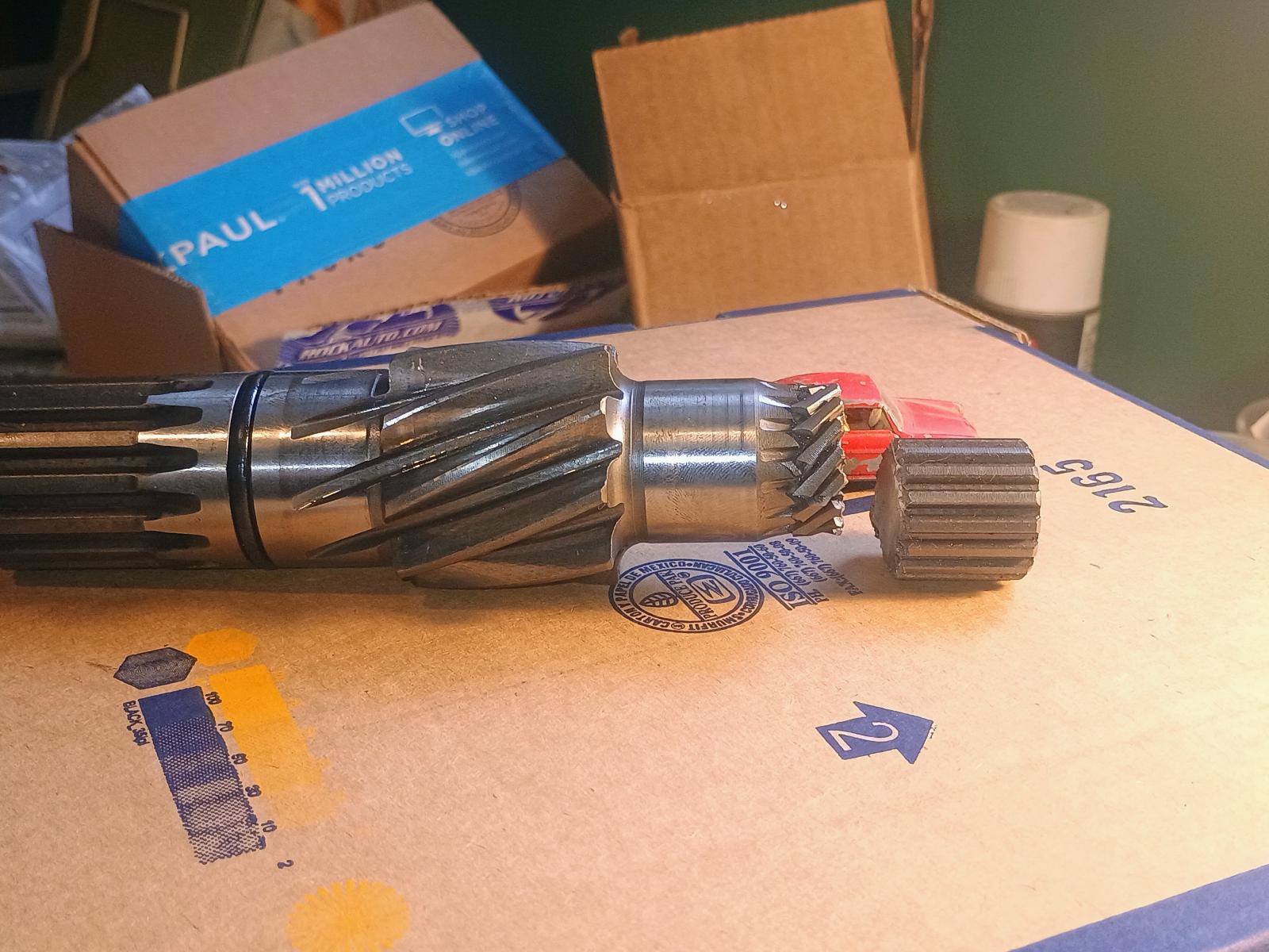

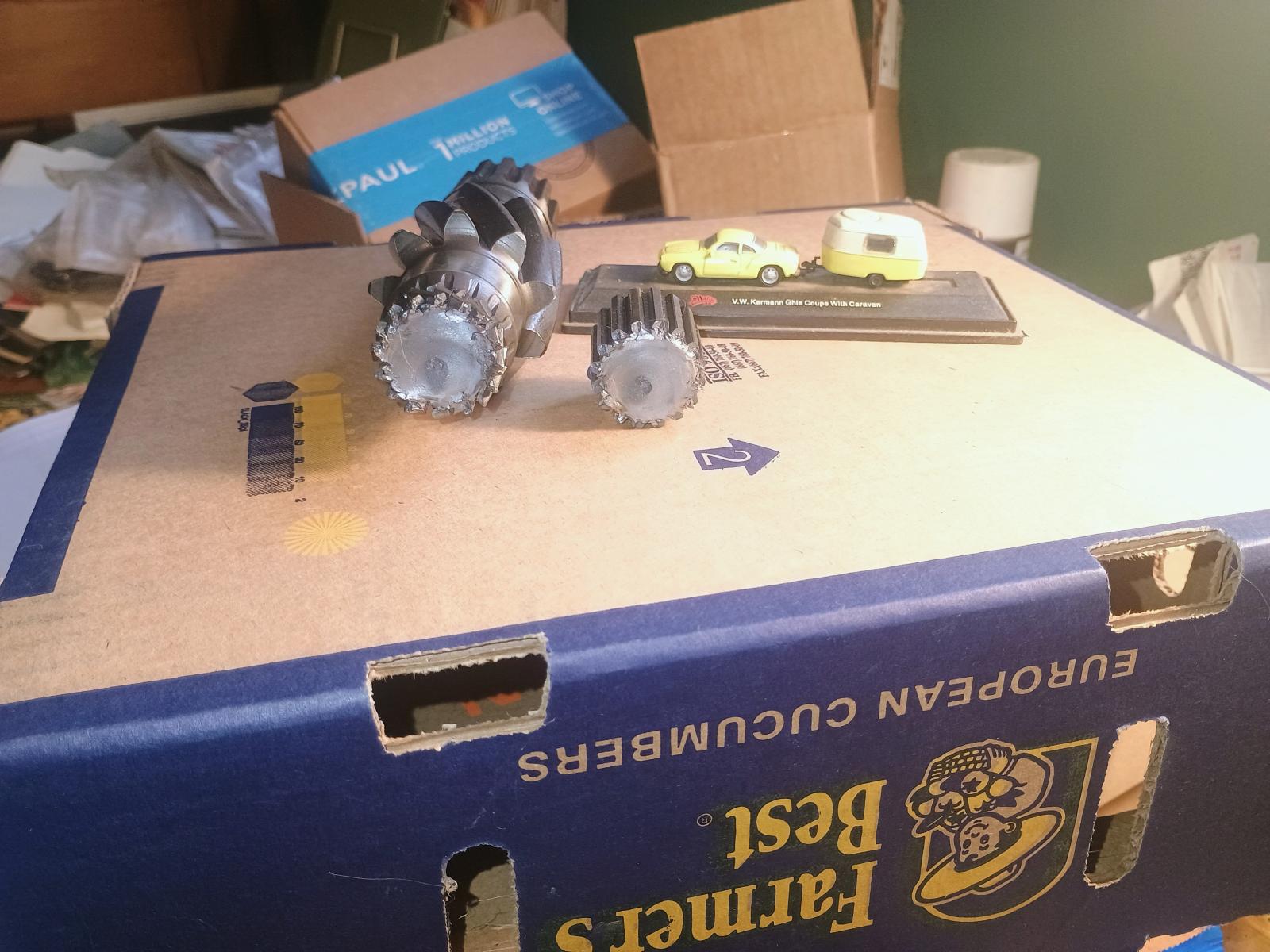

Here is what broke.
Any idea of cause?
Should I replace other side as well?

2 things generally cause that, and it's all shock loading related. like clutch dumps and wheelies (or being really really stuck and trying to 'rock it out') or a sudden stop under power. think of a baja hitting a jump at 50 but the driver never lifts off the pedal...once you hit the ground bad things happen

Shanks for reply Mr skills (token)
Replacement part. Coming friday. We shall see.

Wow! I didn't know those 3 cylinders could do that! If it happened all at once and you didn't have your diff locked the other side is probably fine. If the damage is cumulative like from pushing snow or dirt and engaging forward drive while the tractor is still rolling backwards your other side is probably looking like a barber pole too.
