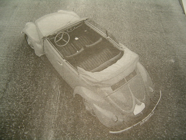

In high school I had a book showing Ferry Porsche’s turbocharged convertible VW38 but I have never seen or been able to find any information regarding this vehicle.
Do people know where it ended up?’
Have any pictures?
Know the details or have info on the turbo engine?
Pictures?
For 30 years I’ve wondered what ever happened to this car, it would be nice to finally know.

No turbo... It was equiped with a Compressor.
Zelensis, glassfibre body made in Belgium , disigned and built on a VW platform About 25 body's built.

the supercharged cabrio
assumed to be the same car pictured after the war with grooved chrome bumpers circa 1949

It also wasn't a VW38. It was several years later.
The Supercharger/Compressor was driven directly off the crankshaft and was located under the bump out on the apron.

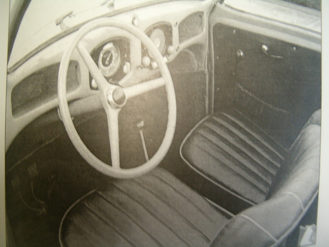

Yes, it was later, but at least one "Ferry vert" had no warm air outlets at window frame. So probably that car was a VW 38, I think. Or maybe more than only one vert with "blower" was around.

Ferry Porsche's cabrios have been discussed at length under different headings in this forum. The list by Ulrich von Podoll has two cabrios listed under VW39, however chances are they were based on older bodies (VW38). It seems that early KdF Wagens (Wolfsburg built) were also converted into cabrios. Because these were experimental cars, the supercharged engines could have been fitted and removed at different times. The entire history of the supercharged convertibles is pretty murky at best.
Records state that there also was a Cabrio-limousine (sunroof car) with a supercharged engine belonging to Dr. Anton Piëch.
These are photos of one of the cabrios, likely based on a former VW38 body.

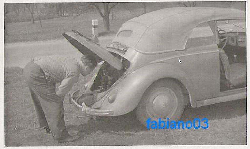

barber's book says it was a Roots type, just visible between the valance and the exhaust strut
to me ferry's car seems a lighter shade than the 'russian green' on the 356

It would be cool to see pictures of the intake manifold and how the belts are connected to the crank pulley ...

I assumed it was a direct drive off the crankshaft given its position...

And it is offset to the left. The one on the cab was in the center. As Finster said, it would have been direct drive given it's location.
Edit: Actually I take that back about it being direct drive.
In this picture you can see what appears to be a small pulley attached to the crankshaft. That would put the blower further down into the hump. If it were directly attached, it appears that it wouldn't fit in the hump as it is pictured.
You can also see cuts where the apron meets the body, so they must have had the apron setup to be removable, which would make sense.
In this picture you can see that it sits lower than what would be the crank centerline. You can also see the mounting system for the blower. Pretty interesting stuff. Question is, is the blower round or oval shape?
