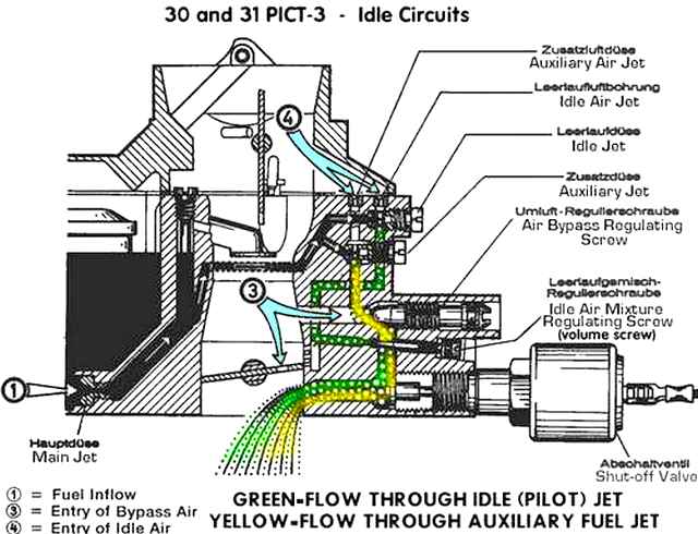

How have you adjusted the throttle arm screw that rests on the fast idle cam?
It is very common to mistakenly think this screw is adjusted to control the fast idle speed/rpm. This screw on the 34Pict carb is to adjust the warmed up throttle position which needs to be fully closed but not resting on the walls of the carb throat. Basically, loosen the screw so it doesn't touch the lowest level on the fast idle cam; screw it in until it just touches the cam; then screw it in another 1/4-turn to keep it off the throat walls but still closed. When the choke is fully warmed up and the throttle fully closes... ALL air-fuel should be flowing thru the bypass circuit around the closed throttle plate. See below pic.
The volume and bypass screws control flow thru the bypass circuit. If you adjust the throtte plate open any amount so air flows past it at idle when warmed up your bypass circuit becomes less effective. This sounds like what you have?
