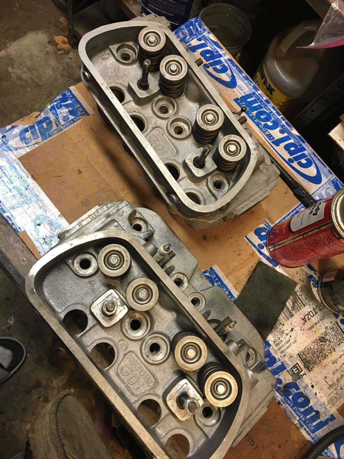

Have a set of near new older Auto Linea DP heads. There is a broken outter fin on each head. Building a stock 1600 DP driver. Should I use as is or ?

Don't worry about it.

The early GO1 castings are pos heads. Take picture from the intake side for identification
https://www.thesamba.com/vw/forum/viewtopic.php?t=435993

I would not use those heads either. Seats and valves are trash and since 3 of 4 spark plug holes have inserts I wouldnt trust them for even stock rebuild.
Will it run? yes but for how long is anyones guess.
