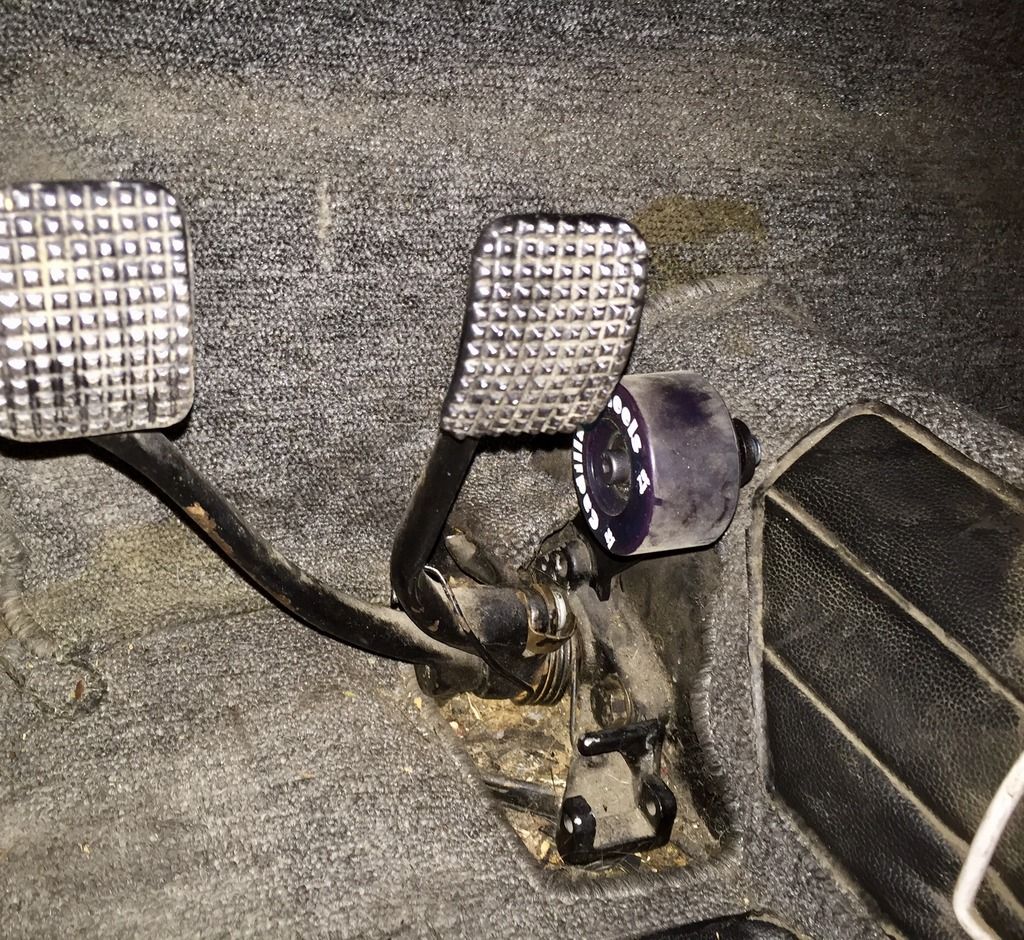

Try the roller pedal it works

I have one. When I’m wearing boots I’ll still manage to hit both every so often during a drive.
