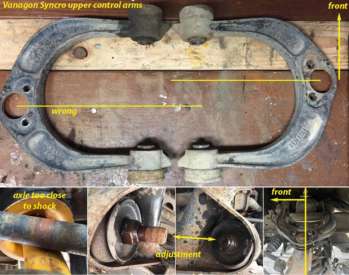

Two possibilities:
Pray that its the UCAs upside down.
Other Twisted Evil is even less fun.
You may have the left-side Foxshock on the right side.

That's not is. At least I don't think so. I'll take a look. I have a ride height issue. The axle to shock body is okay. It's the adjustable spring cup. They need to be adjusted away from the axle a bit. I thought I had enough clearance but there are noticeable rub marks on the axle. It must be when turning or in compression.
I'm planning to pull out the spring compressor and adjust them up a couple of turns.
To make things worse, I had a local shop replace an axle and they put one on with a fatter hollow body axle. I need to get that out of there before there is additional damage.

I just checked the UCA. They are mounted correctly. They are Burley control arms but that shouldn't matter.
