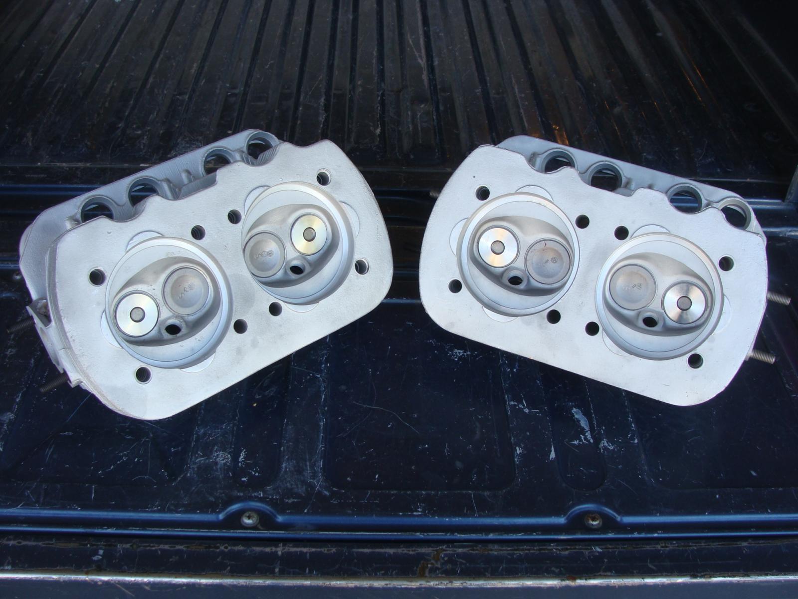

Snoopy1971 wrote:
When I was reading the page that mentioned the pistons, I was wondering what heads you used, but then realized you reused your OE heads ... holy cow they look pristine, they were so clean looking, I thought they were new!
I also could not believe that the local VW machine shop could do such a great job on my cylinder heads, https://europeanautomachine.com/. Each also had two exhaust studs that were off-kilter after I drilled and re-tapped to 8mm x 1.25mm for new studs after they broke off after Mrs. Cusser backed into a parking block. So those were fixed right too.
Before machine shop, after a decade of sitting outside
After machine work

Snoopy1971 wrote:
Looks like they offer 2 diff stock heads ... one made elsewhere that MoFoCo dresses up, and one made in-house ... both same price.
https://www.mofoco.com/item/New_Type_1_Stock_Dual_Port_Cylinder_Head/4251/c152
https://www.mofoco.com/item/Mofoco_040_Dual_Port_N..._/237/c152
Thank you for your insight!!
Buyer beware!
https://www.thesamba.com/vw/forum/viewtopic.php?t=224339&highlight=mofoco
Consider Tims Super Stock heads if you want to build a 1679 (1688) whatever.
https://www.performanceworkshop.net/cylinder-heads
Buy Once, Cry Once!

Yeah I had a few friends tell me if some horror storries they read online about Mofoco stuff so I decided to steer clear.
I ended up putting my order in online from AA for their 1688 top end rebuild kit
