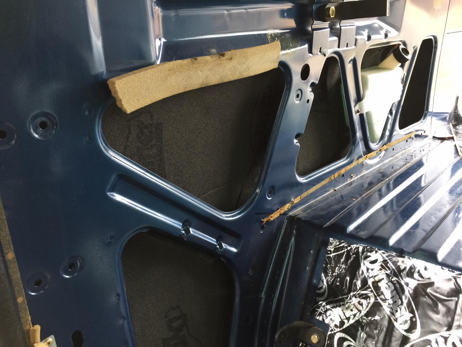

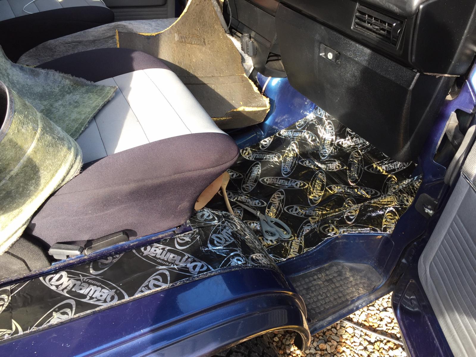

Over the next year and a half, I added several mods and improvements, eventually deciding upon the most significant modification, a brand new, zero mile Vw tdi (pd bsw) and rebuilt, regeared 4 speed manual transmission with limited slip. My mechanical abilities are slim to none so I have entrusted the fine gentlemen at Foreign Auto and Supply of Harpswell, Maine to do the conversion. The van is currently nearing the end of the conversion process and I have many photos to share.
For longer road trips I added this swing out iPad holder that seems to work from many positions whether you're sitting or lying down in the back and works great for the kids in their car seats
Photos of the van with a few accessories but pre lift springs and shocks. The factory, lower suspension of the multivan wasn't going to work on our driveway or the many, long dirt roads near our home. The first time we drove her home she bottomed out on the bump at the top of the driveway.

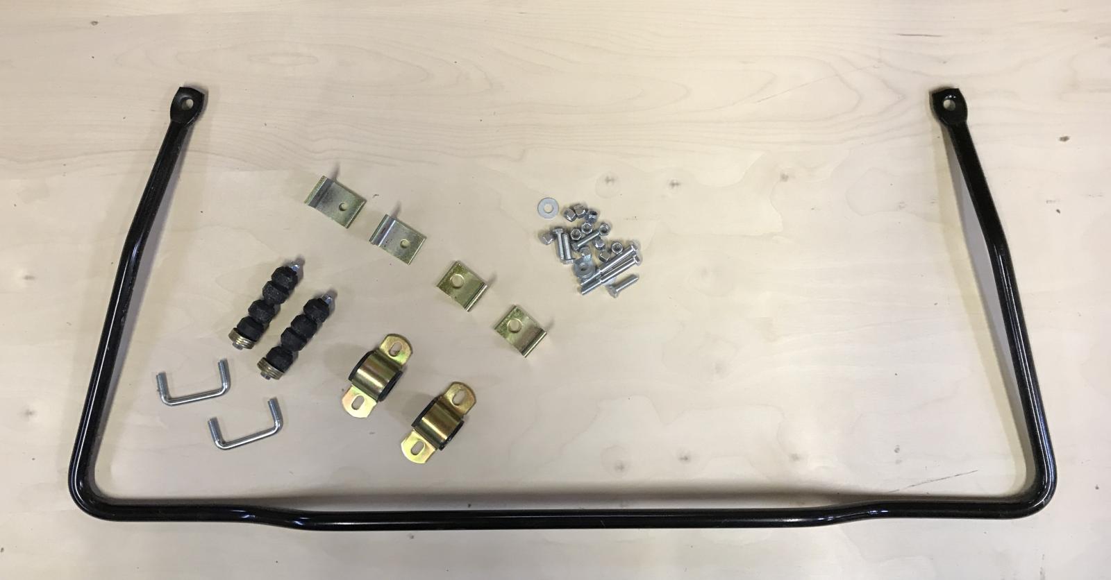

After changing out the fuel lines my next order of business was to get rid of the original headlights and upgrade to the h4 and h3 headlights and South African grill. I also added the gowesty 2wd all terrain suspension bundle, including fox shocks, 1.5 progressive lift springs and bfg all terrain 215/70-16 tires. I also installed the addco 1" front sway bar. I also purchased a rear sway bar but have not installed it yet. I am waiting for the conversion to be complete to see how much ground clearance I have. The rear bars seem to hang a little low and I don't want to compromise the ground clearance.
Addco rear sway bar. The addition of the larger, front sway bar definitely improved cornering. The van doesn't feel as top heavy when going around corners. You can actually feel the torsion of the bar kick in as soon as the van starts to lean outward of the direction of the corner and then the inward side starts to lean into the corner. For anyone contemplating a bigger sway bar I would definitely recommend it and say that it is worth the time and effort.
I also added a Gary Lee rear ladder and small luggage rack, Yakima roof racks, an ARB awning, Rocky Mountain westy tire carrier, road shower and during surf season, a rmw side ladder for roof rack access. My buddies watch in envy when I take a hot shower in my wetsuit after a cold surf session. The road shower has been a great addition.

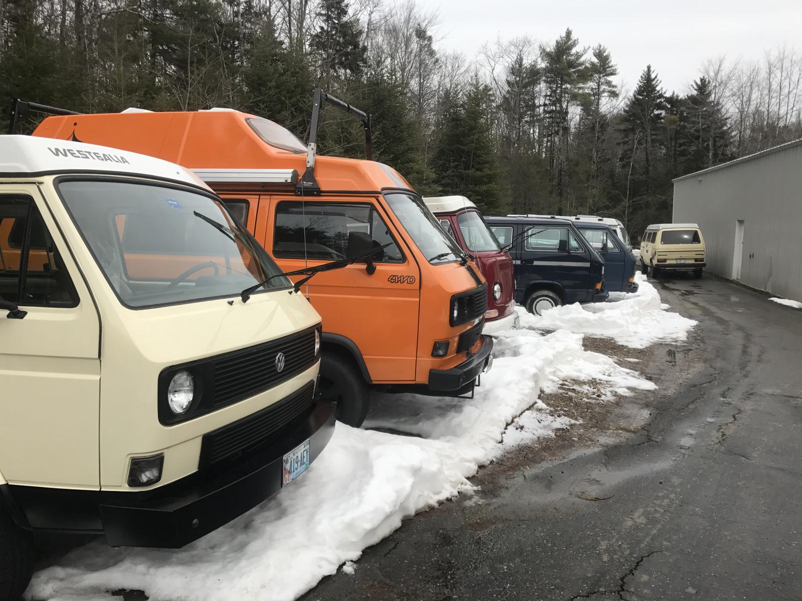

Here is a photo of our trip up to Harpswell, Maine to drop the van off to foreign Auto and Supply for the conversion. We stopped into Portsmouth NH for lunch. Very cool town, beautifully laid out and lots of old brick buildings. It was a smooth trip up but we drove back through a blizzard. I'm just glad that we didn't have to deal with whiteout conditions in the van. We had caravan'd up there with two cars and the Subaru once again proved awesome in the snow.
Photo taken as we dropped the van off to Foreign Auto and Supply. It was tough seeing our van frosted white with road salt from the journey north. My wife will attest, I actually shed a tear as we pulled away knowing I'd be without my mistress for what would eventually seem like an eternity. My sadness was tempered by the lineup of eye candy parked in and around FAS headquarters. Several completed projects and many in the works. The orange, syncro high top was pretty fun to check out. I love the high roof rack. I thought getting surfboards on and off my roof rack was a challenge!
Jon and Chris from FAS answered my many questions and were generous with their time. We left feeling good about the plan and knew that our beloved "Pippen" was in very good hands.

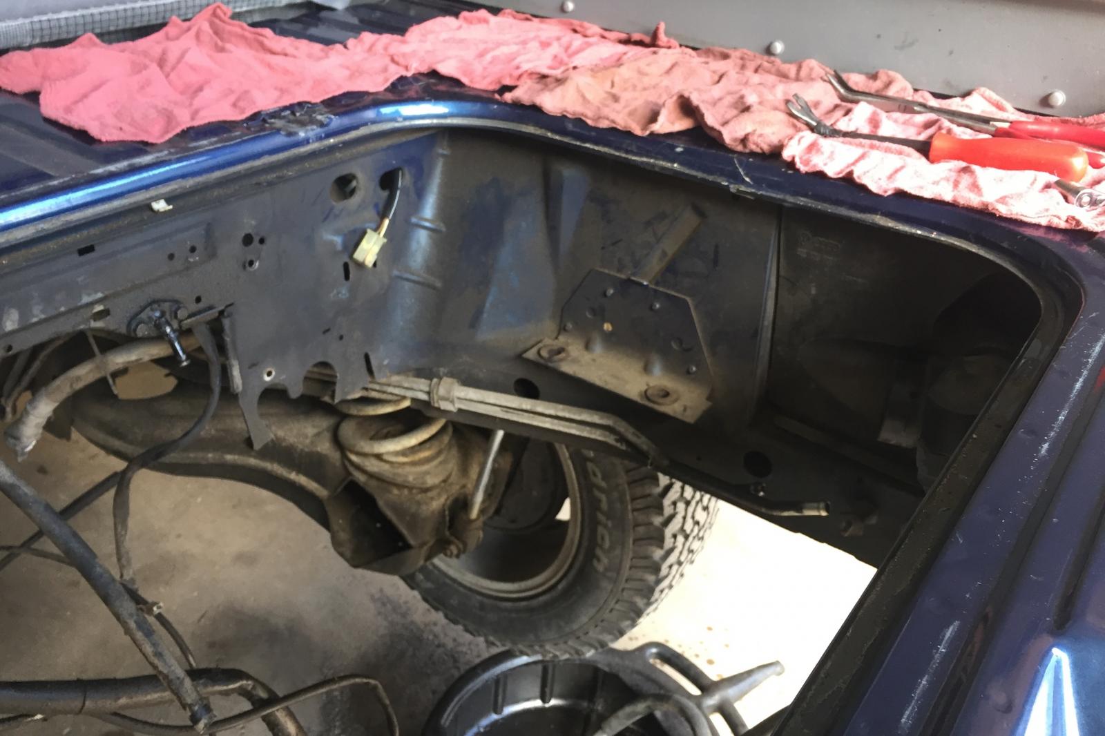

PostPosted: Sun May 21, 2017 9:50 pm    Post subject: Re: 1991 multivan tdi build Reply with quote
Engine bay stripped and ready for install. Notice the tools laid on top of rags. These guys at Foreign Auto and Supply are top notch and respectful of the vans that they work on. One of the first mechanics I tried using back home basically destroyed my vans rug by tracking grease onto the aisle area. Needless to say I never used them again. Laying down protection may seem like common sense but not many mechanics take the extra effort. It's a step I greatly appreciate.
