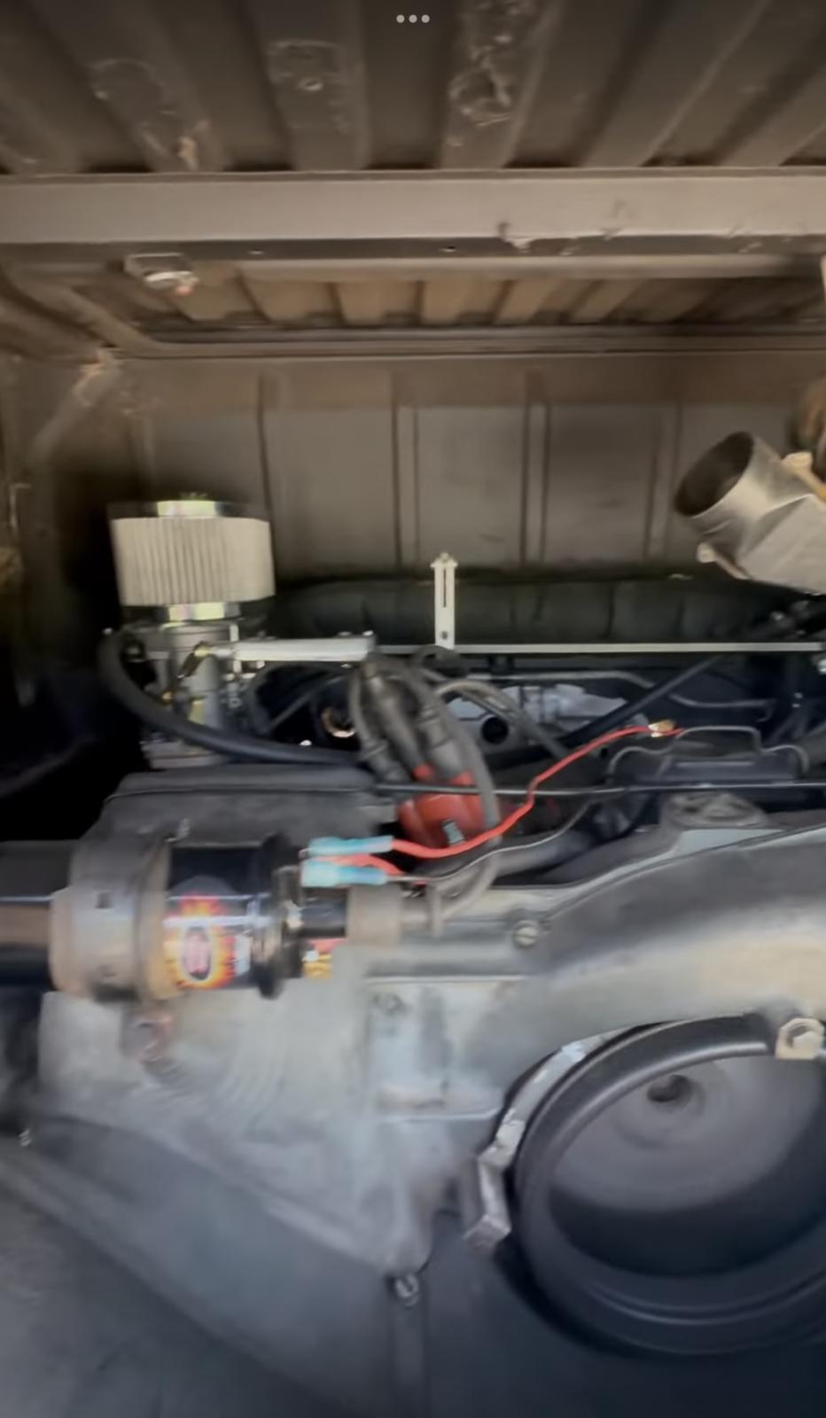

Hey guys,
I’ve been working on restoring my 1973 VW Type 2 Automatic (Bay Window) Microbus with the 2.0L Type 4 engine (engine appears to be an 1976) and 003 automatic transmission. I’ve made some solid progress, but I’m hitting a wall and would love your insight.
Original Setup:
• Old Dual carbs (previous owner had them installed)
• Old vacuum modulator for the transmission
• Speedometer and wiring had issues
• Engine idled poorly, died within seconds, shifted rough, and struggled on hills, lots of engine and transmission leaks.
Recent Changes/Upgrades:
• Installed new Redline Weber 40 IDF dual carburetor kit
• Replaced the alternator (upgraded to 75A)
• Replaced the transmission vacuum modulator
• Cleaned and reinstalled vacuum lines (including transmission line)
• Redid all engine and transmission seals and gaskets
• Installed brand new battery and verified voltage
• Speedometer was stripped — I fixed it with epoxy and it works great now
Current Symptoms:
• Idles much better than before — now lasts ~10 minutes before dying (used to die in seconds)
• Shifting is smoother but still a bit hard
• The big issue:
When accelerating past ~30mph, the engine starts popping (like a backfire), and really struggles to climb speed.
The faster I try to go, the worse it gets — sounds almost like it’s misfiring or running lean under load.
Here’s a video of what’s happening (acceleration sound):
[youtube]
https://youtube.com/shorts/PsoT0R2IfRA?si=FFNapGyXpHu72jO_
[/youtube]

PostPosted: Fri May 02, 2025 6:56 am    Post subject: Re: Engine Pops/Backfires at Higher Speeds After Major Tune-Up Reply with quote
I can tell you one thing, you need to fix the linkage install first and foremost.
That’s not even close to correct alignment
Post a picture of that…… Shocked

PostPosted: Fri May 02, 2025 1:28 pm    Post subject: Re: Engine Pops/Backfires at Higher Speeds After Major Tune-Up Reply with quote
This right here is crazy, pulling upside down, arms aren’t at the same level on the bar, linkage is not vertical………
How would you expect that to pull the carb’s evenly and stay balanced throughout the throttle travel?
