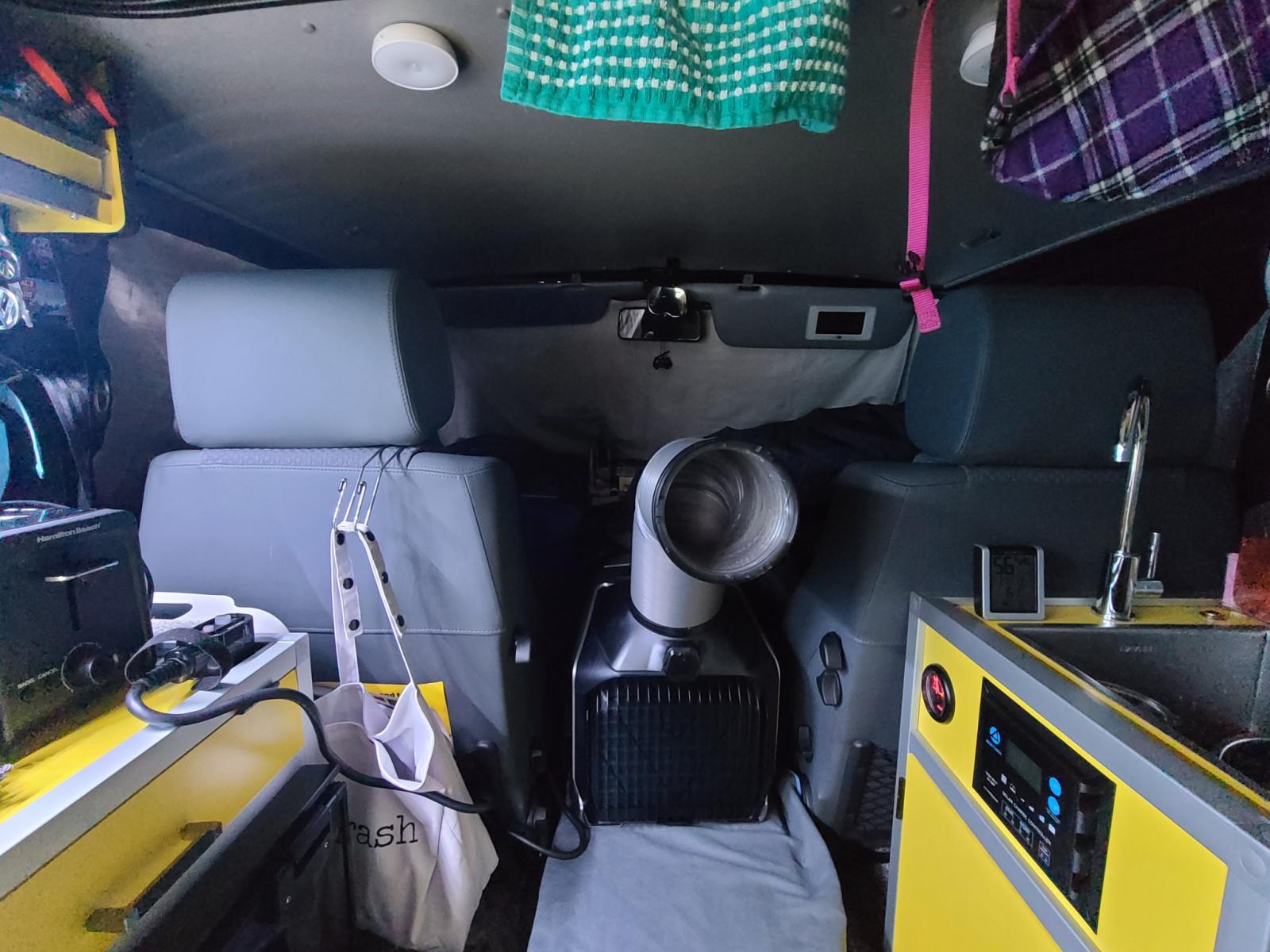

We purchased the EcoFlow Wave 2 last summer; used it on our 'round the country trip last October. Really nice little unit; definitely glad I purchased the bundle (unit & battery). I also purchased an extra set of venting tubes - the extra set are 8' long (vs. the 5' long tubes that come with the unit), which allowed us to use the unit while driving down the road. We used 3 tubes while driving - two venting in/out the window, one blowing cold air into the cab. Hanging curtains behind the front seats helped keep the cool air up front for sure.
We used it a couple of times for heat as well, but the primary reason we purchased it was to keep our doggie cool in the warmer temperatures. While driving, it was fine up to about 85 degrees, but when we hit 95 degrees in the afternoon in Arizona, the unit could not keep up sufficiently to keep our doggie cool. Hubby and I could have handled it just fine, but doggie not so much. Parked over night we turned the unit off once the camper cooled down - otherwise it just got too cold!
Overall we are very happy with the unit; no regrets. I can post pictures if you are interested.

Does it fit between the front seats?

Does it fit between the front seats?[/quote]
Fits perfectly. We built a bench seat for our doggie; EcoFlow sets on the bench seat just fine. Fits on the floor as well. Hubby built an insert for the front passenger window for the venting tubes when we are parked. We installed the insert that came with the unit on the side window to use while driving. Having a third tube allows us to direct the flow of air. While driving we extend the venting tube and hang it from the pop-top latch to have it point into the cab. We now have a smaller tray for the draining tube, but because of the internal draining system we haven't had any draining into the tray.

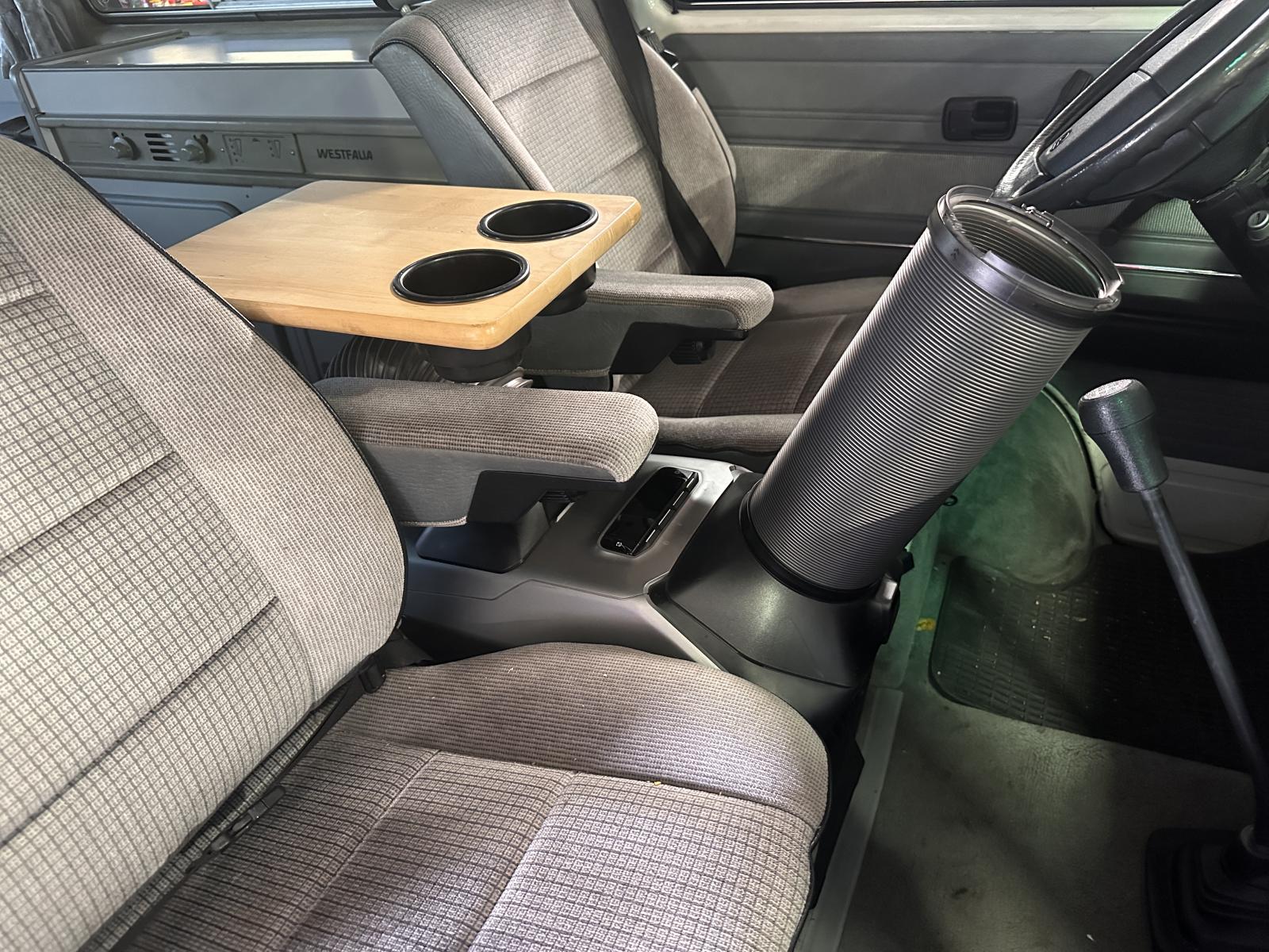

I've managed to grab a unit locally with the battery.
A quick test to see how it will fit in the van. I will definitely have to separate the front from the back while driving and insulate everything the best way possible.
