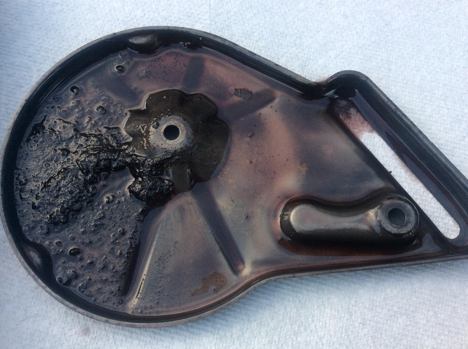

I noticed my van’s RPM higher than it should at cruise so I pulled over and had a look. The fluid was a bit low, but nothing abnormal. Reverse failed on me next so I limped it home and checked the linkages with again nothing was out to lunch. I then dropped the pan and filter and I noticed this. I’m sure it won’t be buffing out. Any thoughts?

Probably beyond ATF magic. There are a few threads where members have documented their DIY rebuilds. That with a Bentley you’d be good. Otherwise there are a few reputable rebuilders, but buy the entire transaxle, not just an automatic section and a torque converter. You might get away, but if there is a warranty claim, there could be a lot of finger pointing. Automatics are a pleasure to drive.

That's a lot of friction material off either the clutch packs or brake band. Either way you're looking at a rebuild. There may be a good bit of that material in other areas of the transmission, like the valve body. A good deep cleaning of internal components, inspection, and replacement parts.
It can be done at home if you have the space and want to learn. Djkeev and Kourt are some folks who have extensive threads here on the forum about rebuilding them.
You could also as MarkWard mentioned go with a rebuild company. You can either have yours rebuilt or buy one of their rebuilt units and send yours in as a core.

Ya, I found a significant deposit on the valve assembly. I better start sourcing some parts. MarkWard, how did you mean autos are a pleasure to drive? Thanks.
