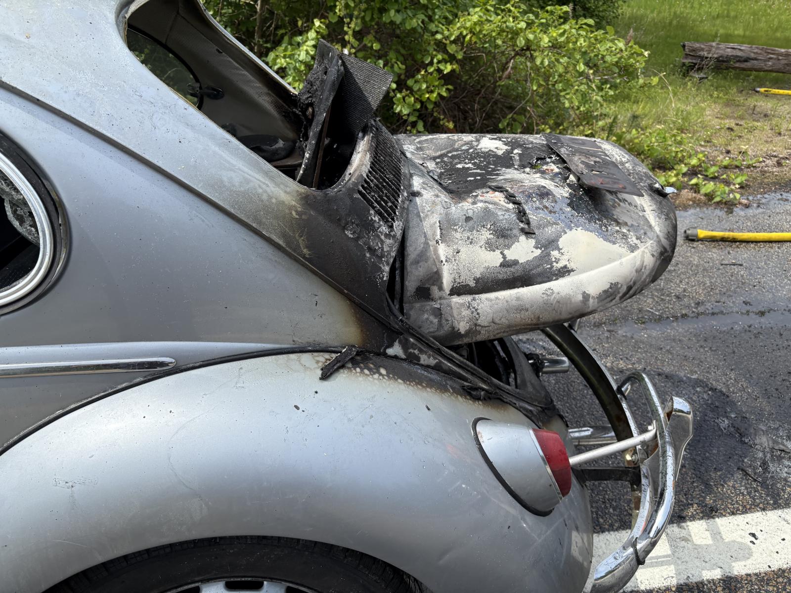

Now this happened today. So f'ing pissed! Lost a MOUNTAIN of money and countless hours I'll never get back. No coverage for this, so it's a loss. Not a total, but close.
Anyone want a '66 Beetle with a charred '68 1500? Evil or Very Mad

I suspect an electrical short ... but everything is fried to a cinder so I'll never know where.
About 500 miles ago it got a brand new Pertronix ignition system - entire distributor, coil, plugs, and wires. I spend a TON of time securing and wrapping wire. Very confident it wasn't my work. Shouldn't be after 35+ years of doing this stuff.
I have been fixing hack mechanic work since I got it, so I wouldn't be shocked if something shorted behind the fan, then started a chain reaction.
Wife emptied a little fire extinguisher on it, but it wasn't enough. She didn't know to try and yank the cables off the battery. If I were driving I probably could've saved it.

Man, that sucks. Wonder if one of those Solex carbs had a leak or an inlet disconnected, spewing fuel all over your hot running motor.

Looking at the post fire engine picture and where the fire appears to have been focused, I'd say a 90% or better chance this was caused by a failure of one of the two fuel hoses at the pump. This is a good reminder to everybody to check on the condition of their fuel lines.
Sorry for the bad luck, but on the bright side at least the magnesium case didn't ignite.

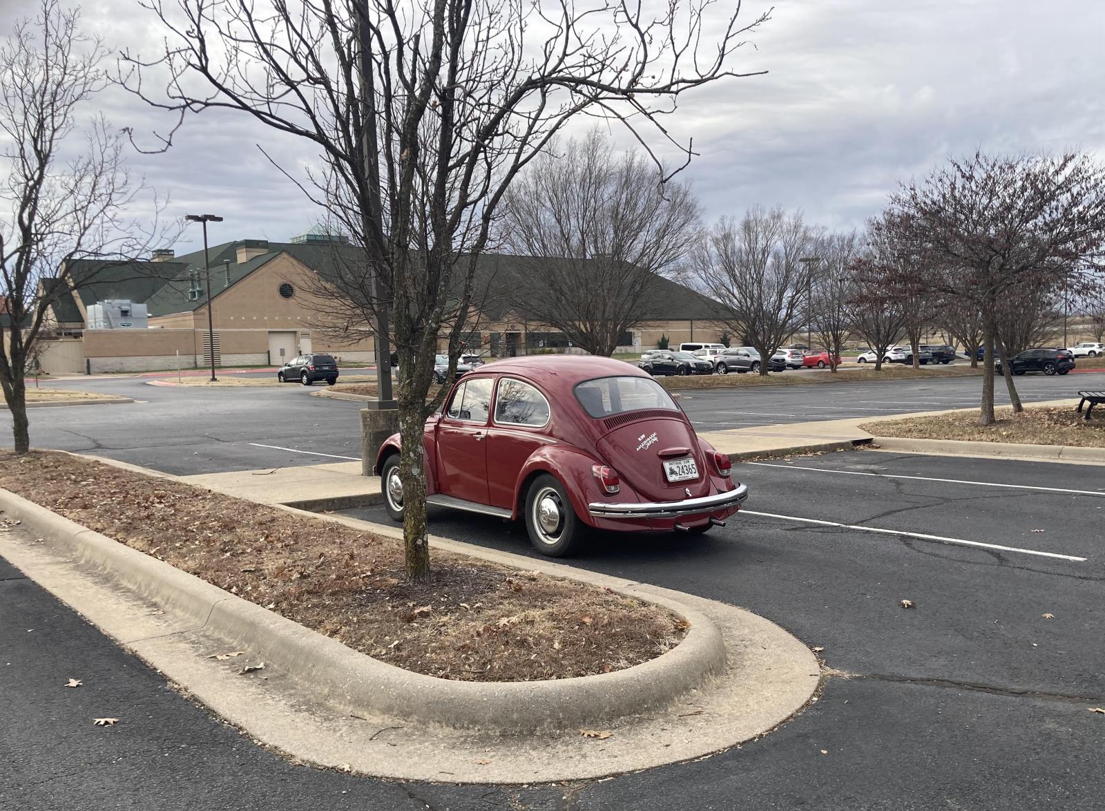

So I think I know exactly what happened now after I ran the leafblower over my driveway this afternoon to get all the glass cubes out of here. I noticed a line of drips. It had a minor oil leak out the crank seal, but this looks like gas to me.
Mystery solved. So pissed I didn't catch that!!! I didn't smell anything the night prior - I had just checked the oil 12 hours before this happened. Son of a bitch!!
Couldn't upload the pics here for some reason - says they're too large or corrupted ... but all the OTHER pics loaded no problem??? Aside from the state of MA, electronics / computers are the bane of my existence!! GEESH!!!!!
First pic is directly behind where my wife parked. Second is out in the road where she backed up, then proceeded down the road. Can clearly see what appears to me to be a fuel leak. Can see larger puddles where she got out to close the garage door that the remote is failing on.

Looking at the pictures the fuel hose to and from the fuel pump could have failed. That braided garbage always leaks. Sorry this happened to you.

Yeah that's the conclusion I came to - that cloth covering hid what would normally catch my eye - dry rotted / cracking rubber, which I would have replaced immediately.
