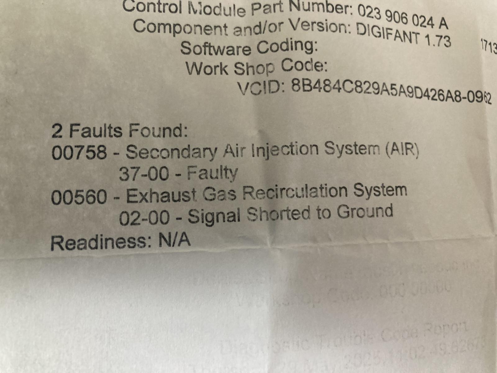

Chasing a Check engine light and discovered that the secondary air injection pump is full of rust and locked up. I soaked it in PB Blaster,.....no help. I spent about an hour doing various searches,....and not finding any. It's a Pierburg 023 959 253 air injection pump. I did grab a pump from a 2001 EVC from forum member Kourt but it is completely different and the part number is not remotely close. Wondering if anyone has made one of the VR6-24 pumps work on a 95 EVC 2.5 L5
I have heard of various Secondary air injection system delete kits,.....wondering if there is such a thing available for the 95 2.5L in the EVC or is anyone has a lead on a known good secondary air pump.. Also wondering if the van can be driven with this pump and related solenoid and hoses removed?
Pics show my most recent Check engine codes, and the pic of the pumps shows mine on the left and the VR6 pump on the right.

What I would do here is build a block plate that is the same footprint as the combi valve. You could build that out of aluminum bar stock from Home Depot.
Take off the combi valve, disassemble the upper parts that are not needed, and reinstall it with the combi valve bolted over (sandwiching) the aluminum block plate you fabricated. That takes care of the exhaust side.
Find the various vacuum lines serving the solenoid attached to the air pump and reroute/eliminate them. Remove the air pump and associated hoses.
You will then get a check engine light. Do what you want with that. Some places on the internet will mod your ECU to remove the CEL.

These systems work by pumping extra air into the exhaust upstream of the rear OXS to burn excess fuel during cold start. They only operate for the first minute or so of cold engine running. When the ECu commands the SAS on, it looks at the voltage across the rearOXS pins for an excess O2 condition. You can put a diode across those pins to simulate the voltage drop and prevent the CEL
Info needed, locate the right pins monitoring OXS voltage
