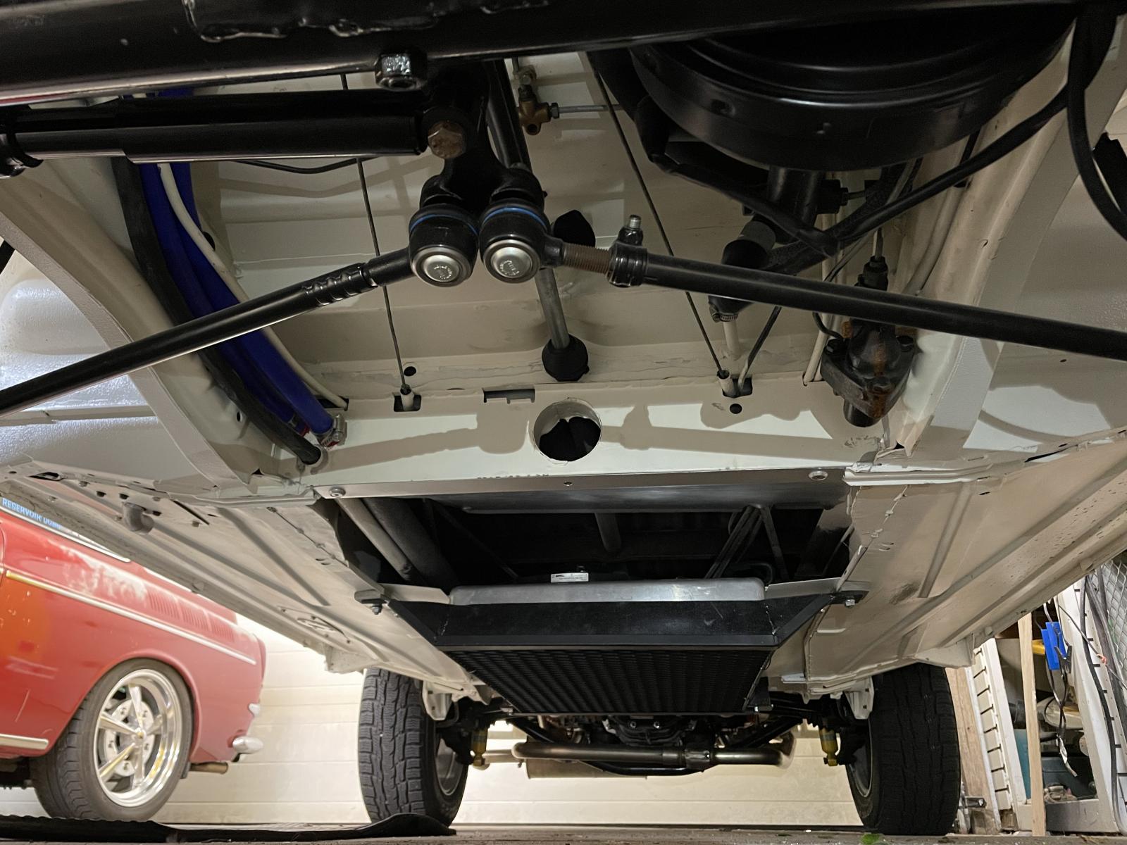

i went with the system that VDubnut uses, afco radiator with the outlets moved, and two 13" Spal vans. Have a look at the radiator system from the modern bay co too
- Exhaust system from Van Cafe or Small Car Performance : KEP
I didn't care for the exhaust systems that cross over behind the engine twice and generate a lot of heat on the timing belt & housing.

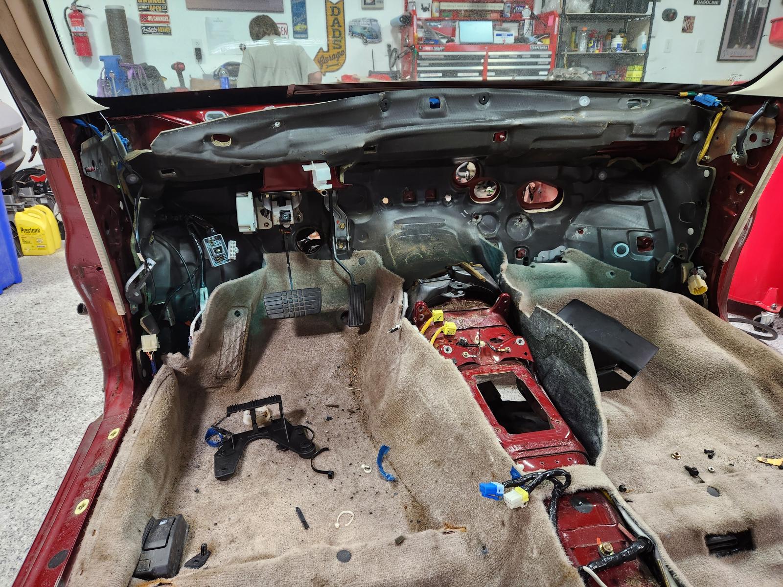

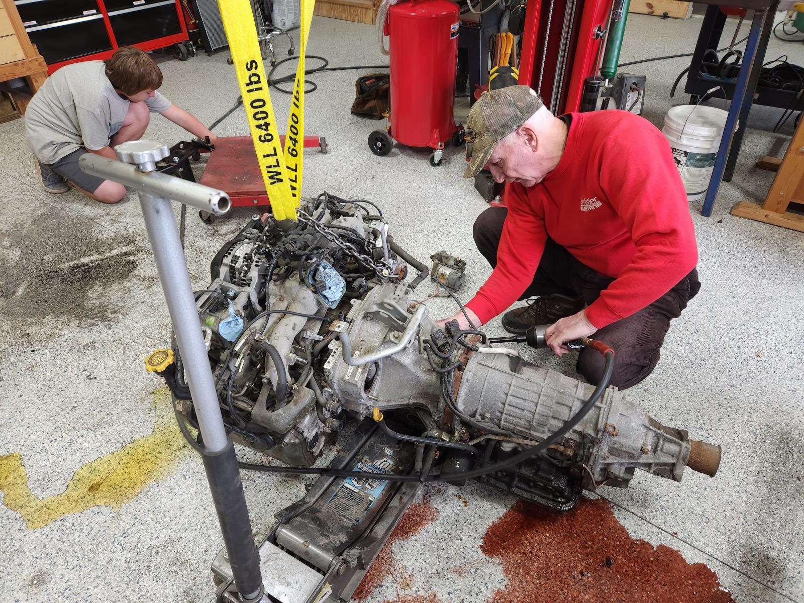

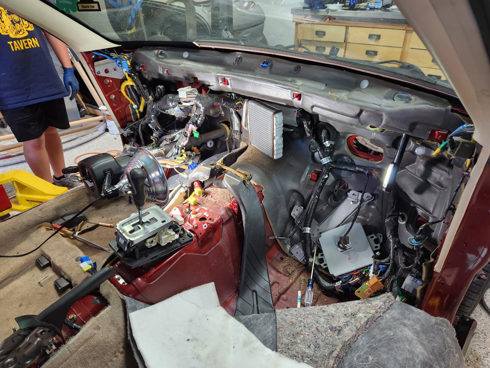

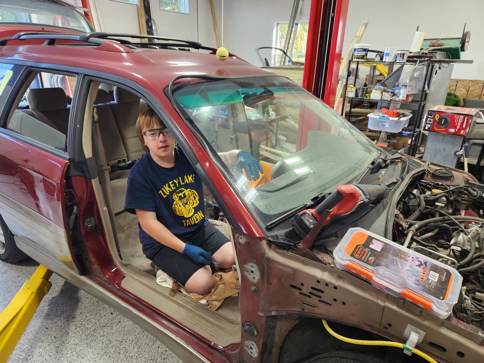

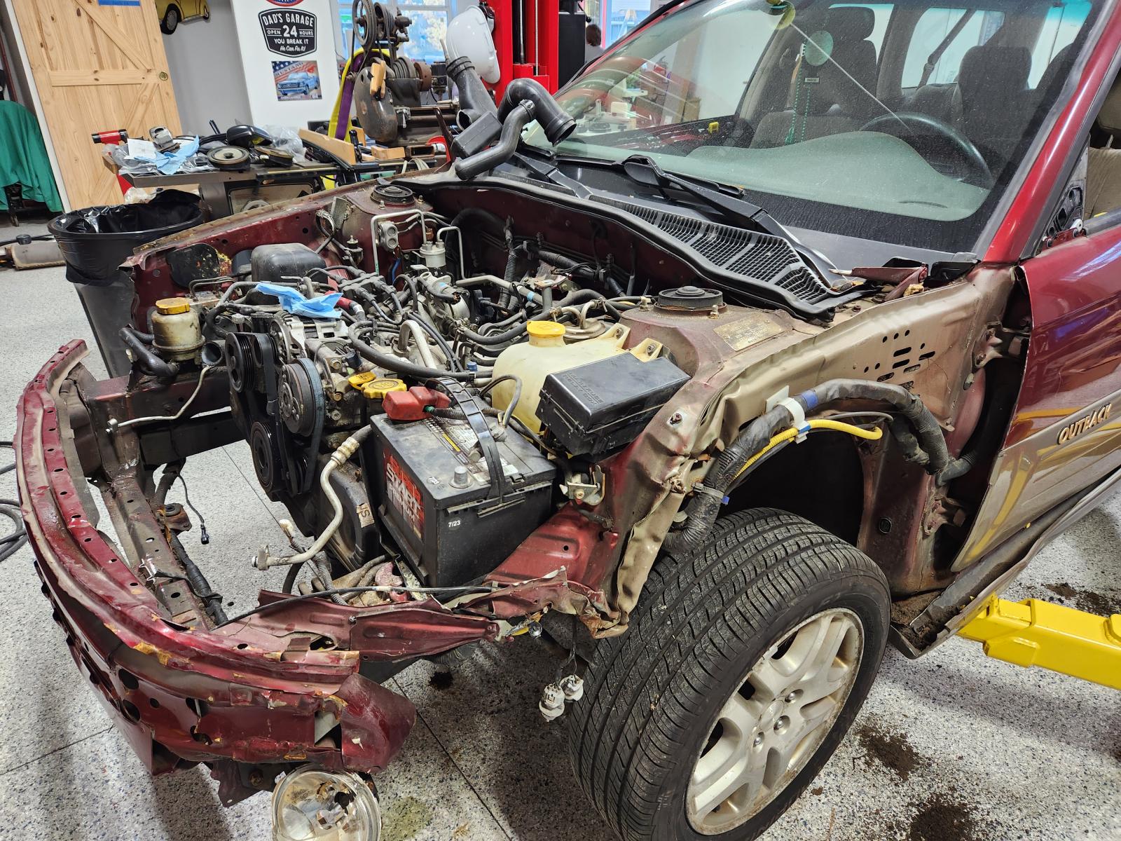

I took the first big step this past weekend and purchased my donor car. It's a wrecked 2002 Subaru Outback wagon. 2.5L, auto trans, 107,000 miles.
I'll start harvesting parts in a couple of weeks. Besides the engine, trans, wire harness & relays, and the ECM, what else do I need to grab?

there's no way I'd use a custom radiator underneath a bus.
a vanagon radiator already has both outlets pointing to the 'rear'
a thermostat boss
and has a 10mm threaded bleeder boss in the top.
the plus is that if you hit debris that compromises the radiator a new one can be ordered in 1 to 3 days.
add in that they'll easily provide ample cooling for 165hp. even with limited airflow.
but it's not the 'popular' cu$tom shiney jobbie that's pushed around here.

I don’t think anyone is “pushing” the Afco radiator, it fits between the rails, and when modified, doesn’t need holes in the frame to run hoses to the rear. It’s a really nice idea
The vanagon radiator is a different option, but not ideal outlets
But I will take this option:
Yes it does have protection from road debris
Over this , any day

After searching through Facebook marketplace, I was able to find a wrecked 2002 Subaru Outback with a 2.5L engine and only 107K miles. Only $550 and it ran and was drivable!
My 13-year-old grandson is a budding mechanic. I’ve taught him how to repair his and his brother’s bicycles, as well as helping me with various car repairs. He recently got a Craftsman socket and ratchet set and was dying to use it. So, I put him to work taking out the dash and removing the wiring harnesses from the donor car. The boy next door, about the same age, came over to help.
Between the two of them they managed to remove both doors, take out the seats, remove the console, shifter, and parking brake. They then pulled out the top of the dash, the instrument cluster, the steering wheel and column. Nothing got broken! Then they began the process of removing the wiring harnesses.
They quickly learned how frustrating it can be to get electrical connectors apart. After a little coaching, they learned how valuable a small screwdriver is in unlocking connectors! After this, they plowed through it all and had the harness out and on the ground in 4 - 5 hours (see pics). I was very proud of them.
The following weekend we began engine removal. With a little help from me, the boys removed the hood, grill and fenders. I cut out the radiator core support and then removed the bumper support. The boys continued to systematically remove & disconnect parts that went to the engine from the rest of the car. After a few hours we were ready to pull the engine. My neighbor (and former Roush Racing crew chief) stopped by to see what we were up to - perfect timing! With his help we had the engine and trans out, split the trans from the engine, and had the engine mounted to the engine stand.
So that’s where things stand right now. The scrap yard is coming tomorrow to pick up the remains of the Subaru Outback donor car. I plan on putting a new short block in the Subaru engine. I need to put my parts list together and order my parts – only genuine Subaru OEM parts. Short block, Water Pump, Oil Pump, Timing Belt Kit, Engine Gasket and Seal Kit, Head Bolts and a Thermostat. What else should I be ordering?
Next up is engine teardown, cleaning, priming and painting and sending the heads out for rebuilding. More to come.
