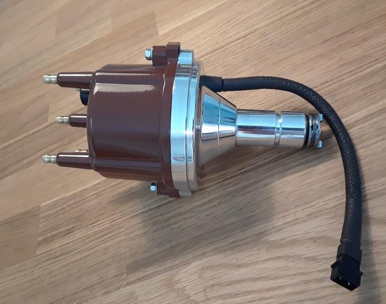

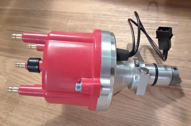

So I ordered one of these Procomp/Speedmanster MSD copies from Speedmaster on ebay. Turns out, they sold me a bin#3 turd. 1 of the reluctors was longer then the others, so the air gap could not be adjusted. Also, the mag pickup could not sit straight. Sent it back, refunded.
Ordered from a better supplier of the same product, was $20 more, got a bin#2 decent workable distributor. $62+shipping.
The only thing I don't care for, is the solid (non-floating) distributor drive dog. Being solid it will work, but it will take a toll on things.
Bearing on one side, bushing on the other, and they are a perfect fit. Cleaned, regreased, installed a Bosch drive dog with shims, adjusted airgap, polished up a little, painted the toys r us red cap brown, added some old school wire sheath and ready to test.

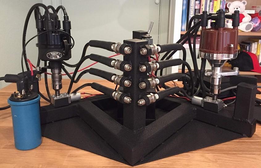

Just to see a comparison for fun, (and for my 7 year old to understand how things work) I made up this demo setup that holds 2 distributors side by side, 2 electric motors with old distributor drives cut in half, some old gate metal and a few wires/paint/plugs and its ready to go.
I wanted complete plugs/wires, with plugs as close as possible to see differences between different coils/cdi/distributors.
On the left, Bosch with points, non resister rotor, copper terminals, bosch blue coil.
On the right, the MSD Copy, Crane Hi6N, LX92. Not randomly picked. That combo packs more punch then most, and all for less then $300.
Now getting a Photo of 2 spark plugs from opposing distributors firing at the exact same time is not easy, but here is a nice shot:
If you ever wanted to see 2 complete VW ignitions firing their own 4 plugs each both at the same time, and right next to eachother, see it here:
https://youtu.be/TZacsT7d8qY
Tested under normal light, then moved to a slightly darker area to show the spark better. Also, at the end notice the huge difference in what kind of spark is jumping the coil wire gap.

I do not agree with the advance system of this distributor.
Two different springs are used, but they act on the same distance, so they are unuseful.
The correct arrangement is when one of the springs has a longer hook, so its force is applied only at higher rpms.
Springs in the distributor in the photo instead have the same hook, so they start their counter-force at the same time... as if they where a single spring.
If you dismantle a good Bosch unit you will find one of the spring with a "U" shaped hook with the result that the advance curve has 2 different slopes, giving a better approximation of an advance parabolic "curve".

BTW.. nice display.

Very interesting and quite a unique test stand, great job as always!
When you have a chance, can you comment on how much scatter a single terminal has when you rev the engine up? Also, how many degrees difference does each cylinder vary between each other. I typically find two or three degrees between the cylinders is common on these type of pickups, I have tried to bend the ears on the reluctor wheel with no success because they end up breaking. The one I have seems to be made of a sintered metal.

raygreenwood wrote:
This is normal. Virtually all fuel injected type 3 and 4 Bosch distributors from the factory have asymmetrical springs on otherwise symmetrical weights.
Its designed this way so that advance kicks in in two stages. Ray
Don´t know with that thing above, but a Mallory or Pertronix do the same, only both springs get active much sooner due to the size and weight of the distributor head.
