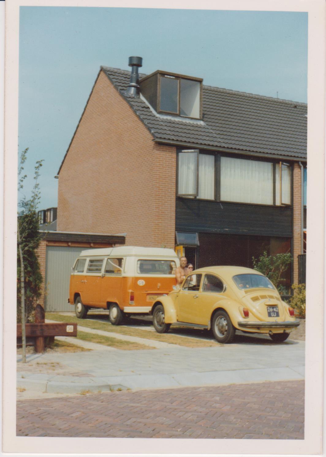

Here are some pictures of my 1973 VW 1600 Type 2 Westfalia Continental motor-caravan, with original Brilliant Orange and Pastel White paintwork.
Regards.
Nigel A. Skeet
https://vwt2oc.co.uk

i think the op wants to know how far the bottom colour extends into the interior at the door jams,are the jams painted with the exterior colour,where to draw the line between colours at the jams.

To the first bend, say 1/2". Factory was not always a straight line, depends on whether it was taped before or after the beer lunch.

From what I recall, the orange paint extends as far inside the door & hatch apertures as limits of the panel joints or to where the rubber-mouldings make a seal.
