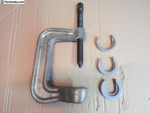

There used to be a guy on here making a bus steering wheel puller, but I can't find the ad; maybe he quit. I bought one even though I didn't need it at the time, but I'm glad I did. (buy a plunger before you need a plunger)
This one is in the classifieds right now
https://www.thesamba.com/vw/classifieds/detail.php?id=2398104

Here's the old ad - this was a screaming deal https://www.thesamba.com/vw/classifieds/detail.php?id=478847

The trick is supporting the flange under the steering wheel hub. The turn signal switch will have to be loosened and slid down first. There is always risk of cracking the wheel bakelite. On reassembly, I put a little anti-seize on the splines, but fully tighten the nut. I still sweat breaking it!

I did see the one for sale - price was high, but mainly shipping time was an issue. And HF is a crapshoot; for every tool that is a great deal, 10 are going to break and ossibly hurt car or you. YMMV, but that's my experience. For 60 I may get that combo and see if it works or looks as likely to crack plastic as hitting the wrench!

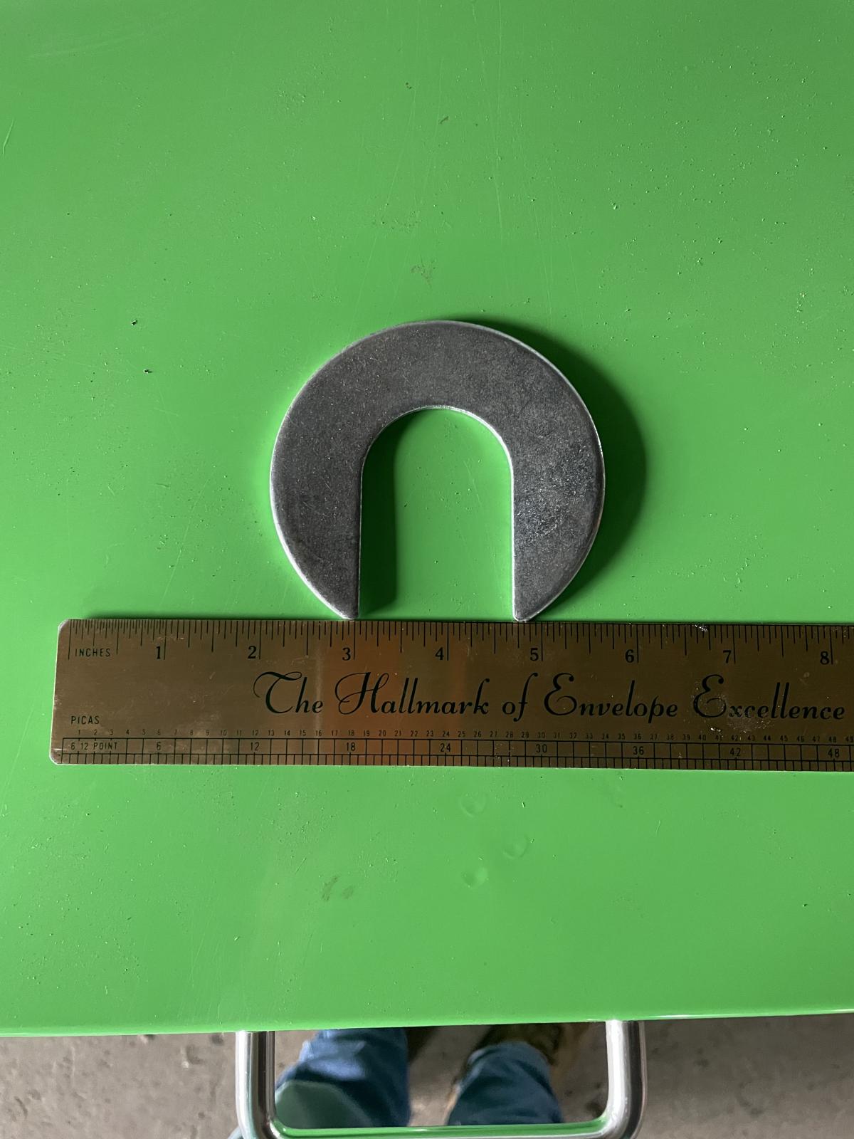

I bought two large 3 1/2 washes and cut each one the width of the steering post, slide them on, rotated them so the slots did not match up and then used a standard gear puller. So instead of yanking on the wheel, the gear puller pulls on the washers and off she comes. Cheap easy and no damage.
Like this...
https://www.thesamba.com/vw/forum/viewtopic.php?t=310527

My local hardware stores failed me on the big washers, but that is the right solution if you can find them! That's how I ended up at HF.
I have an Ace hardware in my downtown, they are great for this plus plenty of metric nuts, bolts...
