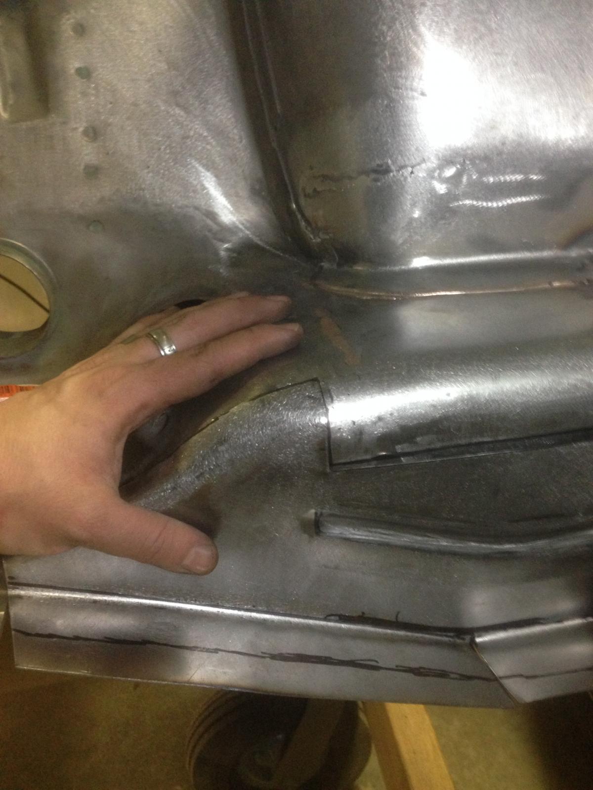

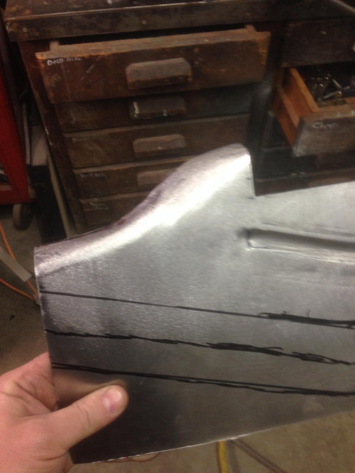

PostPosted: Thu Jun 12, 2025 5:08 pm    Post subject: Re: Type 3 fastback rear arches Reply with quote
You can try to find a rust free car to get them, or if that’s not an option, do what I did and buy a cheap planishing hammer, bead roller and shrinker/stretcher and make your own. I had no previous metal working experience and to be honest it wasn’t as hard as I thought it was going to be.

PostPosted: Fri Jun 13, 2025 2:08 pm    Post subject: Re: Type 3 fastback rear arches Reply with quote
Very nice work Jason. That's kind of what I was trying to tell the OP, but you don't have to get it that nice, as most of it is hidden.
