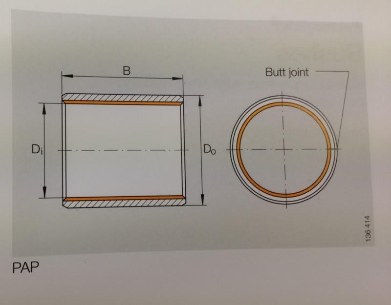

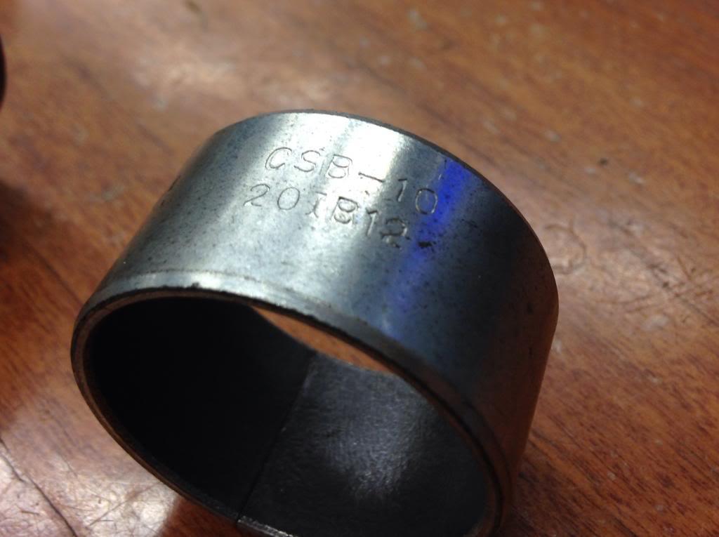

INA brand Permaglide (TM) plain bearing commonly available at CBC bearings in Australia. I'm sure someone does these bearings in US or Europe.
code
PAP 3230 P10
They have 1mm smaller than stock inner diameter (32mm actual) and Same Outside diameter as stock lower bushes (36mm actual).
Also they are same inner diameter as top bushes and most likely larger OD than the top bushes. (Something to bear in mind if you need to replace those). I would probably send it to a machinist to turn down the top inner bush OD to suit the bakelite bush ID if I were doing the top beam. Lucky for me I did not need to do it. My top beam bushes, like most peoples, was fine!

I was able to find some steel backed PTFE/bronze sleeves that are 33mm x 37mm x 30mm for the bottom arms. I could use this and just ream out the bakelite bushing inside. Looks to be the cheapest option. You think the original bakelite can be reamed without breaking? I guess if it does, then I could have some delrin rings made to replace it. Now to make the tool to remove the damaged sleeve.

have a look at these as well.
The SY series bearing sound ideal.
http://www.bsc.com.au/sites/default/files/products/manuals/Plain%20Bearings%20and%20Rod%20Ends.pdf
