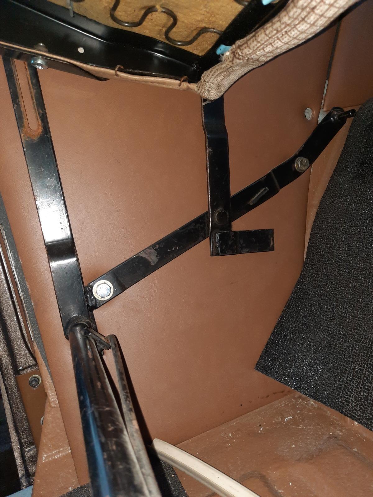

PostPosted: Tue Jul 08, 2025 10:09 am    Post subject: Re: Looking for Pics of how a Weekender Bed mounts to the Van Reply with quote
Please take this advice: Remove the seat back and bench before attempting to install it. If you remove the seat back and bench, you will be able to easily place it in the van and see how the frame lines up to the bolt holes in the body.
Install the folding frame. Make sure it folds in and out smoothly. Then mount the seat back and bench.
Failure to follow this advice will lead you to scratch your interior panels, sweat profusely, curse a lot, and potentially pull your back.

PostPosted: Tue Jul 08, 2025 2:46 pm    Post subject: Re: Looking for Pics of how a Weekender Bed mounts to the Van Reply with quote
I always thought that was called a Z-bed. My '86 Tin top has one. Hope these can help. And definitely take 4gears4tires advice.
